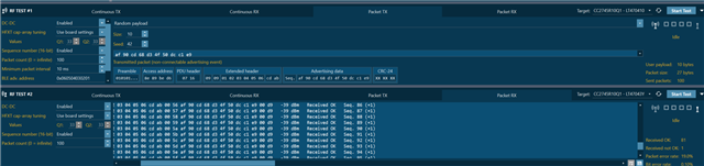

    If the customer wants to capture the average RSSI over a specific channel then they would use the Continuous RX mode (1 LP).  If the customer desires to capture RSSI from a specific Packet TX device then they would use Packet RX mode (2 LP).  In either mode, results can be saved to a CSV or text file for further processing.  There is documentation inside of the Smart RF Studio 8 Help tab -> User's Guide.  If the customer is still not satisfied then please have them provide specific details as to what they desire to achieve.

    I have tried this test myself and I am seeing very bad RSSI values.
    For option 1:
    My steps after selecting the LP I was using were the following -> continuous RX (no modifications, should I enable modifications?, what do the Q1 and Q2 values mean?) then selected "start test" and see RSSI consistently below 0 avg around -80ish.
    For option 2:
    Test #1, packet TX, no modifications (should I make modifications?) -> start test
    Test #2, packet RX, no modifications, (should I make modifications?) -> start test
    I assume the dBm value displayed (-39 dBm) is RSSI?? can you confirm?
    I have the following questions:
    - For the x2 LP test, how do I know which test is running on which LP? I cannot find an option to select a COM port or anything of that sort to indicate which board is on which side...
    - Do I need to connect an antenna to the LP?
    - Do you have any recommendation on how to improve the RSSI value?
    - What modifications should I make to the test setup for either test 1 or test 2?

  • RSSI Measurement Guide.docx
    Inserting this for anyone who finds this thread and needs the guide.
