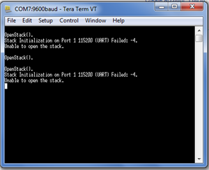

errors initializing HFP on MSP-EXP430F5438 + PAN1323ETU -- (Stack Initialization on Port 1 115200 (UART) Failed: -4.)
I am trying HFP demo on the MSP-EXP430F5438 +  PAN1323ETU boards. I have followed all instructions according to this and the code compiles/ports fine onto the boards. When I reset the MSP-EXP430F5438 I see the following error on Tera Term.
When I press the reset button I first receive the error above, then the red and yellow LED start flashing. Also my display does not show the help menu (mentioned here). The example SLAC227 software complies and runs fine, so MSP-EXP430F5438 hardware should be ok.

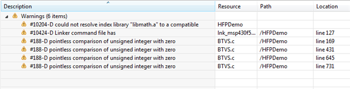

I am using CCS Version: 6.0.1.00040 and receive the following warnings:

    I think you have selected the wrong Build Configuration, right click on the profile-> Build Configurations -> Set Active -> "Debug - MSP430F5438A Exp"

    I have tried it myself again and I did not face any problem with the same set up (MSP-EXP430F5438 + PAN1323ETU, with bluetopia version 1.5 R2).
    and related to the compiler version issue, have you checked the last replay I have posted? with the latest compiler also I was able to make it work.
    and yes the patch is not include by default.
    If you have done a clean build after changing the compilers then it should not matter. As I was able to bring up the board with both old and new compiler.
    And I have forcefully downloaded the wrong Build Configurations. profile-> Build Configurations -> Set Active -> "Debug - ez430", and I was able to see the red and yellow LED start flashing. As you are sure that this is not the issue you are facing, Make sure that the boot-up sequence is fine as mentioned below.
    From what you provided, I can say that the service pack download has failed with error Error -4 which is defined as BTPS_ERROR_HCI_INITIALIZATION_ERROR (in BTErrors.h), which means that you UART is not configured correctly.
    make sure first three steps mentioned here processors.wiki.ti.com/.../CC256x_Testing_Guide are followed.

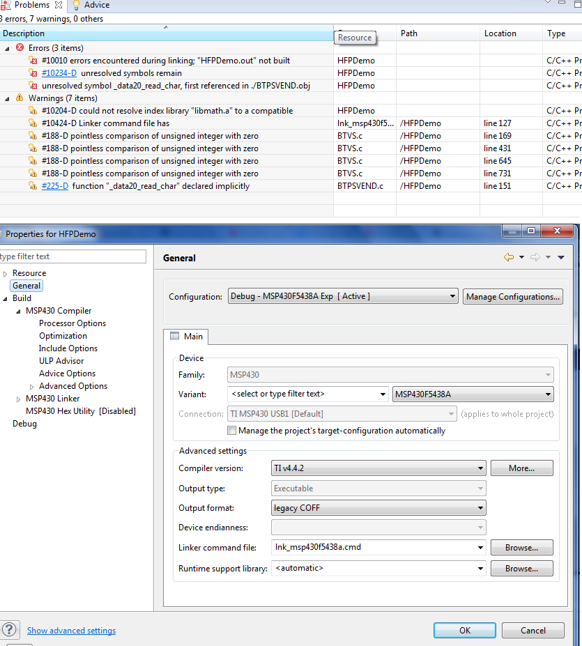

    I double checked all the things you mentioned above but I still get the same error. I haven't had a chance to check the first three steps of "CC256x_Testing_Guide". I also updated my compiler to the V4.4.2 version and have not been successful in posting the code due to the following error (I have attached the log files for your reference):
    I have a question: under the "hardware setup" section of "CC256x MSP430 TI's Bluetooth Stack Basic Demo APPS" wiki, part b says "Place the included jumper block on RF3 connector". I cannot clearly  identify from the image if there is a jumper board solder on top of RF3 connector or if its just the connector. I did not receive a jumper board in my evaluation package so I assume all of this is not due to a missing jumper block ?

    You have not changed _data20_read_char to" ___data20_read_char" as mentioned in the other E2E (http://e2e.ti.com/support/wireless_connectivity/f/660/t/394430).

    After changing  _data20_read_char to __data20_read_char everything ported fine with the latest compiler (V4.4.2). I still do get the same error though.

    That is strange have you done a clean, as we have change it you should not be getting the same error "undefined symbol _data20_read_char" as this does not exists anywhere.
    As I suspected the module was changed, PAN1326 is a CC2564B device, Please do enable the CC256xB patch (#define __SUPPORT_CC256XB_PATCH__)
  • Hi Sundeep,
    I think there was a miscommunication. Changing to "__data20_read_char" did take care of the "undefined symbol _data20_read_char" error. Also after soldering the pins of RF3 according to processors.wiki.ti.com/.../CC256X_MSP:EXP430F5438, and applying the CC256xB patch everything is working.
