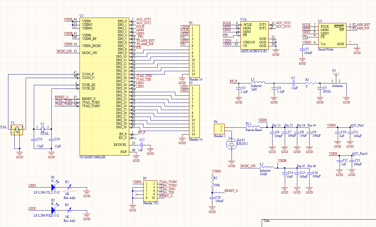

I am using the CC-DEVPACK-DEBUG with 7x7mm CC2640 on a custom board. The pcb is milled and hand soldered so HW could be an issue but Ref designs were followed exactly. I have checked that all the correct pins are connecting to the debugger. I was getting the following error when test target connection:

I then raised the supply voltage from 3V (CR2032) to 3.3V. I'm not sure how that made a difference but I am getting this error now.

It may not be hardware but if it is, what voltages should I be getting at the pins before and after connecting the debugger on a chip that has never been programmed before?
