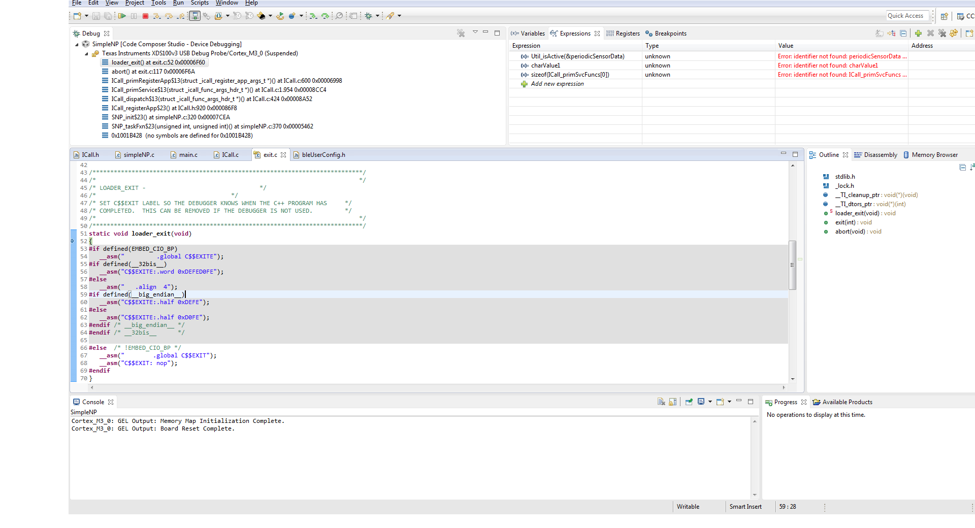

  • Hi .,
    I have flashed the SNP stack and SNP to cc2650 ,
    Currently I am facing issue in SNP.,While debgging the SNP goes to static void loader_exit(void) function during the initialization of
     ICall_registerApp(&snp_selfEntity, &sem); . ,
    Find the attached screen shot .,
  • Hi.,
    Could you please provide some solution, Currently this is blocker for my project.,

  • You cannot use a custom configuration in this case. I was just suggesting to try it out as a sanity check to ensure the hardware is working properly. Do you have one of our evaluation modules?
  • In any case, the crash you are seeing is likely due to a driver configuration issue. Would you mind posting your project settings?
    Lastly, what package are you using (7x7, 5x5,etc)?
  • Hi .,
    No issues but can you please tell exactly which I should share (.cproject or .... ), I am using 7x7 package.,
    And I am using Spi ..
    Please post your compiler defines to start out with.

  • Hi Sean.,
    While debugging I found the problem comes from the following api. ICALL_HOOK_ABORT_FUNC();,
    static ICall_Errno ICall_primRegisterApp(ICall_RegisterAppArgs *args)
      size_t i;

    Thanks for the information. I should have clarified what I was looking for: please post the defines found under project properties->predefined symbols in CCS.
  • Hi Sean.,
    Is it related to IDE ?
    Instead of CCS if I use IAR will resolve ?
  • Hi Nagarajan,
    No this project is built (and tested) to be compatible with both IAR and CCS. There is likely something that is being configured incorrectly. Please post the symbols that I mentioned in the last post.
    Please also explain exactly what you have modified from the stack settings within the SDK.
