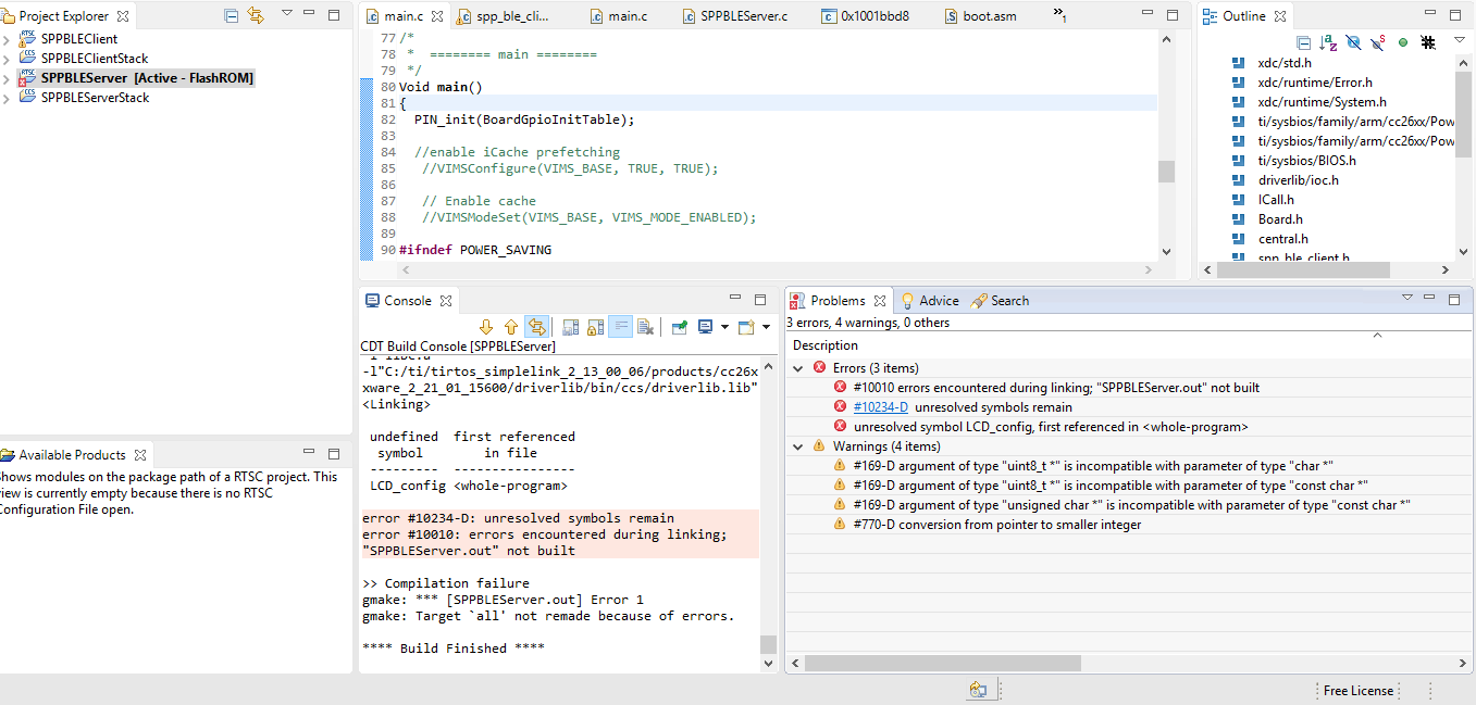

unresolved symbol LCD_config, first referenced in <whole-program>
Other Parts Discussed in Thread: CC2650, CC2640
hi
I have downloadded a software patch which includes SPPBLEServer project . After making changes in the neccessary files , when i try run the code it shows this error during Linking. I can't fix this error. please help. I am usig SmarrtRF06 EB, and CC2650EM 71-D

    I could resolve that issue. but a new error came when i am trying to load my code into the board.

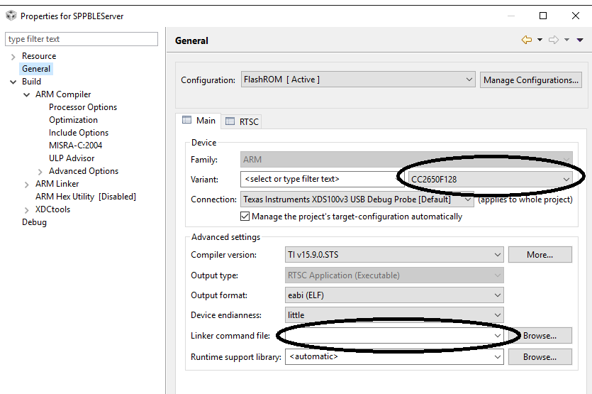

    There are some other issues too. when i changed target device to CC2650 in project properties it shows some building errors like “ FLASH memory range has already been specified”, “FLASH memory range overlaps existing memory range FLASH” , “SRAM memory range overlaps existing memory range SRAM” .
  • what if you just set it to CC2640?
    Also it would be really helpful if you can post what have you changed so that I can try to reproduce the error.
  • hi,
    When i changed variant from CC2640 to CC2650 it shows Some memory overlap errors (FLASH & SRAM). when i remove Linker command file it builds successefully. Is there any problem in doing so?

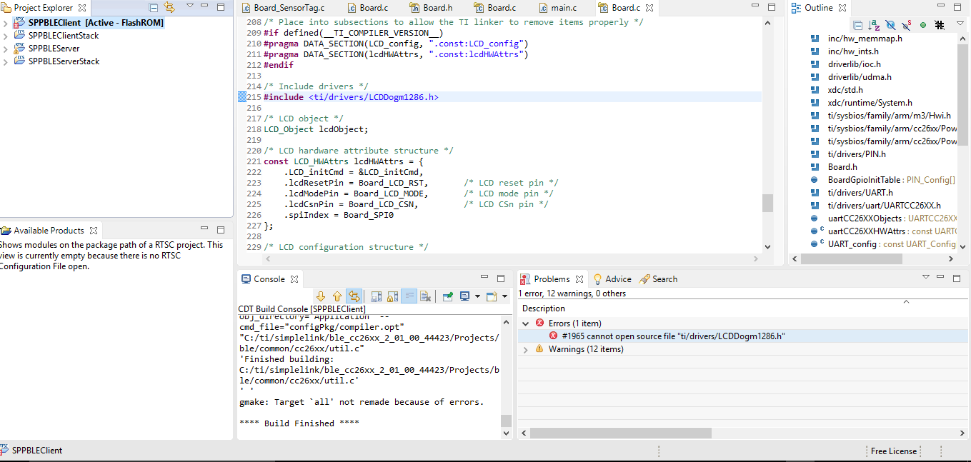

     When i build and try to lad the SPPBLEClient program , this is what i gets
    I found a link  e2e.ti.com/.../452476 , and tried all possibilities as given. but i got an error like this. i dont know why
    The file is there under LCD

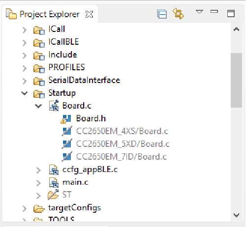

    But Board.h is not included under Board.c.. Is that the problem? if so how could i resolve it?
  • Pasted Board.h file @ “C:\ti\tirtos_simplelink_2_13_00_06\packages\ti\boards\SRF06EB” Now Board.h file is detected under Board.c, but the fatal error exist
  • The issue has been resolved by changeing include path to "ti/drivers/lcd/LCDDogm1286.h”. Now i could load the program successfully to board
  • The issue has been resolved by changeing include path to "ti/drivers/lcd/LCDDogm1286.h”. Now i could load the program successfully to board.

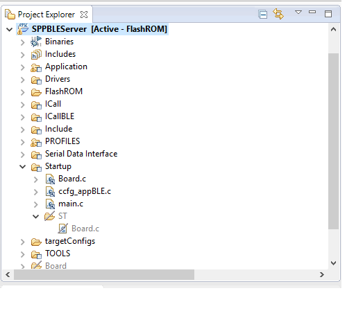

  • i could clear the error by removing sensor tag files under startup folder . But still no output on LCD.
  • Since I am using CC2650 EM 71D Ithink i dont need that sensor tag file. When i debugg te code by setting break point, i can see that after SPPBLEServer_taskFxn creation it does not switch to that task. hangs somewhere

  •  Did you modify anything other than board files? I have no problem using this project and it's already running on my rf06 board.
    When you open that project, there are 2 board files included into the project, just exclude Board_SensorTag.c from the project and use Board.c(do your board modification there), don't touch Board_SensorTag.c
  • i have done this earlier , deleted my sensor tag board file. i have chenged pin mapping in Board.h file of my EM. but not working
  • But according to what you posted, you were modifying the board.h file for sensortag, not for RF06 board.
    The board.h file is locating in
    C:\ti\tirtos_simplelink_2_13_00_06\packages\ti\boards\SRF06EB\CC2650EM_7ID\Board.h
    Sorry for the mistake. I have modified the board.h file lacated atC:\ti\tirtos_simplelink_2_13_00_06\packages\ti\boards\SRF06EB\CC2650EM_7ID\Board.h , not of sensor tag
