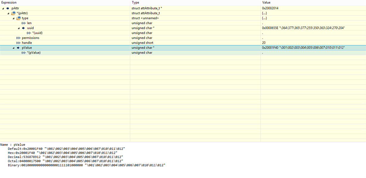

  • Hi Mohammad,
    GATTServApp_ProcessCharCfg is ultimately what will being calling the BLE-Stack API to send your notification. Since it appears that you are getting the array passed into your set_parameter function, can you debug into the GATTServApp_ProcessCharCfg to see what it returns? If successful it should call gattServApp_SendNotiInd and return a status, what is that value?
  • but the notification is receiving on btool the problem is that m only getting 5 bytes of the characteristic value while i have defined it 20 bytes in the code....and one more thing i also tried removing notify property and gave characteristic 4 read property and disable the notification property at that time it was just like another characteristic with read property and when i read its value in btool it was still giving 5 bytes only (keeping in mind that it was no more a notification characteristic) ........
  • Mohammad,
    Thanks for the update. However, if you are trying to send notifications, then it is best to test with notifications. Can you please try my suggestion above?
  • i will try ur suggestion too ...beside ur suggestion i have found another solution but couldnt find what the problem was....i created another characteristic with same properties of 20 bytes and it worked i did everything same as i did for characteristic 4 so with new characteristic m receiving 20 bytes but still couldnt get what the problem was well ill try ur suggestion and will update u on this so that anybody else couldnt face the same problem
  • Mohammad,
    Glad you have it working, but I believe you have missed one step for converting char4. I have been to send a 20B notification on char4 by following the general steps outlined you sent. Let me know the results of your debugging. Particularly you are interested in
    gattAttribute_t *pAttr;
    pAttr->len //MAKE SURE THIS IS 20B!
  • this is the debug screen shot for pattr
  • the status  is success its not the norify property problem i guess its something else
    because i created another characterstic with the same code and i am receiving 20 bytes on notifications
    but not on char4
  • Mohammad,
    The problem is that len is not 20B so the GATT server still thinks you are working with a 20B char. The best advice I can offer is that you should go through every reference to char 4 and change its size. Also, since char4 is now an array, there is some pointer housekeeping that needs to be taken care of. For example &char4 is not necessary anymore. Also make sure when initializing char4 in the SBP init function you are using a 20B value. I have verified that it is possible to extend of char 4 to 20B.
    If you still have issues please post your code (entire .c,.h files) as an attachment. Please do not copy and paste as it will be hard to read. You can do this using the rich formatting button and then clicking the paperclip

  • Hi there,
    I have almost the same problem as mohammad,
    I'm able to transfer up to 90 bytes in a single characteristics, but following examples I'm trying to convert this characteristic into notifiable one but characteristic is not notifying. I'm using a custom android app (api 23 with requestMTU handling). So if I read characteristic I can read entire 90 bytes, but I'm not get notifications from this characteristics. Apparently, when my characteristics are single byte or upto 13 bytes(the maximum tested before 90 bytes) it notify as required, but no longer works with 90 bytes characteristics. Can you provide me any hint to debug or solve this issue???? Thank you.
  • Hi Mohammad,
    In my test, Simple_peripheral can notify 20 bytes to BTools
     @file  simple_gatt_profile.c

  • Hi Erick,
    If you want to transfer more than 20 bytes, you need divide data into 20 bytes or use bluetooth 4.2
  • The problem was solved a long time ago
    I wonder you are replying after 4 months lolx
    well the problem was with the stock notify character given in simple ble peripheral
    i was modifying its length but i was only receiving the 4 or 5 bytes
    so i created another notify character with 20 bytes length and it worked.
