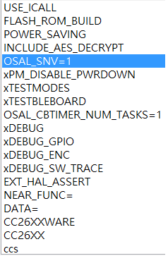

    Can you set OSAL_SNV=1 in the Stack project predefined symbols and rebuild the Stack project?
    Best wishes
  • Hi JXS
    1.Now I can build success but "BOARD_DISPLAY_EXCLUDE_LCD" need to enabled in predefined.Always built error if disable this.
    Already there and provide predefined as below,please help to confirm it all needed or not to multu-role.

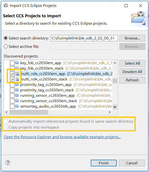

    2.As the project import,why the multi-role's icon was different with others? The option "Automatically import reference projects found....." also disable?
      Capture as below.
    Thanks!
  • Hello again,
    I was not able to encounter the same error as you after changing to use the CC2650DK_5XD define.
    Did you build the stack project firstly? This will configure the boundary address using the frontier tool. If you still encounter the build error, I suggest re-install the BLE-Stack and make sure you are using the ble_examples update from 02-SEP-16.
    Best wishes
