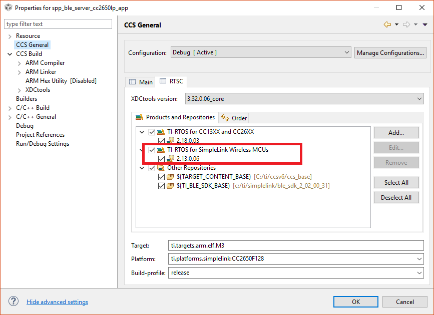

Hello everyone.
I'm sorry if I'm repeating the post but the solution given to a similar question not solved my problem.
Recently acquired the CC2650 development kit launchpad with the intention to use the example spp_ble_server available here:
https://github.com/ti-simplelink/ble_examples/tree/master/examples/cc2650lp
Unfortunately after building and downloading the example using CCS 6.2 and 5.2.6 compiler my cell phone can not find the launchpad on the network.
The only warning that the compiler is giving is:
Description Resource Path Location Type
Invalid project path: Duplicate path entries found (/ spp_ble_server_cc2650lp_app [Include path] isSystemInclude: true IncludePath: C: / ti / tirtos_cc13xx_cc26xx_2_18_00_03 / products / tidrivers_cc13xx_cc26xx_2_16_01_13 / packages), path: [/ spp_ble_server_cc2650lp_app]. spp_ble_server_cc2650lp_app pathentry Entry Path Problem
There are no errors on the building process.
What can be wrong?
Thank you

  • Hi Sean, i want to thank you for you help, but I've solved the problem.
    By default for some reason the TI-RTOS was not selected in the project. Compiled, downloaded but gave no error and neither worked.
    Below is a picture of what has been selected.
    This problem is solved, thank you.
    Cheers
