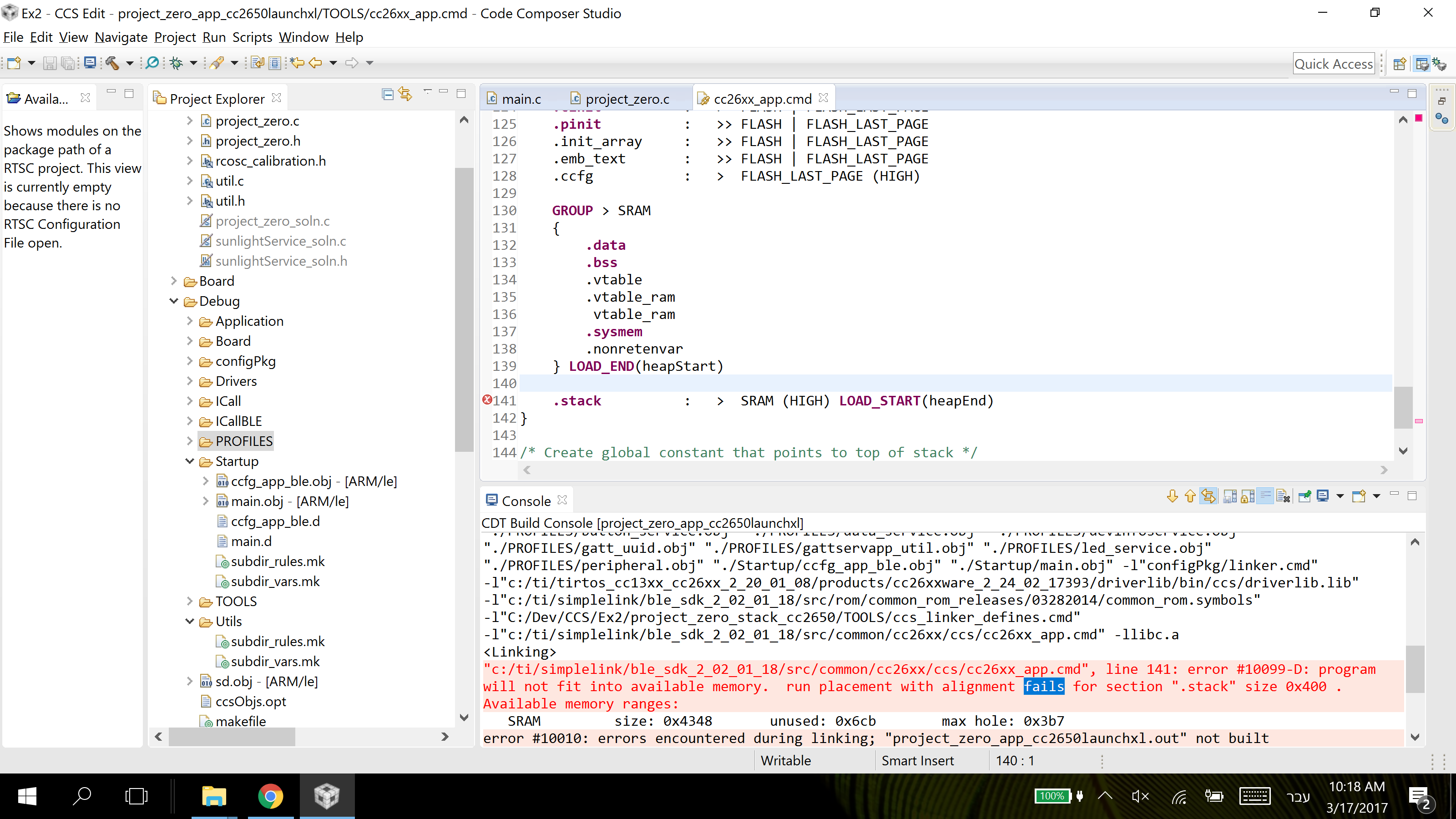

I am trying to take Project zero and add code to the project and since it is so full of code I get this problem:
Does anyone knows why this is happening? How can I fix it?

  • I did what you told me but that didnt solve the problem.
    still getting
    ""c:/ti/simplelink/ble_sdk_2_02_01_18/src/common/cc26xx/ccs/cc26xx_app.cmd", line 141: error #10099-D: program will not fit into available memory. run placement with alignment fails for section ".stack" size 0x400 . Available memory ranges:
    SRAM size: 0x4348 unused: 0x6cb max hole: 0x3b7"
    Do you have any other suggestion?
    Tomer.
  • Hi Tomer,
    At this point you either need to reduce the RAM utilization of your added code, or port your application to simple_peripheral which is a skeleton BLE peripheral application without instrumentation.
    Best wishes
