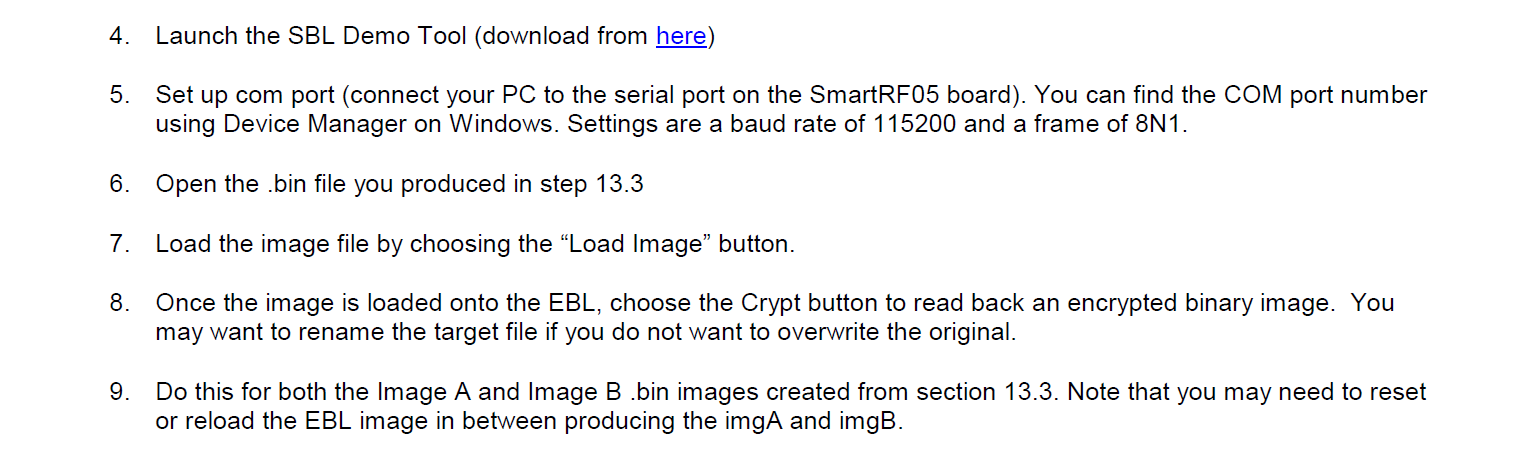

Changing the aesKey is described in page 15 of the CC254x OAD guide:
Best wishes

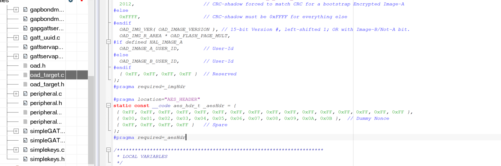

Kindly reply YiKai Chen
Can I use this to sign in simple OTA. If NO kindly suggest me something unique in Simple OTA to stop to upload any bin file except mine.
