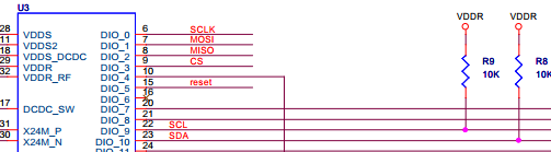

I'm working on custom made  cc2640r2f sensortag devices with Sensor controller studio 2.0.0.324.
I'm trying to communicate with the temperature sensor via I2C using sensor controller studio and I'm always getting i2cStatus==0x0002(timeout) and not getting the values of the temperature register.

Has anyone faced such issues?
Please advice.
