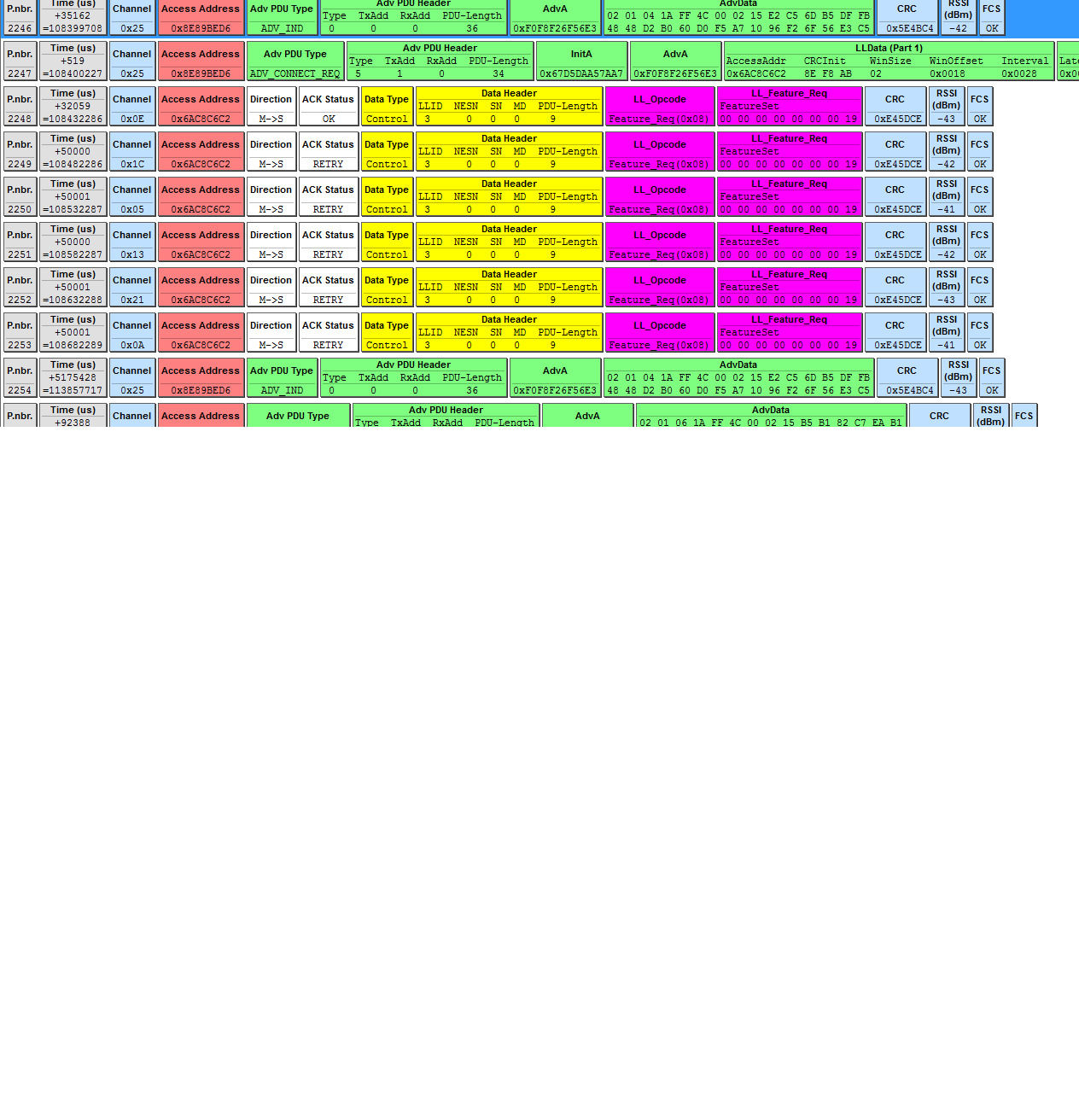

I using multi-role project of simplelink_cc2640r2_sdk_1_40_00_45 to communication with my APP encountered a problem, central (Android APP) will send LL_Feature_Req,
but peripheral (CC2640R2F) sometimes does not have Response...
How can i modify firmware to response this request, just like following figure.
Below is the our customer original solution, use packet sniffer to record.
