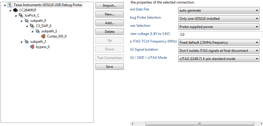

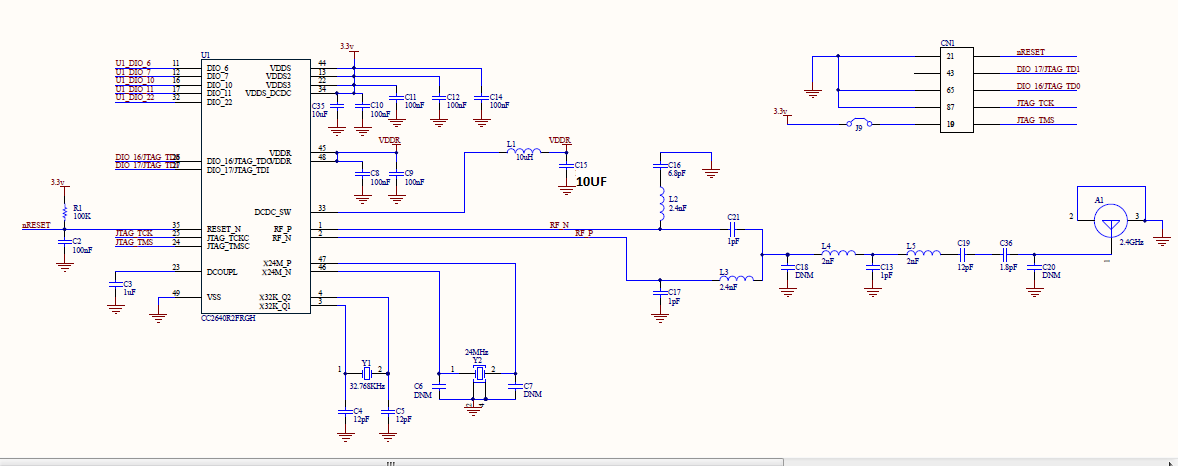

I have made the same reference design as per the LaunchXL schematic
I have connected the XD110 jtag of launch pad  to customised board and removed all jumper of launchpad
I am getting vdds 2.0v and VDD_RF as 1.96v
I am getting the error while flashing
IcePick_C: Error connecting to the target: (Error -242 @ 0x0) A router subpath could not be accessed. The board configuration file is probably incorrect. (Emulation package 7.0.48.0)
I have follow the steps as per the link
pleae look imto the code and plz reply what else needed to be done as i am not getting any idea what more should be done code for TI.zip
