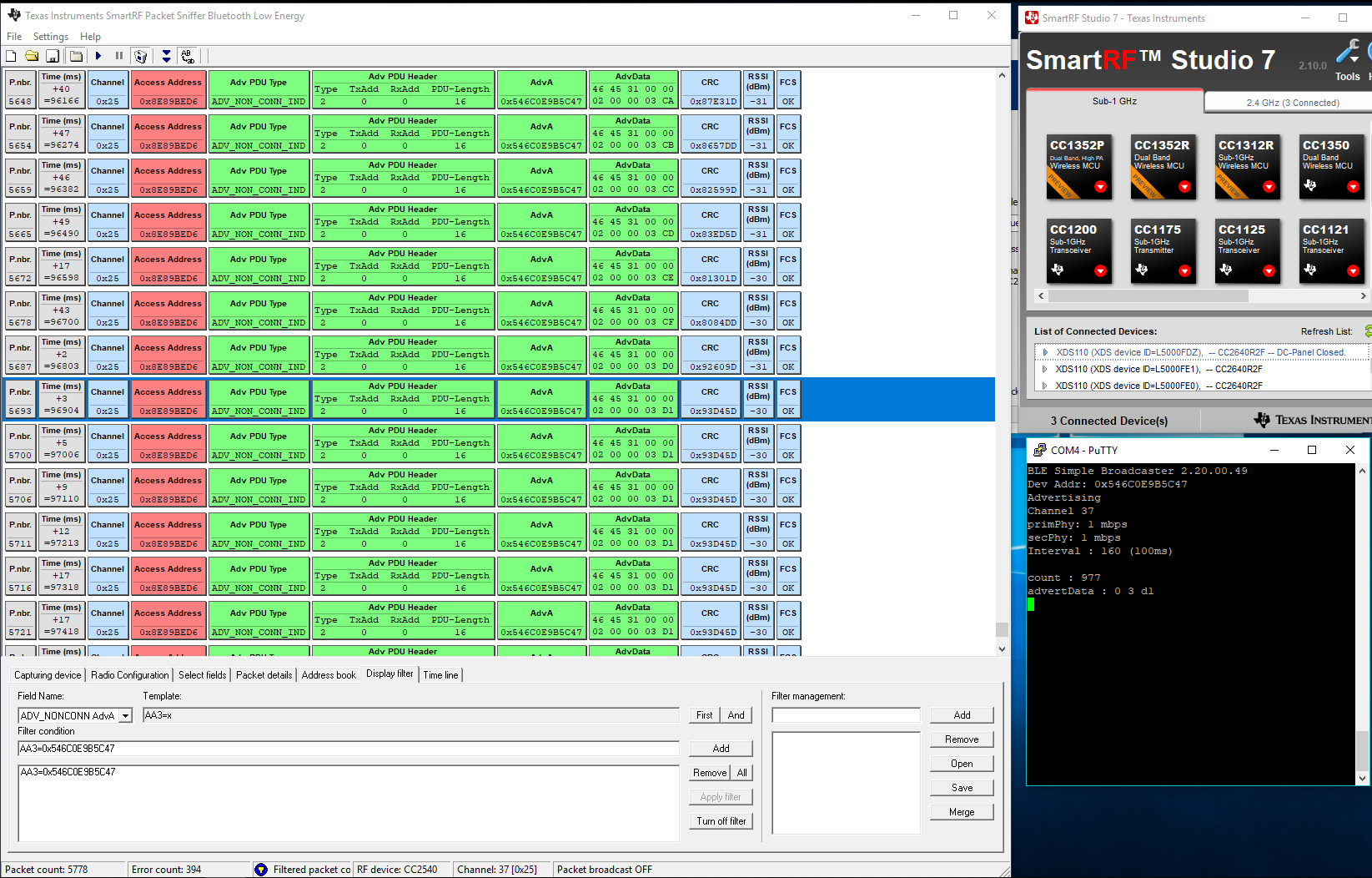

As title, I want to broadcast some data within counter, so any packet will have different data.
Example i based on : simplelink_cc2640r2_sdk_2_20_00_49\examples\rtos\CC2640R2_LAUNCHXL\ble5stack\simple_broadcaster.
I changing advertData in function SimpleBroadcaster_processAdvEvent 's case GAP_EVT_ADV_END
The result is packet will changed, but over some number of times, it will stop changing.
Any suggestion you can give me to solve my problem?

    And here is my result. Every times reset will let Broadcaster count from 0 to 977, and then stop counting, but still broadcasting.
