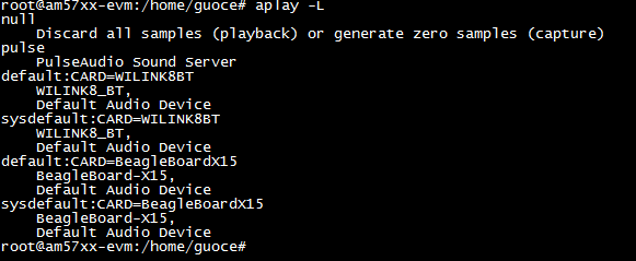

The picture below is my two audio devices.
I changed the LinuxHFRM_HF. C #define ROUTE_GSTREAMER_WL_TO_AM335_SPK_16K "gst-launch-1.0 alsasrc device=plughw:WILINK8BT ! audio/x-raw,channels=1,rate=16000 ! alsasink device=plughw:AM335xEVM &" to
#define ROUTE_GSTREAMER_WL_TO_AM335_SPK_16K "gst-launch-1.0 alsasrc device=plughw:WILINK8BT ! audio/x-raw,channels=1,rate=16000 ! alsasink device=plughw:BeagleBoardX15 &"
