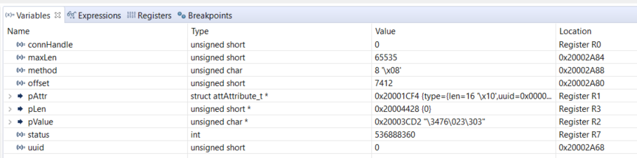

    Also, on a kind of unrelated topic the only modification I have done so far to the sensortag_cc2650stk is changing the MOVEMENT_DATA_LEN to 22 in the movementservice.h.
    However I'm still seeing only 18 bytes on the LightBlue App (which is what I'm using as BLE Scanner) and they are always the same, which is not the case when MOVEMENT_DATA_LEN is 18.
    Is there something I'm not considering that should be done?
    Alejandra
    Try to look into movementservice.h and change MOVEMENT_DATA_LEN to 22 bytes as well, this is the define that is used for the service itself.
    I'm setting it to 22 on movementservice.h
  • Dear M-W,
    As you suggested I added "var Seconds = xdc.useModule('ti.sysbios.hal.Seconds');" to the .cfg file, and now I'm being able to build my app project with the Seconds_set(); placed into the SensorTagMov_init();
    However, I'm still unable to read the 22 bytes from the Movement Service. I'm only getting 18, even though I've changed the MOVEMENT_DATA_LEN to 22 bytes into the movementservice.h.

    Also, could you put down a breakpoint in the sensor_ReadAttrCB function and record the arguments following a read from the device (this will drop the conenction). In this state, what is offset, maxLen and Method?

  • Hi again M-W,
    Sorry for all the messages.
    I managed to do the breakpoint process, here is an screenshot of the variables.
    Alejandra
  • Hi Alejandra,
    You might need to turn off optimizations to be able observe the correct values, the screenshot seems to indicate you are not actually observing the correct values.

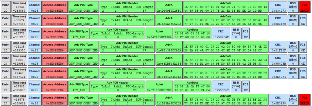

  • Hi M-W,
    Currently I don't have any yellow fields, from the debugger of my app I can see that data is being transmitted, but on the sniffer I don't have anything related to the connection packages. I only have the advertising packets.
    Even If I go back to the SensorTag App and the unmodified firmware I still get only advertising packets.
    I went to the Peripheral.c to set  gapRole_AdvChanMap = GAP_ADVCHAN_37; and set the channel in the sniffer to 37 to see if anything changed but the behaviour remained the same. (Did the same with 38 and 39)
    Moreover, I tried setting the Initiator Address on the Sniffer to the cell phone's address and to the sensortag address.
    I also tried to test this in a less crowded enviroment, but still nothing.
    Attached is a screenshot of what I usually see.
  • Dear M-W,
    After many configurations, I was finally able to get data.
    Attached is a screenshot of what I'm getting, as you mentioned I have (what I assume to be my data) and some empty payloads.
    In your opinion what I'm seeing makes sense?
    Alejandra
