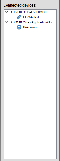

    I've followed your steps but I'm getting different results, the connected devices will remain "Unkown"

  • It should not be required to click connect. If everything is correct it should look like this in flash programmer 2:
    Then it's just to click on the chip name to get a connection with the device.
  • I'm afraid I'm not getting that. Not even when I just connect the launchpad with all the standard bridges in place. (so no custom board connected)
  • But it recognize the XDS110 in the launchpad I hope? Could you post a screenshot of the same window as I did?
