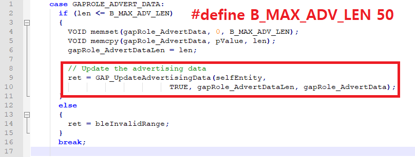

I know that in BLE version 5 advertisement data length can be 252byte.
so I setting the length of advertisement data 40byte in _advertData.
I update advertisement data using this code GAPRole_SetParameter(GAPROLE_ADVERT_DATA, sizeof(_advertData), _advertData);
and then scan using my phone, there are no advertisement data. (iPhone 8+, using application = TI Sensor TAG(SimpleLink)

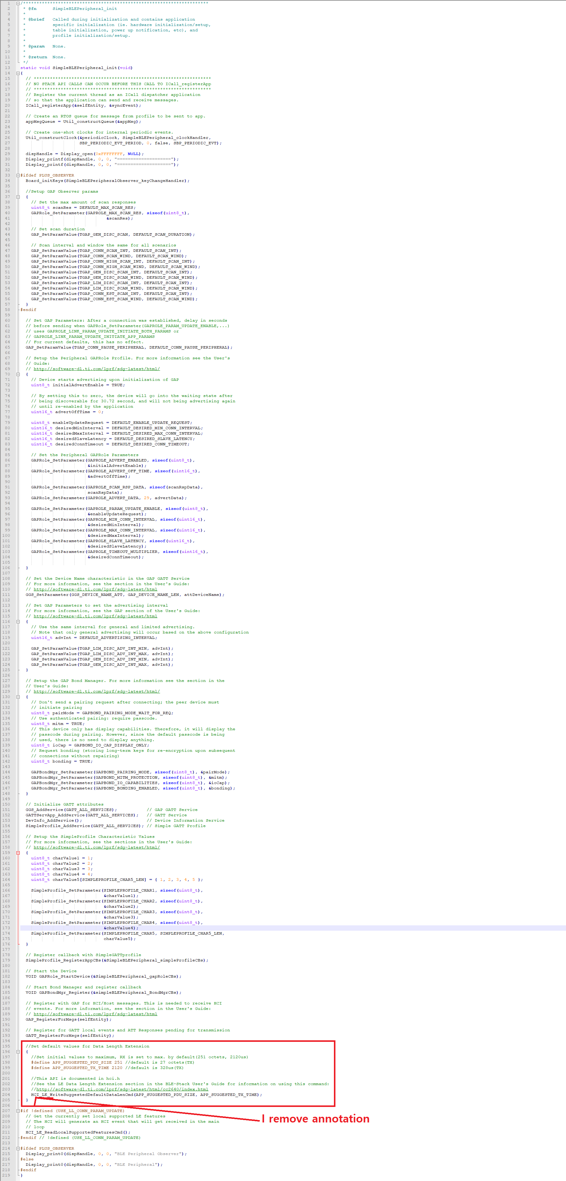

I use sample project named "simple_peripheral_observer_cc2640r2lp_app"
here is setting code in project.
Function is here
return value (ret) is SUCCESS.. but it doesn't work.. PLZ let me know what's wrong...
