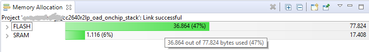

  • Hy Evan,
    thanks for your response. I will go through all of these documents and try to estimate the final flash requirement of my app. Just one question upfront:
    My memory allocation view of the stack says:
    so 40,960 bytes should be still available. Why can't I use this for application? Why does the stack allocate that much flash?
    Harald
  • Harald,
    Your application is using what's free after the stack. That screen shot is showing the flash availability after the stack has been compiled.
    When you look at the app memory allocation view, you'll 39kb of roughly 41kb.
    That 41kb is approx calculated after the stack uses up the 36kb of the 77.8kb available and so on with the persistent app and bim. Some flash is utilized for the image headers and other stuff that makes it approx.
    I hope that makes sense how I've explained that.
    Basically what is taking up 39kb of the application is the logic needed for on chip OAD, the GAP, Icall, profiles/services and everything else you find in the oad on chip app project.
    Please let me know if you want me to further clarify.
