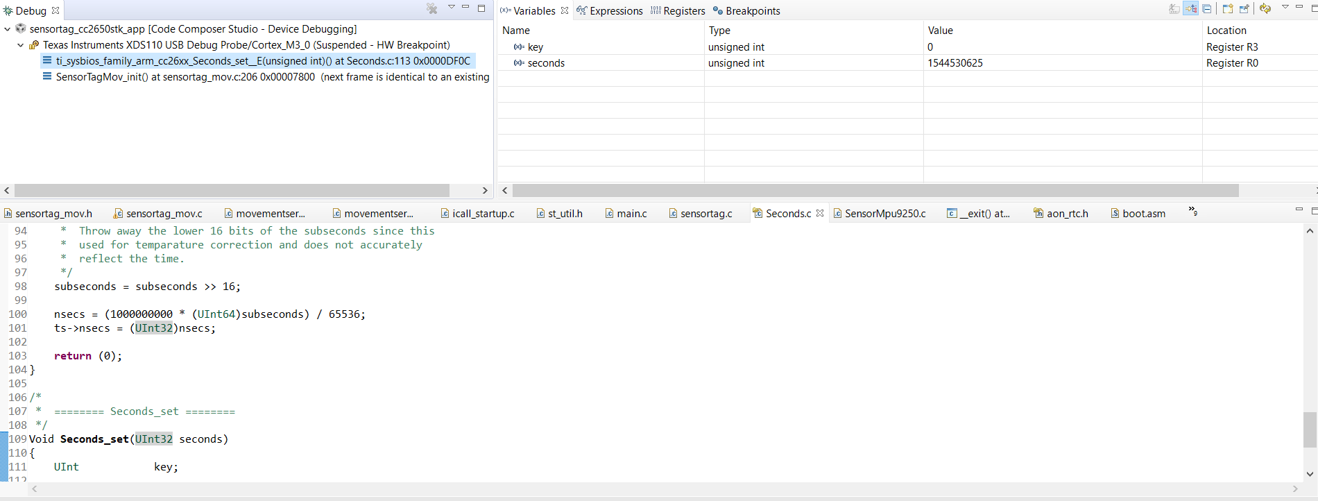

I'm trying to add the UNIX/Epoch timestamp in milliseconds to my accelerometer and gyroscope data from the sensortag_cc2650_app project.
I'm using the Seconds module, and the Seconds_getTime() function on the sensortag_mov.c
First I'm calling Seconds_set, and then Seconds_getTime() as follows:
SensorTagMov_init()
Seconds_set(1536329381); //Set time to Current Unix Timestamp (05/09/2018 @2:32 pm UTC)
SensorTagMov_processSensorEvent(){
     Seconds_getTime(&time_s);  //time_s was declared as: ti_sysbios_interfaces_ISeconds_Time time_s;
     uint64_t unix_millis = (time_s.secs*1000) + (time_s.nsecs/1000000);
My problem is that my time_s.secs has a value of zero, so I cannot get the complete UNIX Timestamp.
Attached is an image of what I get using the debugger.
Any idea on how to fix this? Maybe there is something I'm not doing right?
Thanks in advance,
Alejandra :)

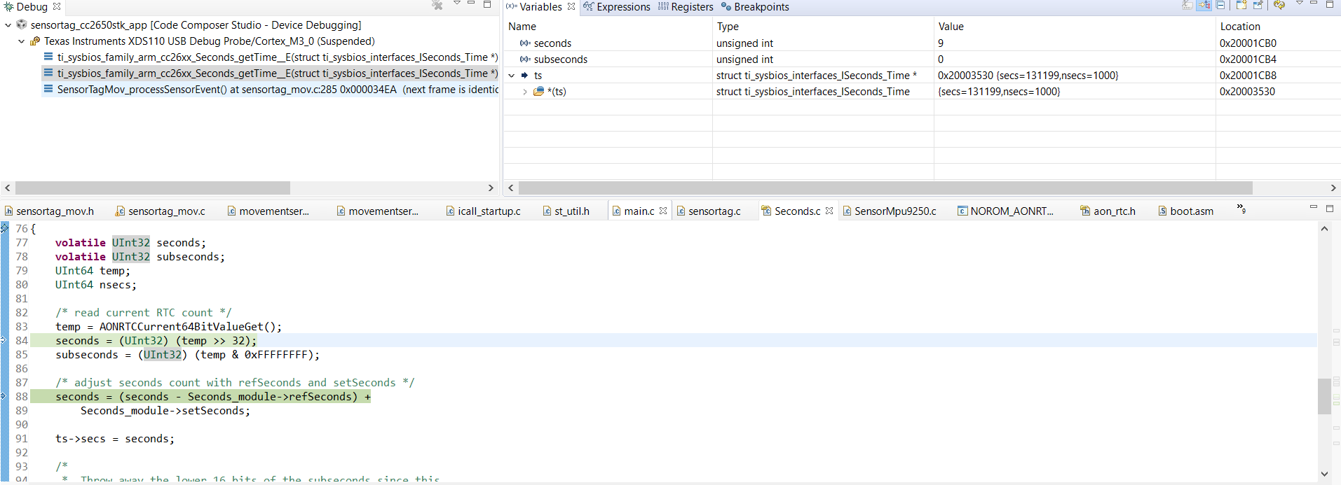

  • Hi Alejandra,
    I'm not sure I'm seeing the issue here. Your "ts" struct seconds is a non-zero value, while the local "seconds" variable is zero. The later seems to make sense based on the fact that the program seemed to be paused before assigning any value to seconds.
    What happens if you set the break point on "subseconds"?

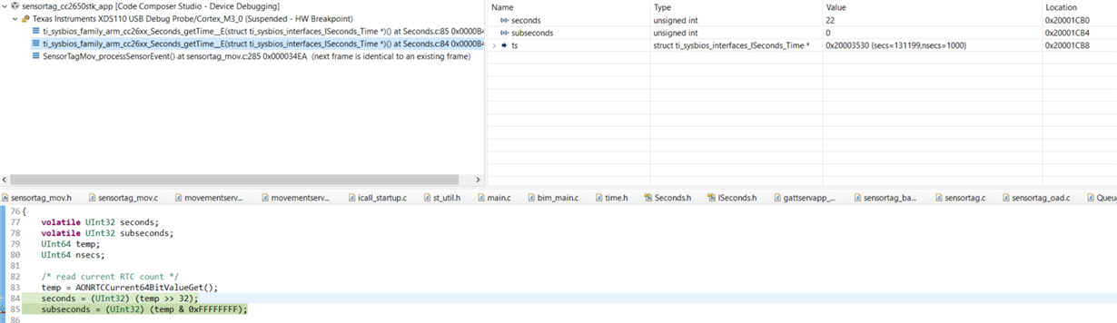

  • Hi M-W,
    Thanks for answering.
    This is what happens when I set the break point on "subseconds"
    Here again my "ts" struct is a non-zero value, and the seconds variable is zero.
    As you mentioned this might make sense, and the program indeed pauses during the debugging, since I'm using the SensorTag app and it quickly disconnects after.
    But I'm still getting some zeros, where I expect to get something different.

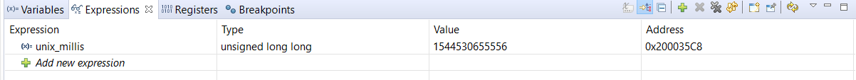

    If I split my unix_millis, as follows:
    uint32_t unix_millis_hi = unix_millis >> 32;
    uint32_t unix_millis_low = unix_millis &0xFFFFFFFF;
    I get some bytes that make sense when converted to decimal, a 10 digit timestamp, from my unix_millis_low but I get only zeros in my unix_millis_hi.

  • Hi Alejandra,
    In your picture, "seconds" is not zero, it is 22. "subseconds" is zero but again, the debugger has stopped before populating this value so that is expected.
    In your example, is "unix_nano" = = "unix_millis" or is this another conversion you do, in this case, can you share that as well?
    I would look closer on how you put together "unix_nano" as you are dividing this with 4294967296 to create "unix_millis_hi", this implies you are sure that there is data in the top 32 bits of a 64-bit variable.

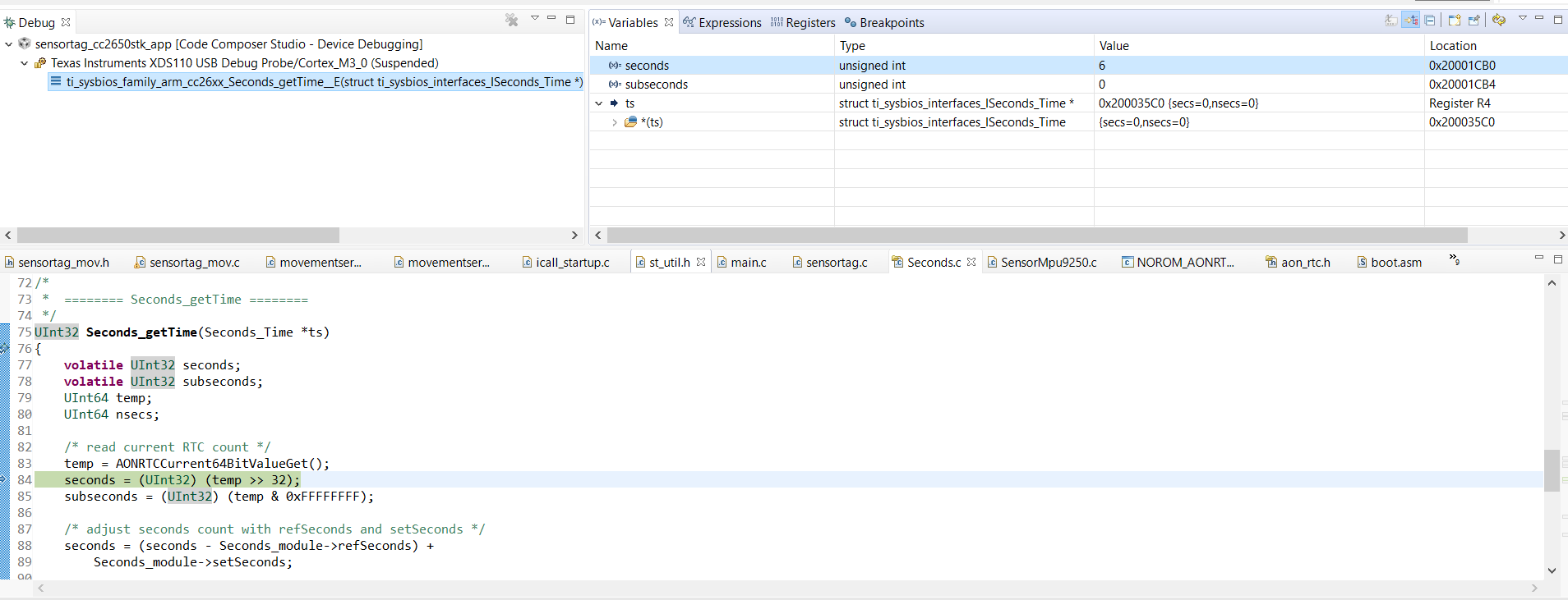

    In that case, seconds * 1000 should be something larger then 32-bit you are right. Could you add the "Seconds_module" to your watched variables so that the value of X is clear when you are debugging and poast a picture of that?
    Also, where in your code do you do the "Set()" part?

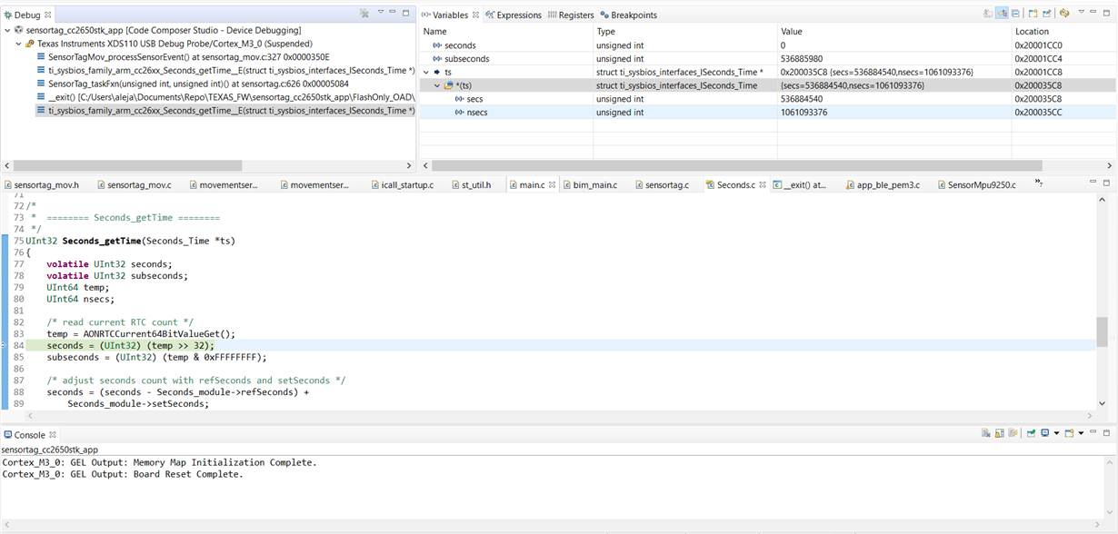

  • Hi M-W,
    This is a breakpoint in the Seconds_set(); that I do inside the SensorTagMov_init()
    Then this is what I'm getting in Seconds_getTime():
    Then If I step into...
    Again stepping into...
    That is what I expected to get. And with those secs and nsecs my unix_millis is what I was expecting. (13-Digits: 1544530634751) and therefore it should be larger than 32-bit.
    So I expect to have something different than zero in my unix_millis_hi. But I'm not, I get only zeros.
    Alejandra
