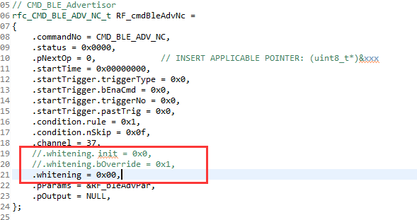

3.In the AOA reciver program in the SDK, when changing the whitening configuration in the AOA.c file, it is found that the highest bit bOverride bit in this byte cannot be set to 1 when writing .whitening=128.
