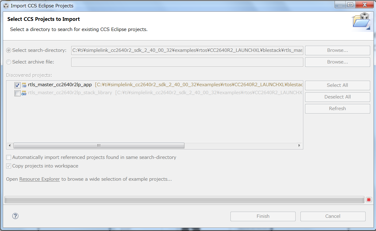

I want to work AOA demo with  CC2640R2-LAUNCHXL and BOOSTXL-AoA board and downloaded CC2640R2 SDK ver 2.4.0.
However it seems that the project can not be build. How can I build it correctly?
<CCS ver: 8.3.0>
<Project path:C:\ti\simplelink_cc2640r2_sdk_2_40_00_32\examples\rtos\CC2640R2_LAUNCHXL\blestack\rtls_slave>

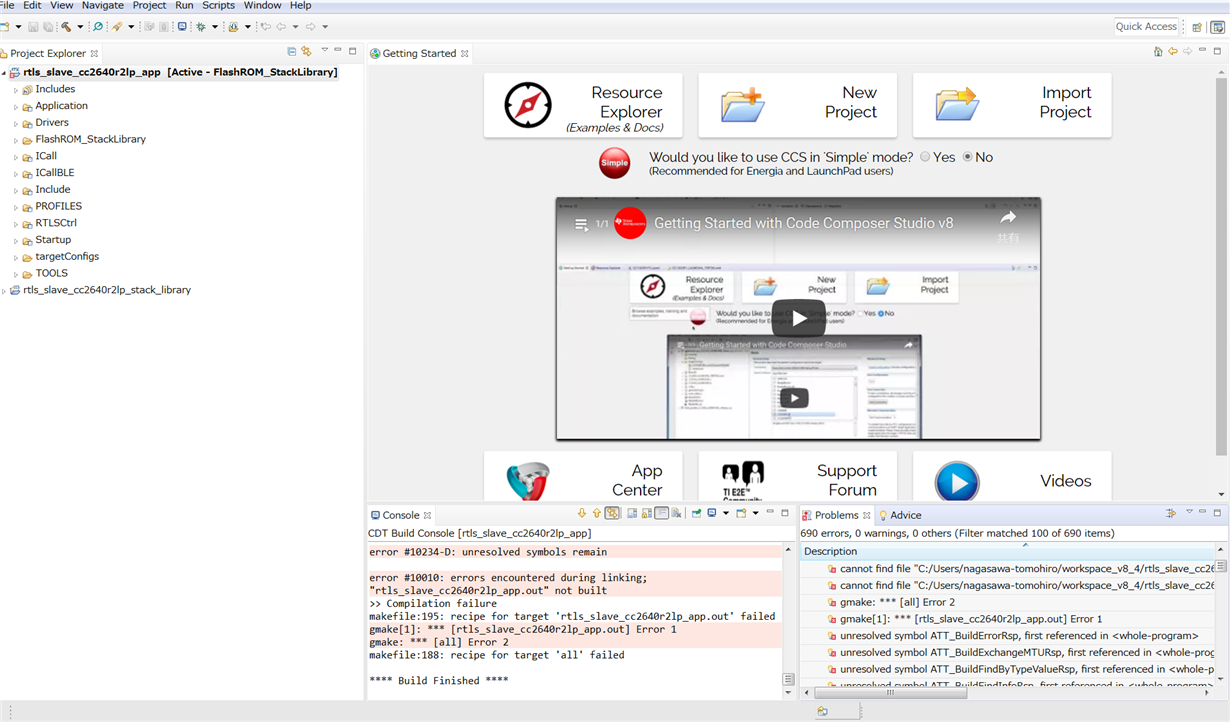

<capture>

    I tried to fix below 1 issue, but error is not reduced.
    1. The out of box project for rtls_master and rtls_slave have build error due to the stack_library.projectspec is pointing to a wrong version of XDCTools. (CCS)
    In the first place, when importing a project, I can not check both App and Stack, but is this a problem?
    Could you give sample project without error?
    Tomohiro Nagasawa
  • No, when you pick up an app project, it will also pick up the corresponding stack project, so that’s not an issue. Please modify the stack projectspec file, and do a build on a stack project first.

    I also encounter this problem when test C:\ti\simplelink_cc2640r2_sdk_2_30_00_28\examples\rtos\CC2640R2_LAUNCHXL\blestack\aoa_receiver examples,  like following errors...
    error #10008-D: cannot find file "D:/xxx/tiaoa/workspace/aoa_receiver_cc2640r2lp_stack_library/FlashROM_Library/ble_r2.symbols"
    error #10008-D: cannot find file "D:/xxx/tiaoa/workspace/aoa_receiver_cc2640r2lp_stack_library/FlashROM_Library/lib_linker.cmd"
    undefined first referenced
    symbol in file
    ATT_BuildErrorRsp <whole-program>
    ATT_BuildExchangeMTURsp <whole-program>
    ATT_BuildFindByTypeValueRsp <whole-program>
    ATT_BuildFindInfoRsp <whole-program>
    error #10234-D: unresolved symbols remain
    CCS version: Version: 8.3.0.00009
    System version: Windows7 32bit version
