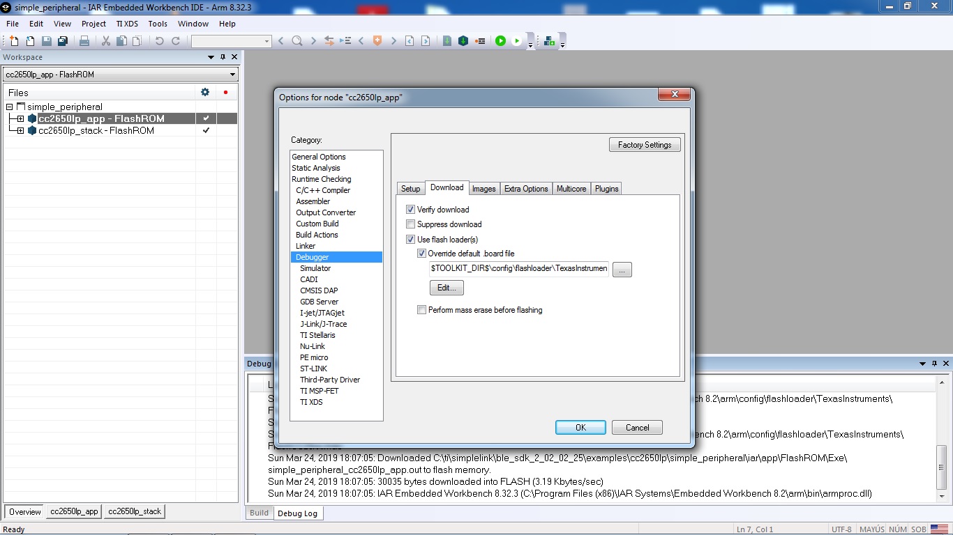

Hi all !
I have loaded the simple_peripheral example project in my CC2650Launch Pad. But I can't see the CC2650LaunchPad device from my smarthPhone or my Laptop.
The same problem with any Bluetooth Example Project.
Please, any idea of my mistake?
Thank very much. Best regards
  • Which BLE Stack version do you use? Do you download both simple_peripaheral_app and simple_peripheral_stack into your LAUNCHXL-CC2650 to make it work?
  • Hi YiKai Chen ! Thanks very much by your answer,
    I am using TI BLE Stack SDK 2.02.02.25.
    Yes, I have downlod the simple_peripheral_app and afetr I download the simple_peripheral_stack.
    I test downloading the simple_peripheral.hex file. The same problem. I can not see the CC2650 LaunchPad from a smartphone.
    Some idea of may problem? Please
    I attached a viseo with my procedure, thera are any wrong in my procedures?
  • My debugger setting, this is ok?
  • The matched IAR EWARM version is 7.80.4 so I suggest you to test this with 7.80.4 insterad of 8.32.3. Or you can try to use CCS8.3 intead of IAR.
  • Also make sure the correct compiler version is used (listed in the release notes):
    file:///C:/ti/simplelink/ble_sdk_2_02_02_25/release_notes_BLE_Stack_2_2_2.html

  • Hi YiKai Chen
    You are right !!! I tested with IAR 7.80.3 and all is perfect !!! I can see the launch pad how a bluetooth device with my smartphone and with my laptop !!!
    Sicerely Thanks very much !!!
