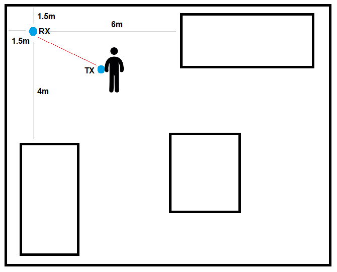

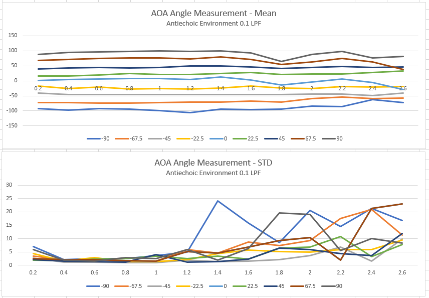

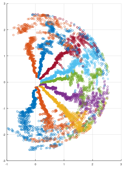

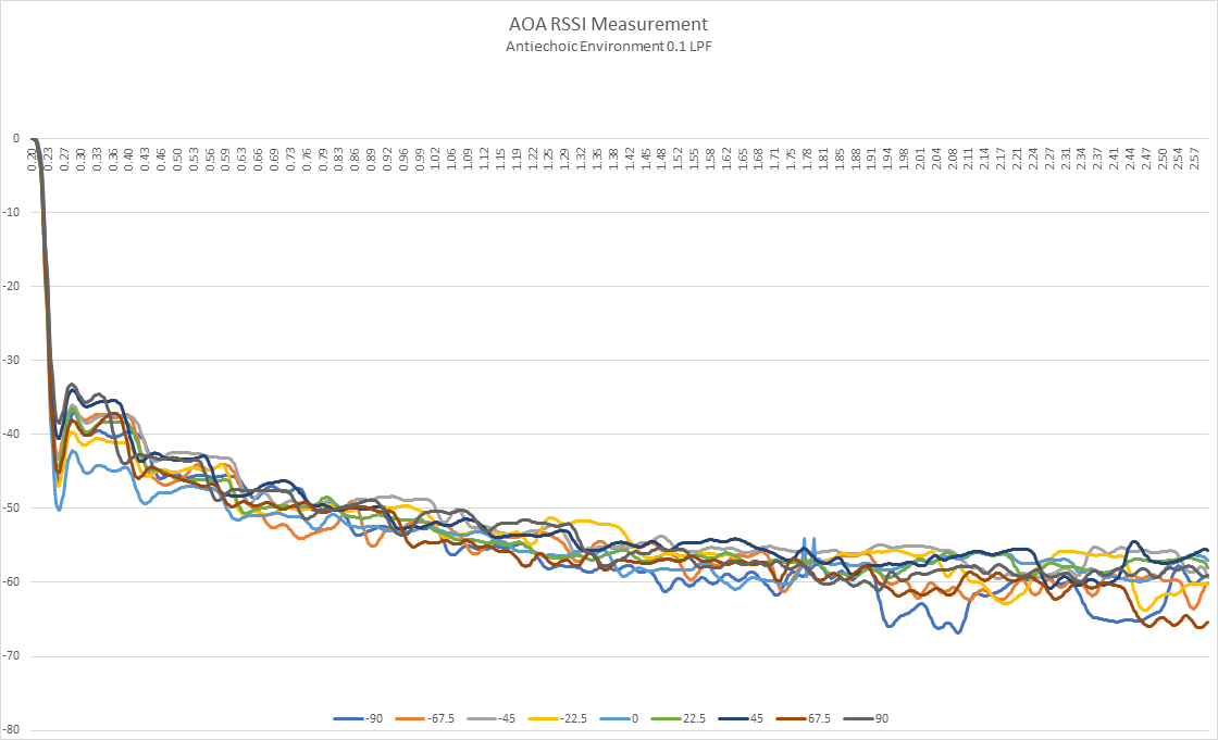

Please check out the attached graph and see if this is representative of expected performance. This was conducted in an open environment with 16 foot ceilings. Measurements were taken from 0.2m to 2.6m in 20cm intervals and from -90 to 90 degress in 22.5 degree intervals.
