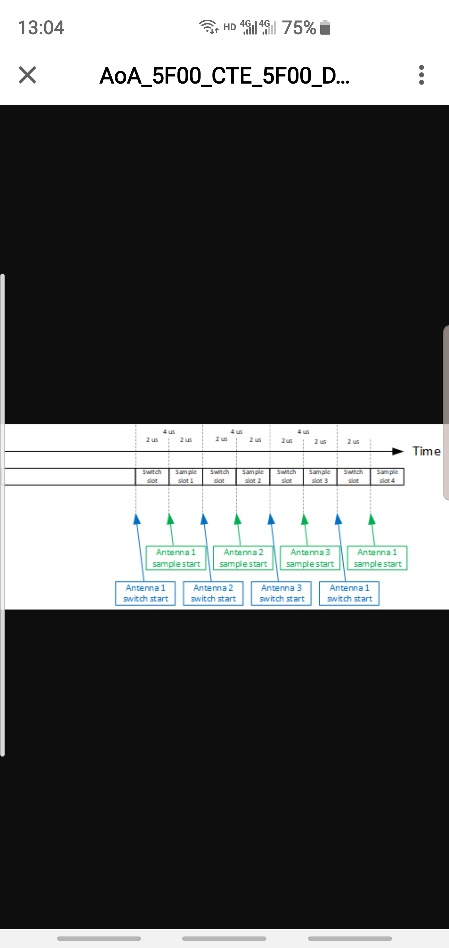

1. accroding this diagram . if the switching time is fixed at 2 us. and 2us for sampling time . base on the 4M S/s. can only sample 4*2 IQs. but accutally we can get 16 IQs per 4us. can you help explain ?

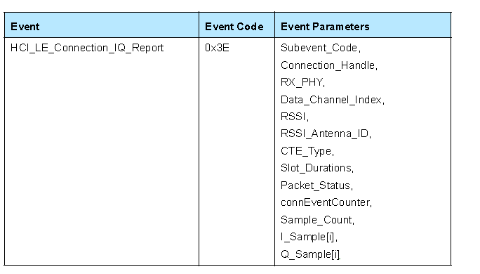

2. how can i open the above function event. so that i can count the timing of each IQ sample【i】?

    1. During the 2us switching slot, there are still I/Q samples, but just not usable. There is a section in SimpleLink Academy which covers this. The I/Q sample is continuous and it does not know whether the antenna is switching or not, the application layer has to discard the data during post processing. Even though this is made for 2.40 SDK, but the concept is the same. In our 2.30 SDK, we are not following the BT5.1 spec as it's TI proprietary solution.
    dev.ti.com/.../ble_aoa.html
    In the 2.30 SDK , we have tuned the antenna switching to at the later 2us instead of first 2us, therefore, in our example, you can see that we are using I/Q samples from index 0~7. This is explained in our 2.30 SDK user's guide

    2. If you are looking for BT5.1 like solution, please move to 2.40 SDK. All the needed information can be found in
    dev.ti.com/.../localization-index.html

  • No, the captured is done in the radio core and can't be changed.
