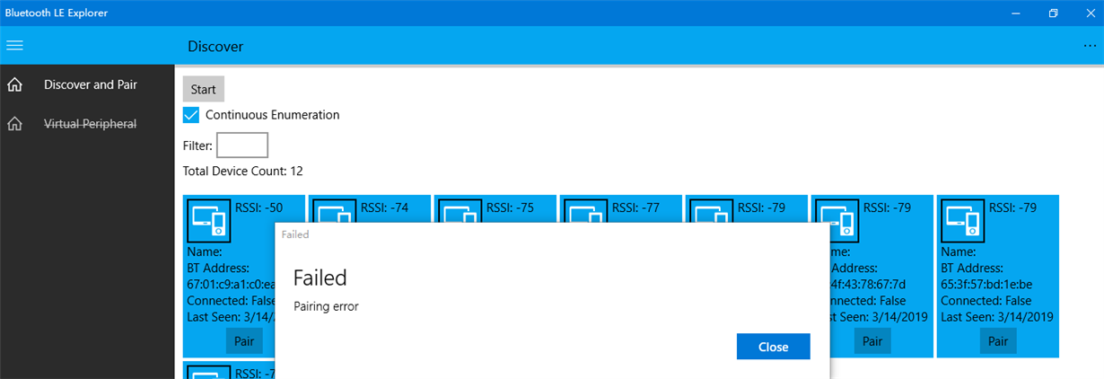

    I'm waiting it until the Windows shows pairing failed. It never shows the passcode enter window. It won't hit the breakpoint on pairing complete, it only hits the pairing started.
    I don't have a sniffer now but I will get one soon. Here's the window of pairing failed showed on Windows.
    But it can be connected and read the device information and use the services on this device.

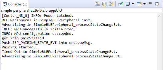

  • And I print some log on console like below:
    WhenI click pair on Windows, the console shows paring started. After 3 seconds, it will show advertising again.

  • Sorry, I don't have any over the air sniffer. I will buy one ASAP. The only way I can use is to output the information from console, show as below:
    Is there any other method to find the problem?
  • Unfortunately, this is not enough information. We need some type of log to see what is happening during the pairing sequence.
