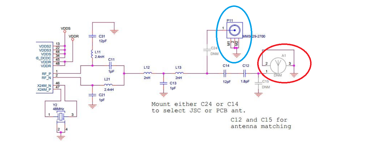

I have couple of questions regarding specifications of Antennas used in CC2652R reference design (RF section of schematics):
1. What is the part number of the on-board Antenna (A1) ? This is not shown in the BOM. Is this a printed Microstrip Antenna on the PCB or a COTS Antenna ?
2. Can you please suggest a best suited Antenna that can be connected to P11 in case I want to have an external Antenna ?
Below is the extract from the reference schematics for your reference.
Any help is highly appreciated.
CKS
    1. When the pattern is integrated into the PCB, there is no physical part number in the BOM. However, this antenna is specified in more detail in the CC-Antenna-DK2. The antenna is an inverted F-antenna, printed onto the PCB.
    2. For a 2.4 GHz whip antenna connected to the SMA, then can recommend the following antenna:
