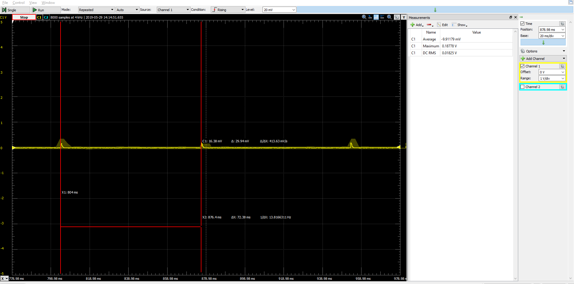

Hi all,
In the picture below, scanning pulse of 150 [ms] is shown (occurring each 2 seconds). Between each scanning pulse, device is entering standby mode (i also proved it with power driver callback events), but current spikes are present (i am not using DC-DC converter configuration and its using is disabled in ccfg.c file) and average sleep current isn't  ~ 1 uA as it should be. Also, everything needed is disabled in board configuration file.
Signal shown is gained by factor of 1000 using TI INA188. (followed measuring procedure is from https://e2e.ti.com/support/wireless-connectivity/bluetooth/f/538/t/592223).

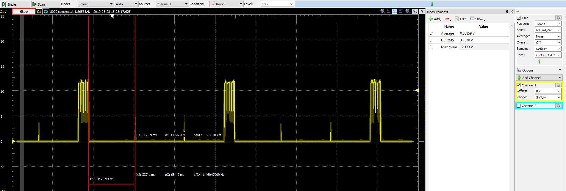

On second picture, period between two scanning impulses is shown (standby = 1.85 s, up to next scheduled scanning). As it can be seen:

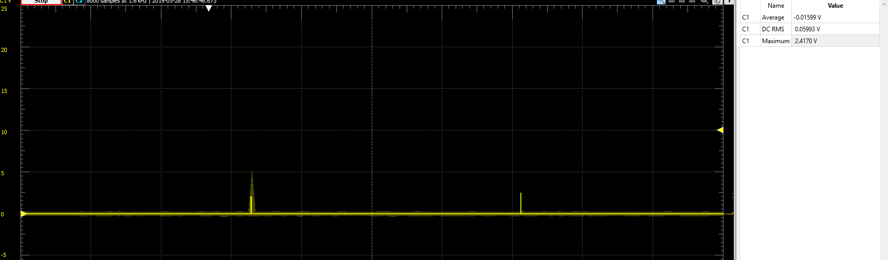

DC RMS = 0.0599 V / 1000 = 0.0000599 V = 59.9 uV (which is 59.9 uA, because voltage drop is measured on known 1 ohm resistor)

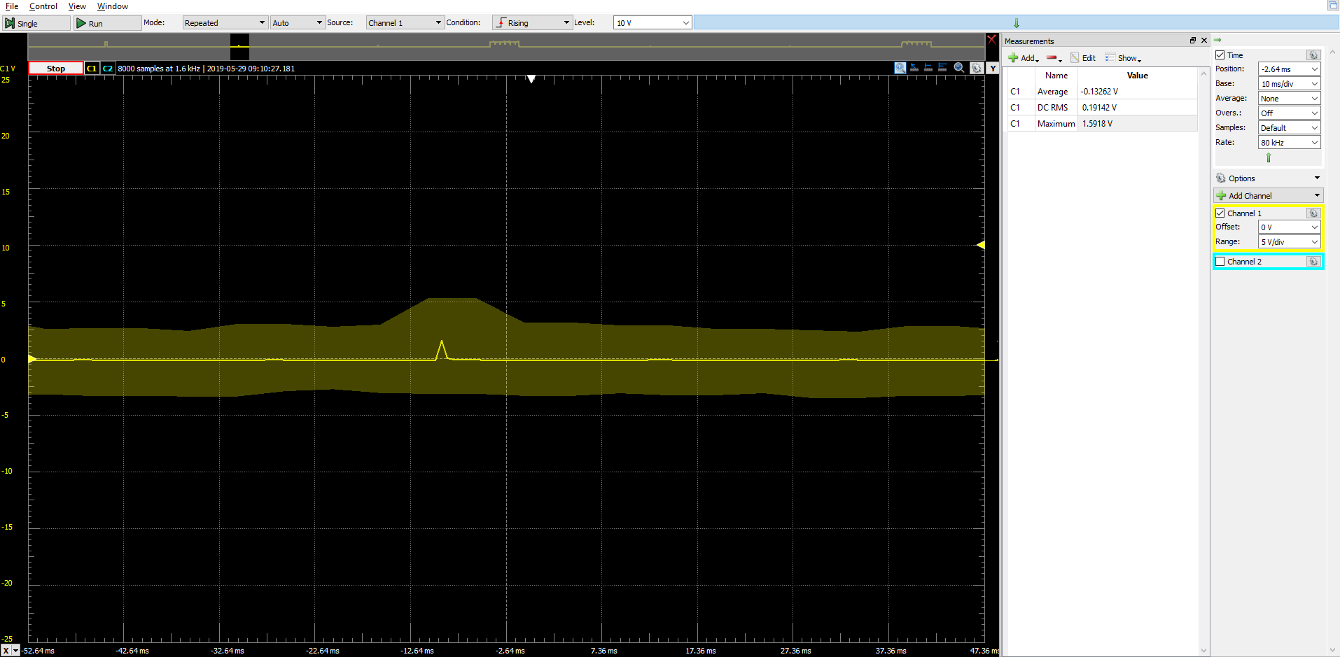

Max = 2.417 V / 1000 = 0.002417 V = 2.417 mV (which is 2.417 mA), caused by spikes!
My question here is, what can cause those spikes to occurs?
They look pretty equidistant from scanning pulse, each time.
