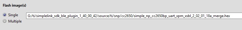

  • Hello stomp,
    Maybe its the sbl (serial bootloader) that is engaged:
    https://e2e.ti.com/support/wireless-connectivity/bluetooth/f/538/t/683707
    Maybe you can try simple_np_cc2650bp_uart_xpm_xsbl_2_02_01_18a_merge instead?

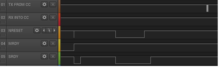

    I've programmed exactly the file you've mentioned:
    And I've logged the pins:
    You can see my SAP resets the CC2650MOD and then the CC2650 holds its SRDY pin low then brings it high again when its done.  Some time later it transmits.!!!!!

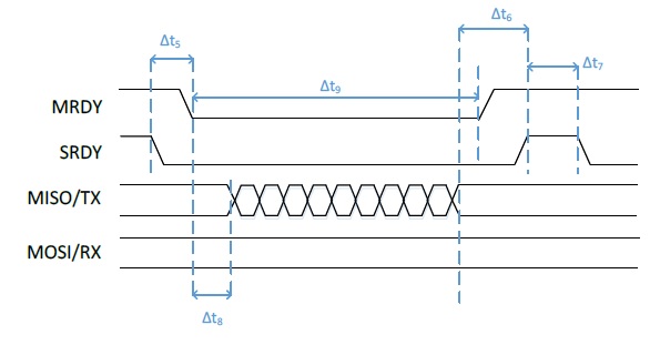

    However, from the link:
    http://dev.ti.com/tirex/content/simplelink_cc2640r2_sdk_2_40_00_32/docs/blestack/ble_user_guide/html/ble-stack-common/npi-index.html
    We have this image:
    And you can see that the SDRY pin does not go low again before it attempts to transmit. My SAP does not get an interrupt and has no need to receive the serial traffic.
    I have the same behaviour on two totally different PCB's.
    What can I do?
    Thanks.
