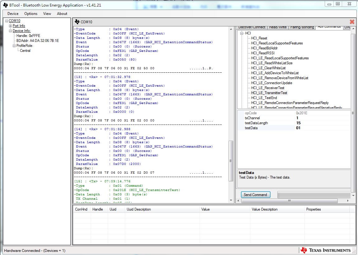

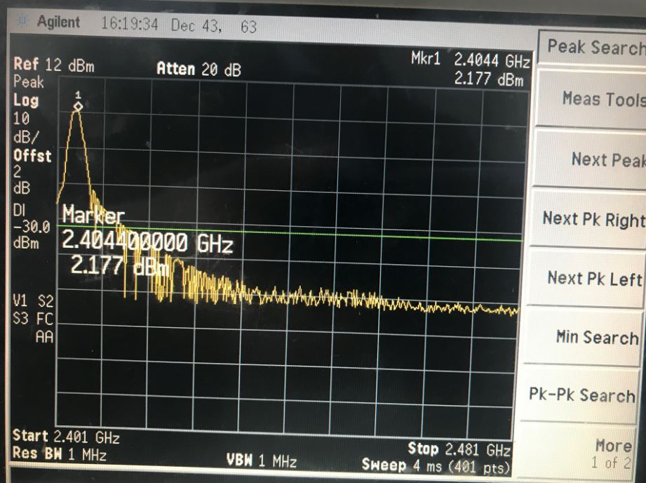

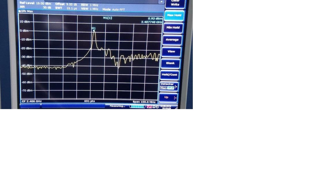

My customer is using CC2640R2F and sent out 2 pcs of custom board for RF certification. The two boards fail at RF-PHY TRM-LE-CA/BV-03-C. Please see attached test report. How can they improve that?
