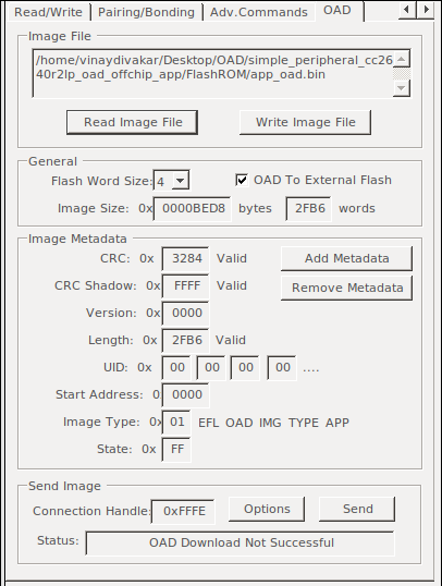

I followed the steps in the off-chip OAD Docs out of box example and facing an issue (All done in ccsv8). Below is what I did.
TARGET SIDE::
1. Imported "simple_peripheral_cc2640r2lp_oad_offchip_app" from the SDK which automatically pulls in the "simple_peripheral_cc2640r2lp_oad_offchip_stack" and "bim_oad_offchip_cc2640r2lp_app".
2. Build squence as follows: "bim_oad_offchip_cc2640r2lp_app" --> "simple_peripheral_cc2640r2lp_oad_offchip_stack" --> "simple_peripheral_cc2640r2lp_oad_offchip_app".
3. Selected "bim_oad_offchip_cc2640r2lp_app" in ccs and loaded it onto the cc2640r2lp using the flash icon.
4. Flashed the: simple_peripheral_cc2640r2lp_oad_offchip_app-->FlashROM-->simple_peripheral_cc2640r2lp_oad_offchip_app_FlashROM_oad_merged.bin. The was done using the Uniflash tool.

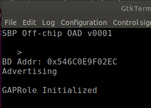

5. Power cycled the cc2640r2lp and it started advertising with scan response as "SBP OAD APP v0001".
DOWNLOADER SIDE::
1. Flashed the host_tool project onto another cc2640r2lp.
2. Opened bTool, did a scan and was able to detect the target cc2640 and connected with it.
3. Now, I moved to the OAD tab in the btool and selected the simple_peripheral_cc2640r2lp_oad_offchip_app-->FlashROM- ->simple_peripheral_cc2640r2lp_oad_offchip_app_FlashROM_oad.bin.
After doing the above, I get an invalid Image Metadata as shown in the snap shown below.
Then I clicked Add Metadata and got below response but image type is still unknown.
----------Tried a couple of more things without much luck--------------
After some researching online, I noticed that the post-build configuration for "bim_oad_offchip_cc2640r2lp_app" to use the oad_image_tool was missing as shown below:
Then I included the following line in the post-build steps:
/home/vinaydivakar/ti/simplelink_cc2640r2_sdk_2_40_00_32/tools/blestack/oad/oad_image_tool -h
Then I cleaned and rebuild the "bim_oad_offchip_cc2640r2lp_app" project and got the following output in the console based on which I have a few questions:
usage: oad_image_tool [-h] [-v] [-verbose] [-hex1 HEXPATH1] [-bdf BDFILEPATH]

My questions are:
1. For [-hex1 HEXPATH1] arguement, which hex file should I include, is it "bim_oad_offchip_cc2640r2lp_app.hex" generated in the /bim_oad_offchip_cc2640r2lp_app/FlashOnly directory?
2. Where can I find files for [-hex2 HEXPATH2] and [-k [KEYFILE]?

    Thank you for your reply.
    I referred to the "section of the chapter" to set up the BLE OAD Environment (All projects selected for FlashROM unsecure). The target boots properly and starts advertising as shown below:
    After the above, I followed instructions for setting up the distributor using the btool. In the btool, when I select the *_oad.bin file, I still get the invalid image metadata issue. This is straight out of the box example and I am unable to get it to work. Below shows the image of the invalid error.
    Then I tried adding the metadata via the btool and manually changing the Image type field to 01 and got all valid fields. Then did a write image file and read it back as shown below.
    Then I get OAD Download Not Successful. This is an example project and I wonder why it's not working? Please guide me on this. I have also attached the btool log file for reference.

    [21] : <Info> - 11:16:24.692
    OAD Send Configuration Info To Image Identify
    [22] : <Rx> - 11:16:24.690
    -Type           : 0x04 (Event)
    -EventCode      : 0x00FF (HCI_LE_ExtEvent)
    -Data Length    : 0x06 (6) bytes(s)
     Event          : 0x0505 (1285) (ATT_FindInfoRsp)
     Status         : 0x1A (26) (The Procedure Is Completed)
     ConnHandle     : 0x0000 (0)
     PduLen         : 0x00 (0)
    Dump(Rx):
    0000:04 FF 06 05 05 1A 00 00 00                      .........

    [34] : <Info> - 11:16:25.324
    OAD - Restore Connection Settings
    [35] : <Error> - 11:16:25.330
