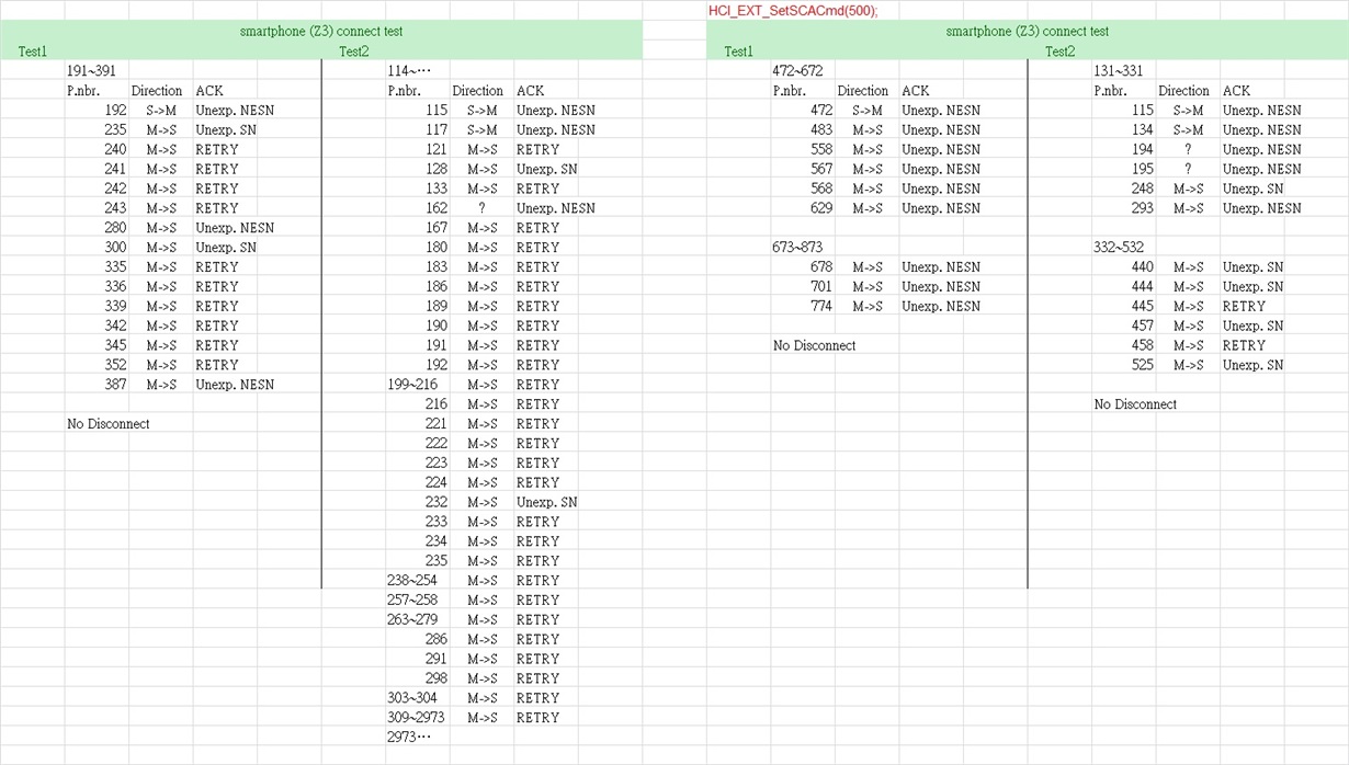

  • Hi Aslak,
    Test 1 and Test 2 are the results of two consecutive tests.
    Coincidentally, there are just two possible situations:
    1. A little unstable
    2. Continuous RETRY and then disconnected
    Test result table (another launchpad & SDK 3.10 & another phone (Sony Z3)) :
    No SetSCA vs SetSCA
    After adding "HCI_EXT_SetSCACmd(500);" , ACK status is more stable them before.
    So the question is, is the sleep clock crystal inaccurate?
    Many thanks, Gary
