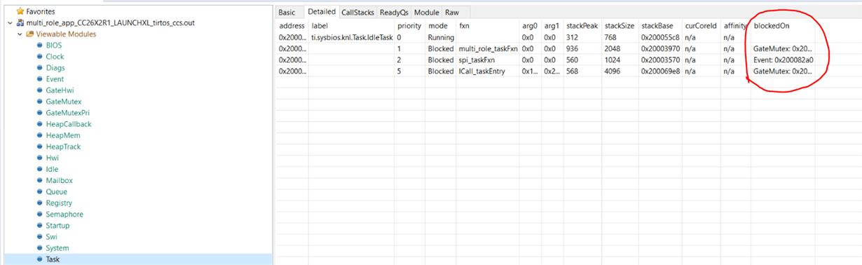

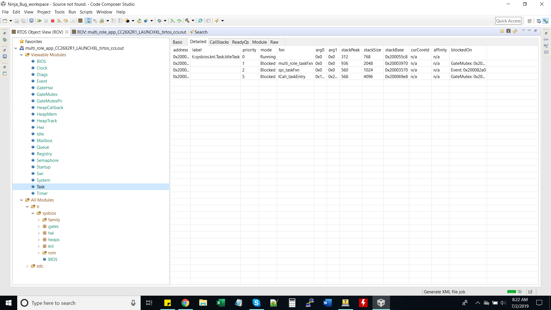

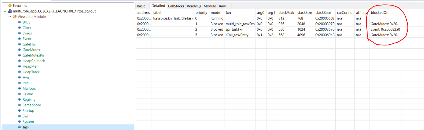

    But I did see the following in the Tasks tab in ROV . Actually, I think that the tasks should get blocked on EVENTs. But it appears the multirole task and Icall tasks are gettting blocked on GateMutexes.  Could that indicate anything related to the issue?
    I have not used any GateMutexes in the Application. I have used Semaphores.
    Shyam

    It mentions of HeapMem using a Gatemutex by default. I do use mallocs in my application code. So could it be that an malloc is getting stuck or something ?
    Since the tasks do show being blocked on GateMutex.
    If so, why would it happen randomly out of the blue and what would be a solution to it ?

    Please do provide some solution to this issue. With all due respect, the past two weeks we have been discussing the same things over and over again. This is just not getting anywhere.
    I mean the GapAdv_enable works fine but at some point it just causes an icall timeout since it does not return. What could be the possible reasons for this to happen all of a sudden. The code follows the same execution and nothing else all the while ( like I mentioned in the last post). Nothing changes anytime during the execution and then why would advertising fail all of a sudden?
    Kindly provide some progress on this rather than suggesting the same thing over again. A reply a day is great but I believe things are not moving forward.
    Now, can this be identified as a ble stack issue and that the only resolution/workaround is to just do a watchdog reset.
    The code basically goes to passive scan  in coded_phy in the beginning, then when a timer of 250ms triggers it goes to advertise a 68 byte buffer, then at gap_evt_adv_end the advertisingn is disabled and at gap_evt_adv_end_after_disable the scan is enabled back again. This flow goes on continuously.
    Shyam

  • Hello All,
    So I had assumed that the issue was fixed with the corrections mentioned in my previous post. But it seems I was able to recreate the issue again.
    When I had made the corrections from the previous post, I had also included a Display_printf to uart into the beginning of that function. Then it ran successfully for over 26 hours. Then I had removed that printf since I had put it there for purely debugging purposes. Now the issue of the ICALL TIMEOUT is back again. Now, this has to be some timing issue with the ICall msgs being put into the queue in the icall_direct api, shouldn't it ?
    Also there was the issue where the code execution just halted, with not even the Watchdog timer getting triggered. I have put it up as another post, assuming that it is a completely different issue.
    Shyam
