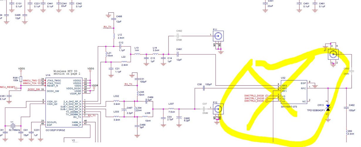

  • I did try changing the PINS to make peripherals like LEDs to work.
    I'm not able to make BLE Transmissions and the only difference on my board is that I'm not using the RD Switch , instead I have 2.4GHz from pin 1&2 with the balun connected to an antenna. Basically, instead of the RF Switch Ive got the antenna. attaching pic below for reference.
    Any help will be appreciated.

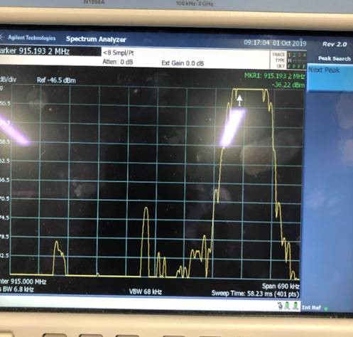

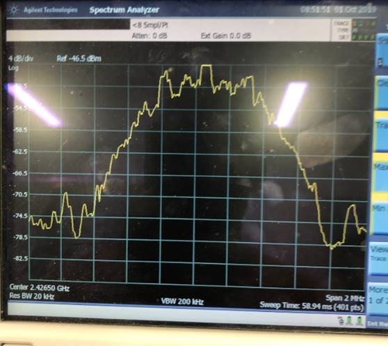

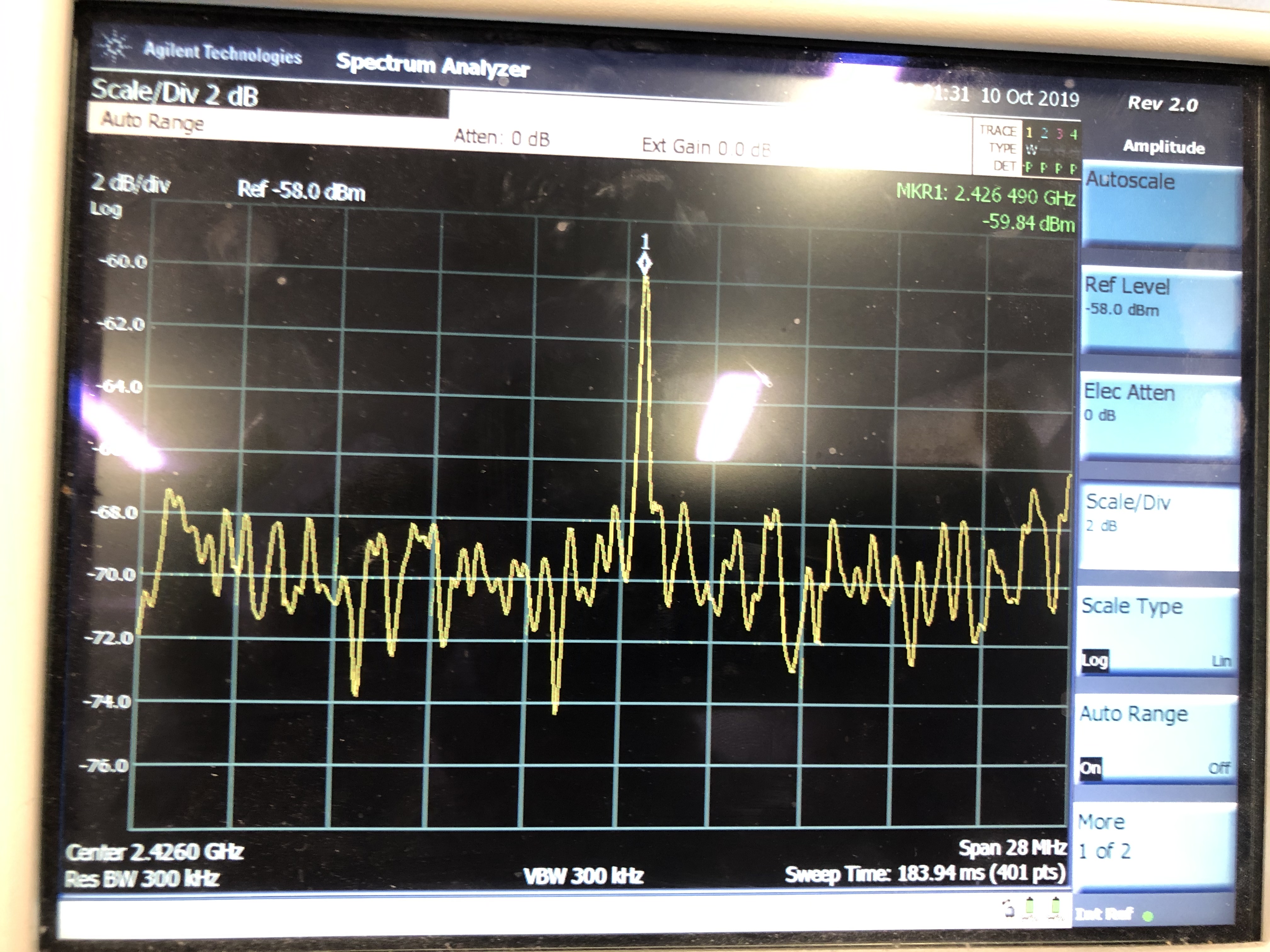

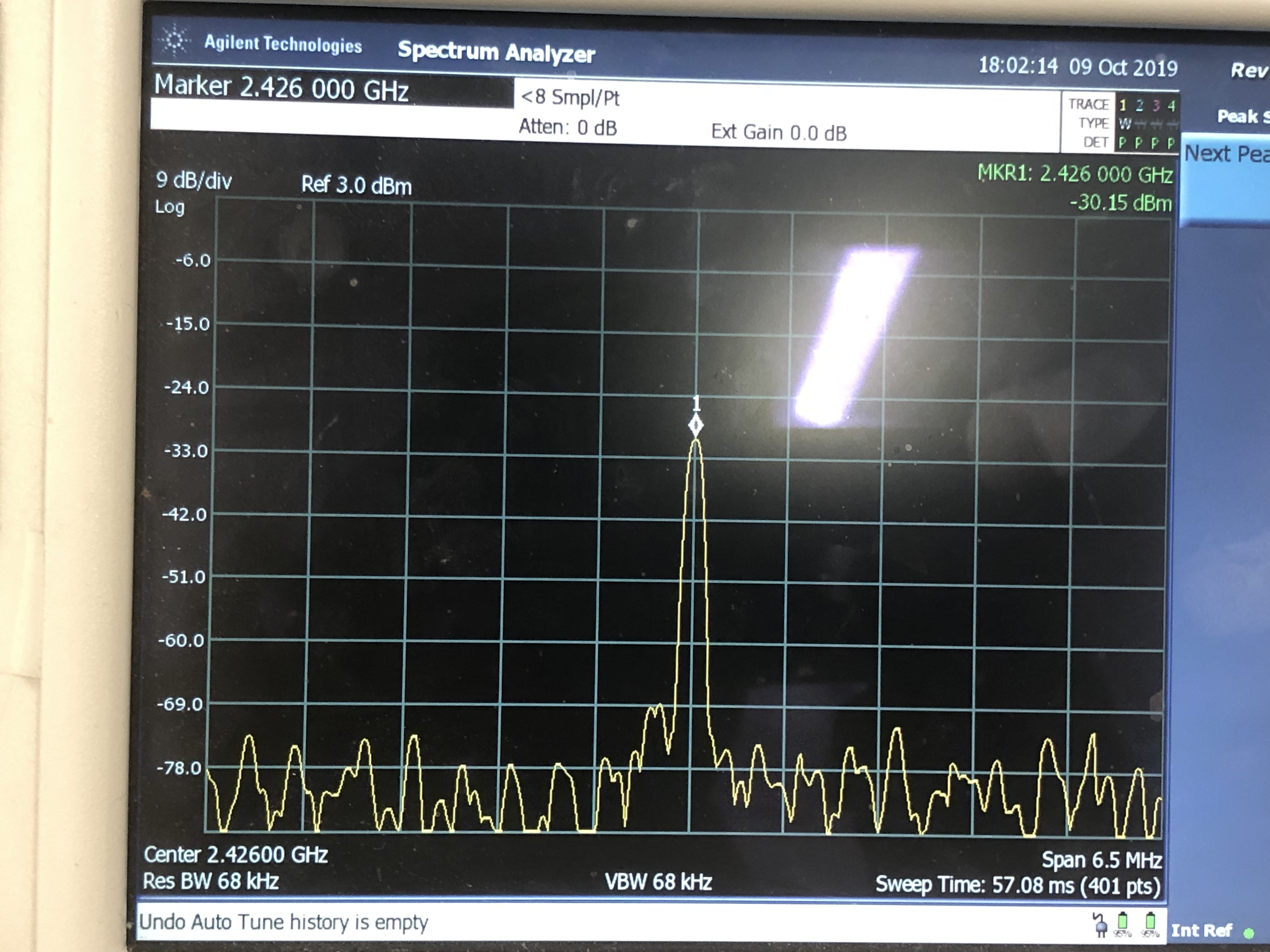

  • Hello Fredrik,
    I'm attaching the spectrum analyzer results below:-
    FOR BLE , its centered at 2.426GHz
    In the case of Sub 1GHz, its centered at 915MHz
    From the spectrum analyzer results, it doesn't seem like there is a frequency offset,. Any other suggestions that I can look into Fredrik?
    Kindly help me out.
  • Attached Sub 1GHz results:-
  • Hi Sanjay,
    You need to measure using a unmodulated signal so you look at the carrier only. You also need to turn down the input gain so you can see the peak of your signal.
    Fredrik

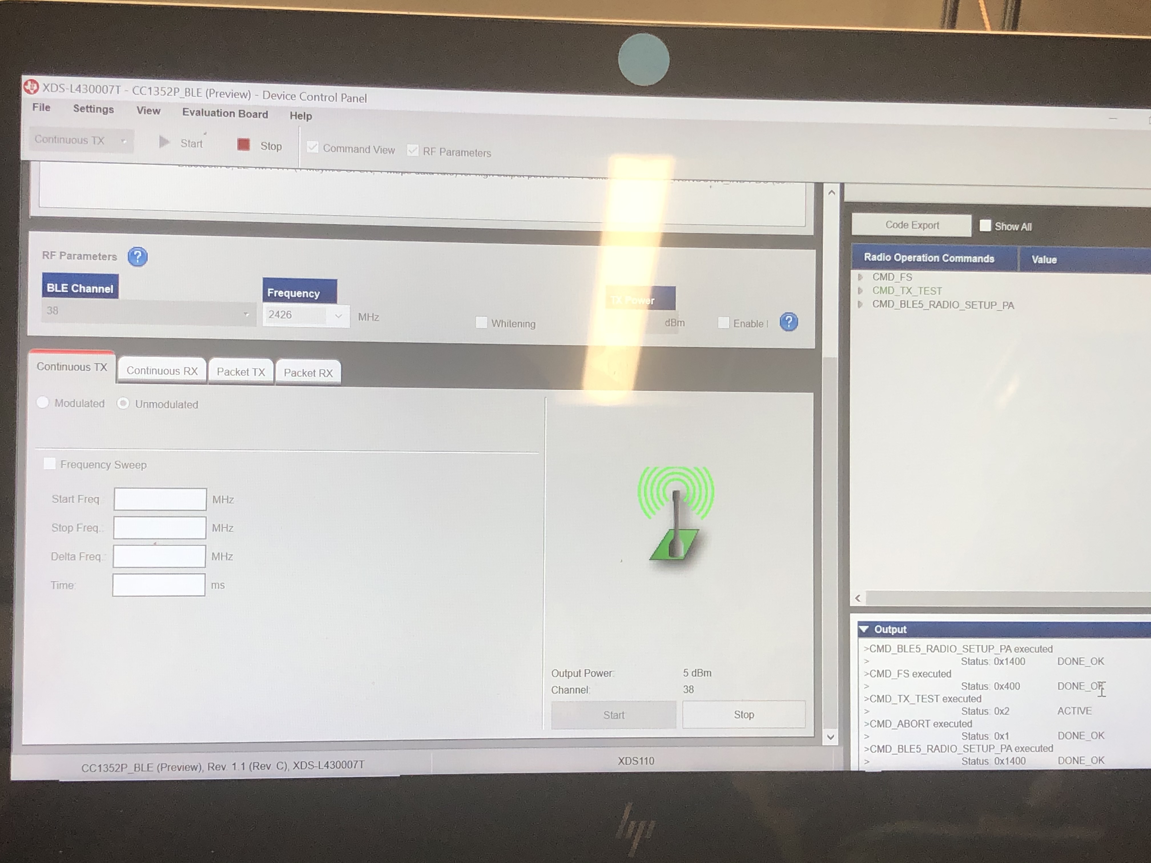

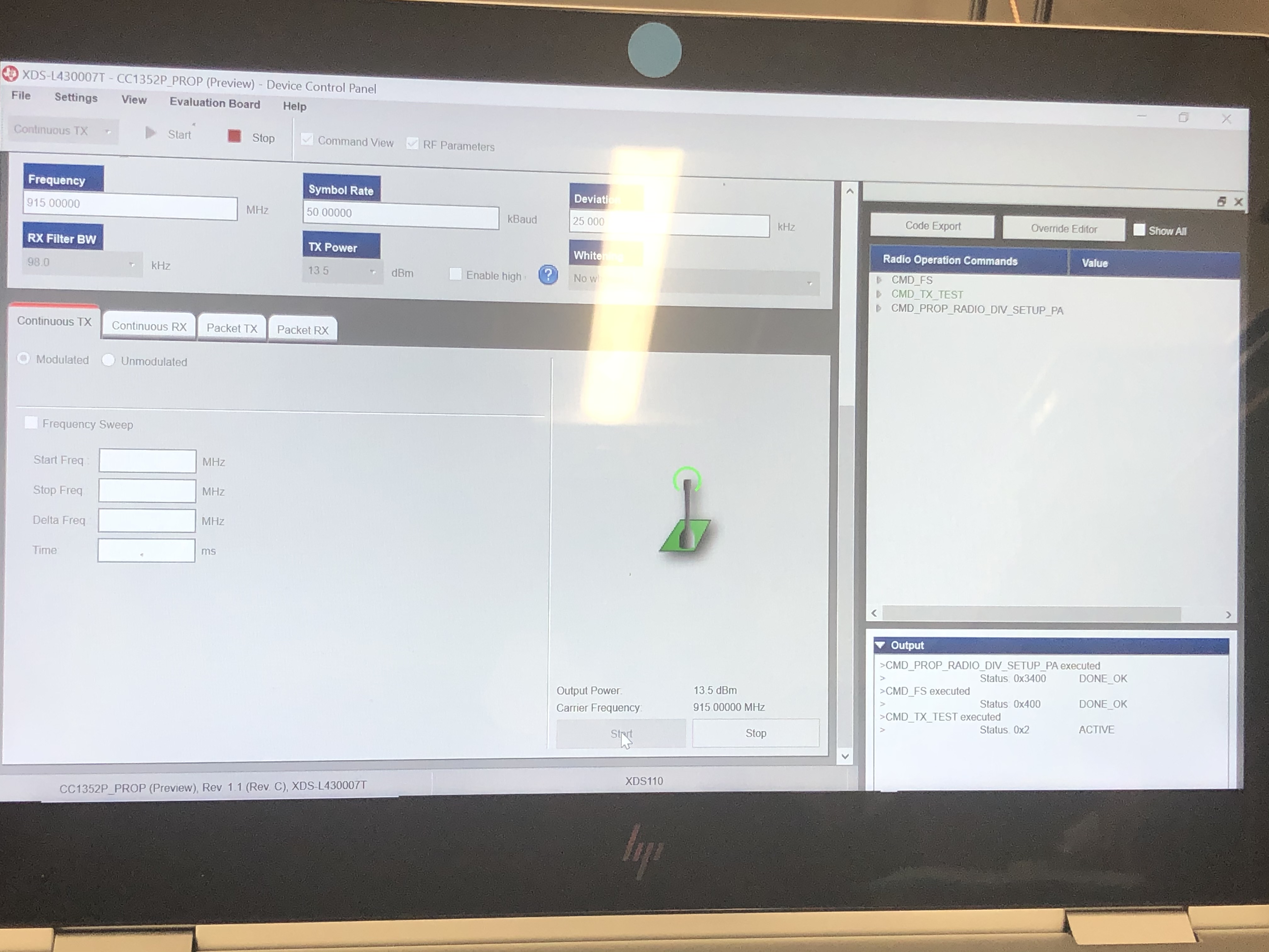

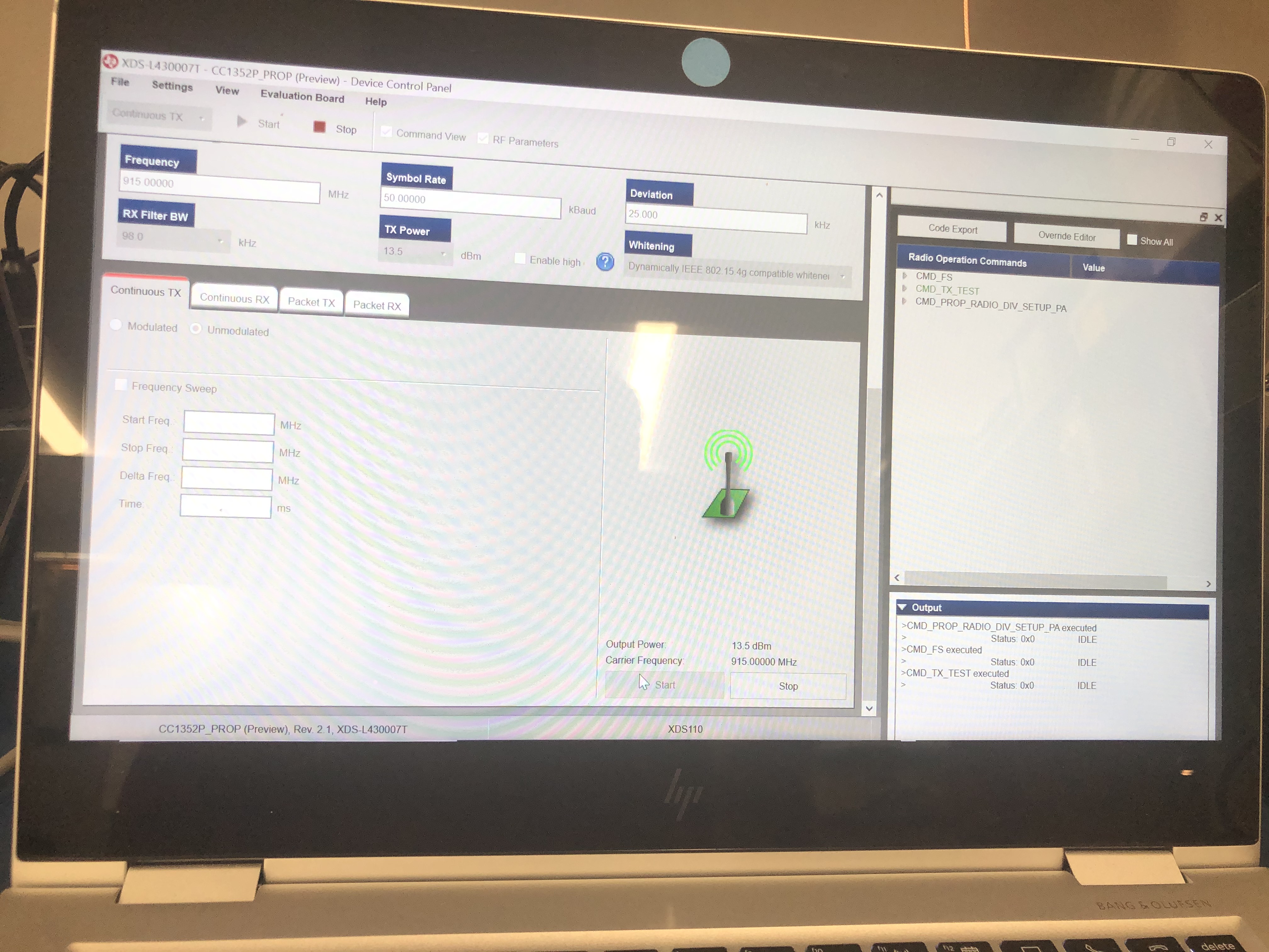

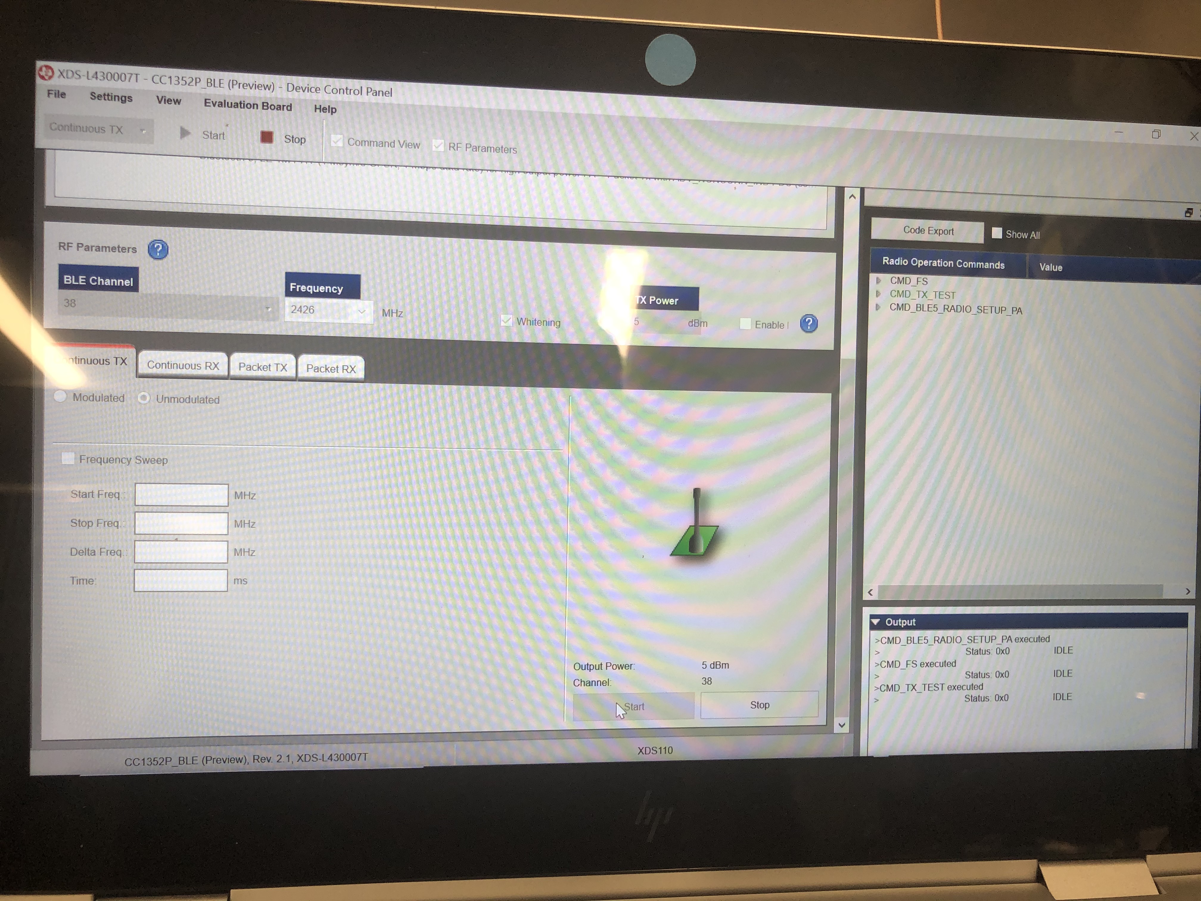

  • I used Smart RF Studio to make CW Transmissions.
    1) Attached below are the results from a CC1352P Launchpad.
    Sub 1 GHz:-
    BLE
    I could also see the test status showing ACTIVE in both cases
    2) ON interfacing the Chip on the Custom board using JTAG connected to the XDS 110 OUT pins of the launchpad with jumper pins disconnected,  to use with Smart RF Studio there was no Transmissions seen.
    The status on the Smart RF Studio shows Status INACTIVE
    Sub 1 GHZ
    BLE
  • Hi Sanjay,
    That looks like an old version of SmartRF Studio. Can you try the latest version?
    Fredrik

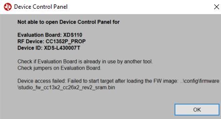

  • Hello Fredrik,

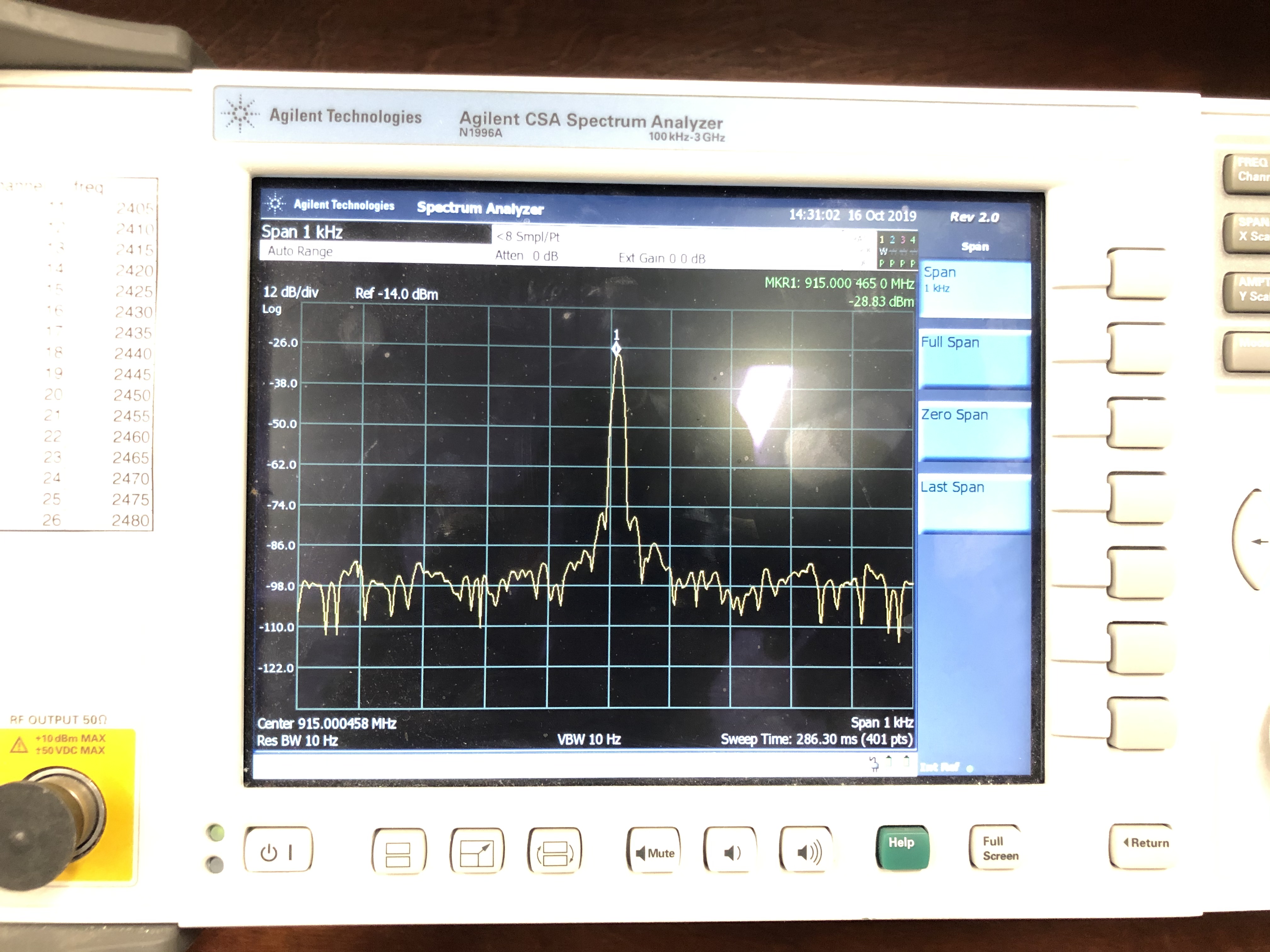

    Thanks for the help .  An update to the SmartRF Studio solved the issue.  I was able to use Smart RF Studio as Continuous Tx and Continuous  RX to verify feasibility of my board for both BLE  & Sub 1 GHz.

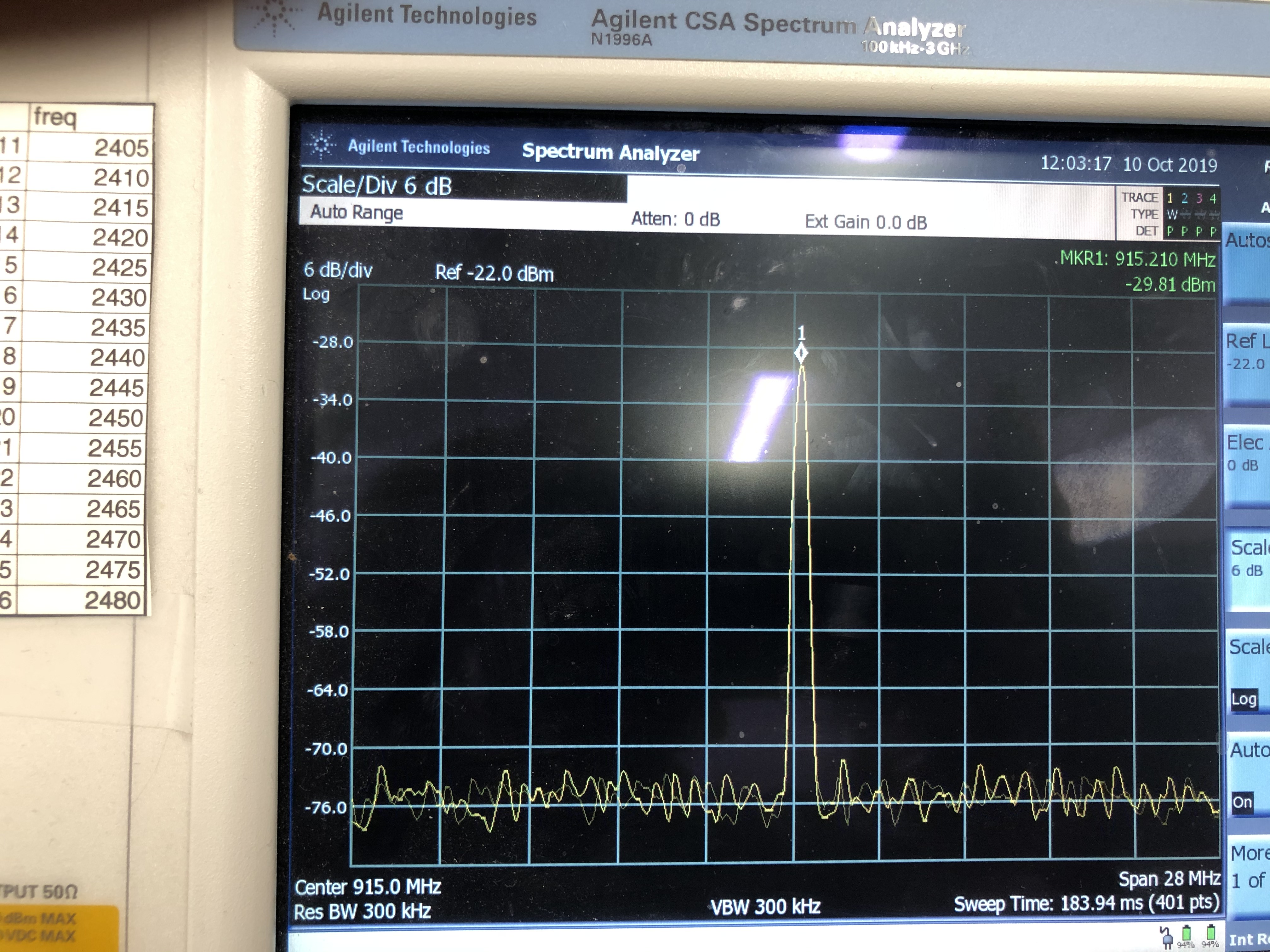

    Spectrum Analyzer results attached below:-
    However, I was trying to do a packet TX/RX operation and I had difficulty in receiving packets being transmitted using Smart RF studio . Any suggestions here to fix this ?
    And one of the Launchpads that was working earlier with the older version of SmartRF Studio shows the below error now:-
    Kindly help me out, and I apologise for the delayed response.
  • Hi Sanjay,
    You should reduce the frequency span on the spectrum analyzer to confirm, but it looks like you have a frequency offset of 200 ppm. This is very large and explains why you are not able to communicate with you board.
    You need to configure the load capacitance for the crystal as described in this application note: www.ti.com/lit/pdf/swra640
    The LaunchPad that does not work with latest SmartRF Studio is probably using the engineering version of the IC which is no longer supported.
    Fredrik

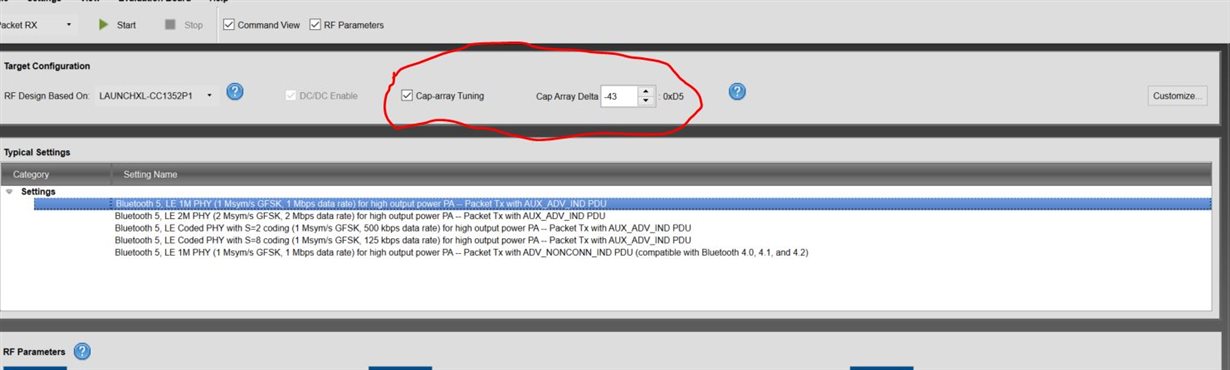

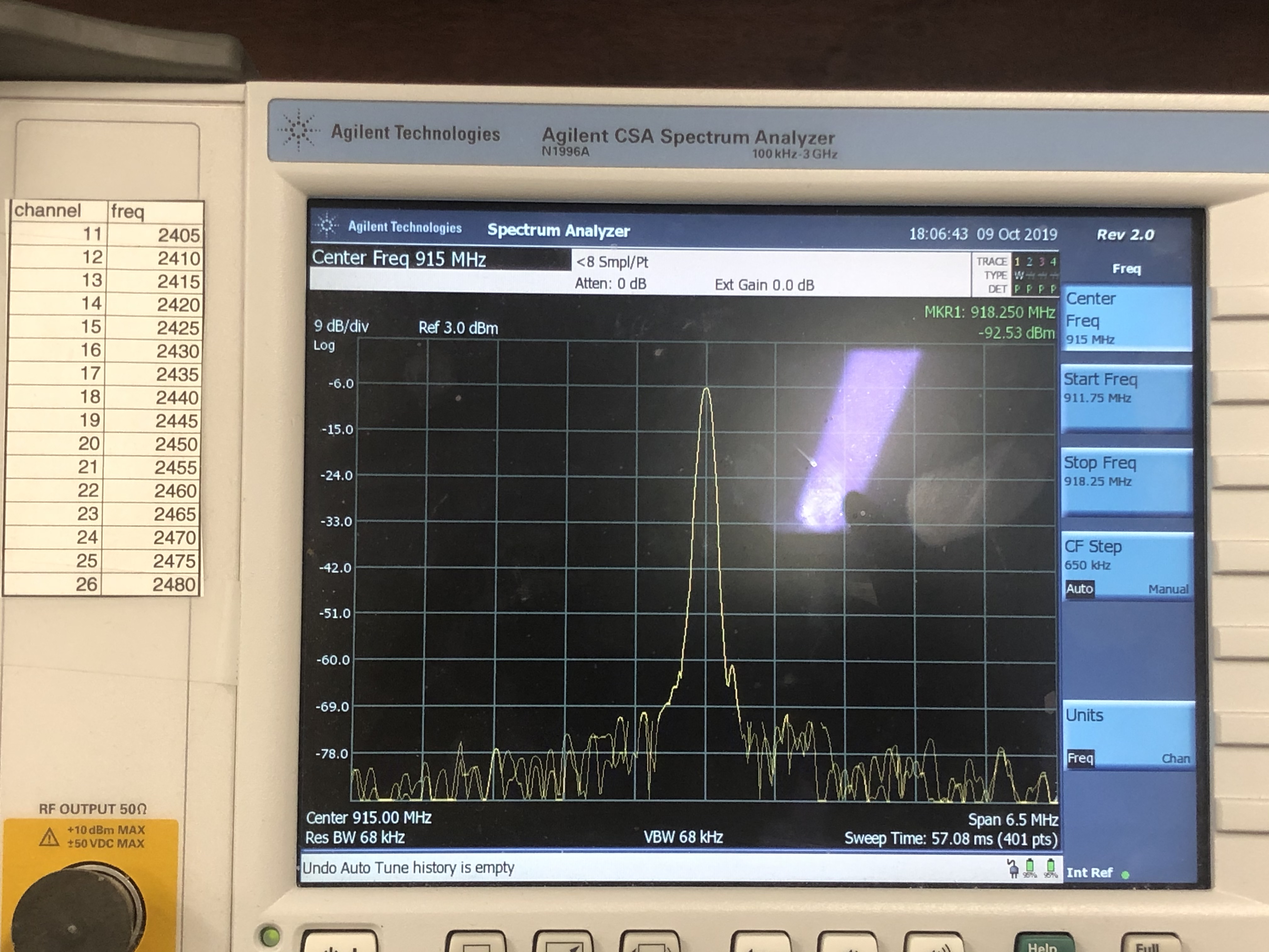

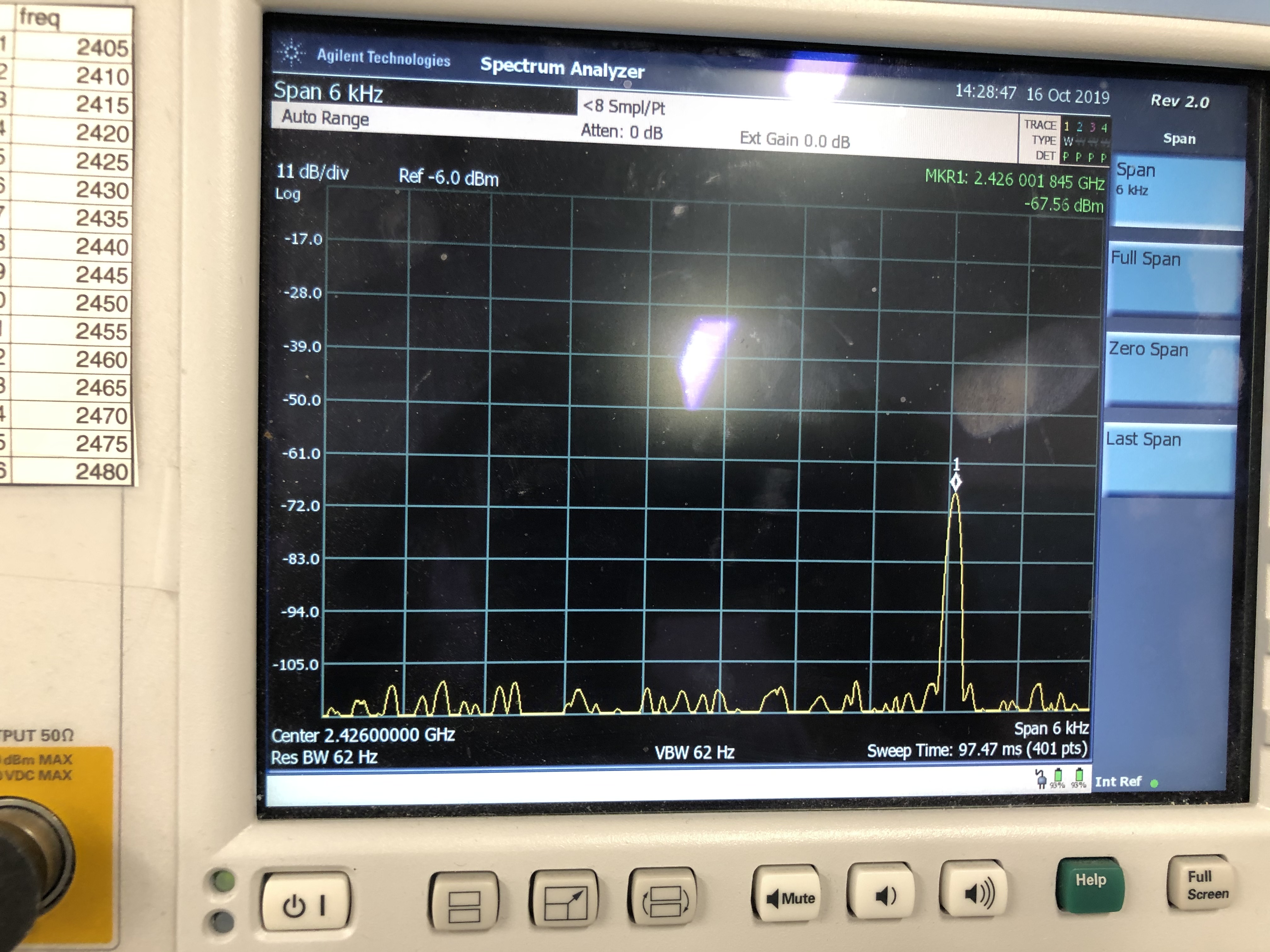

  • Hello Fredrik,
    Thank you for your patience.
    You're right with the cap-array tuning. The default that showed up for the CC1352P was around -43, and as per the document the default is around 6.7pF.  I just wanted to confirm with you if the default value will be '0' which is 6.7pF or -43 as seen in Smart RF studio.
    I did look into the same for a CC2642R and the default calue is '0' which is 6.7pF.
    In addition , I was able able to verify packet TX/RX too.
    Below are the snapshots of the spectrum analyzer for continuous TX , where Sub 1GHZ is at 915 MHz and BLE is at (channel 38) 2.426 GHz
    . I did reduce the span too.
  • Hi Sanjay,
    That looks a lot better!
    The default value for CC1352P is actually -43 which means that the cap-array is disabled. This is true both in SmartRF Studio and in the SW examples. The reason is due to what is explained in footnote 3 in the 48 MHz crystal oscillator section in the datasheet as well as advisory Radio_01 in the errata. The CC1352P LaunchPads do thus come with external load capacitors mounted.
    For you custom HW, you can use the internal cap-array if the errata advisory is not a concern for your application, but in that case you have to enable the cap-array as you did in SmartRF Studio also in CCFG.c.
    Fredrik
