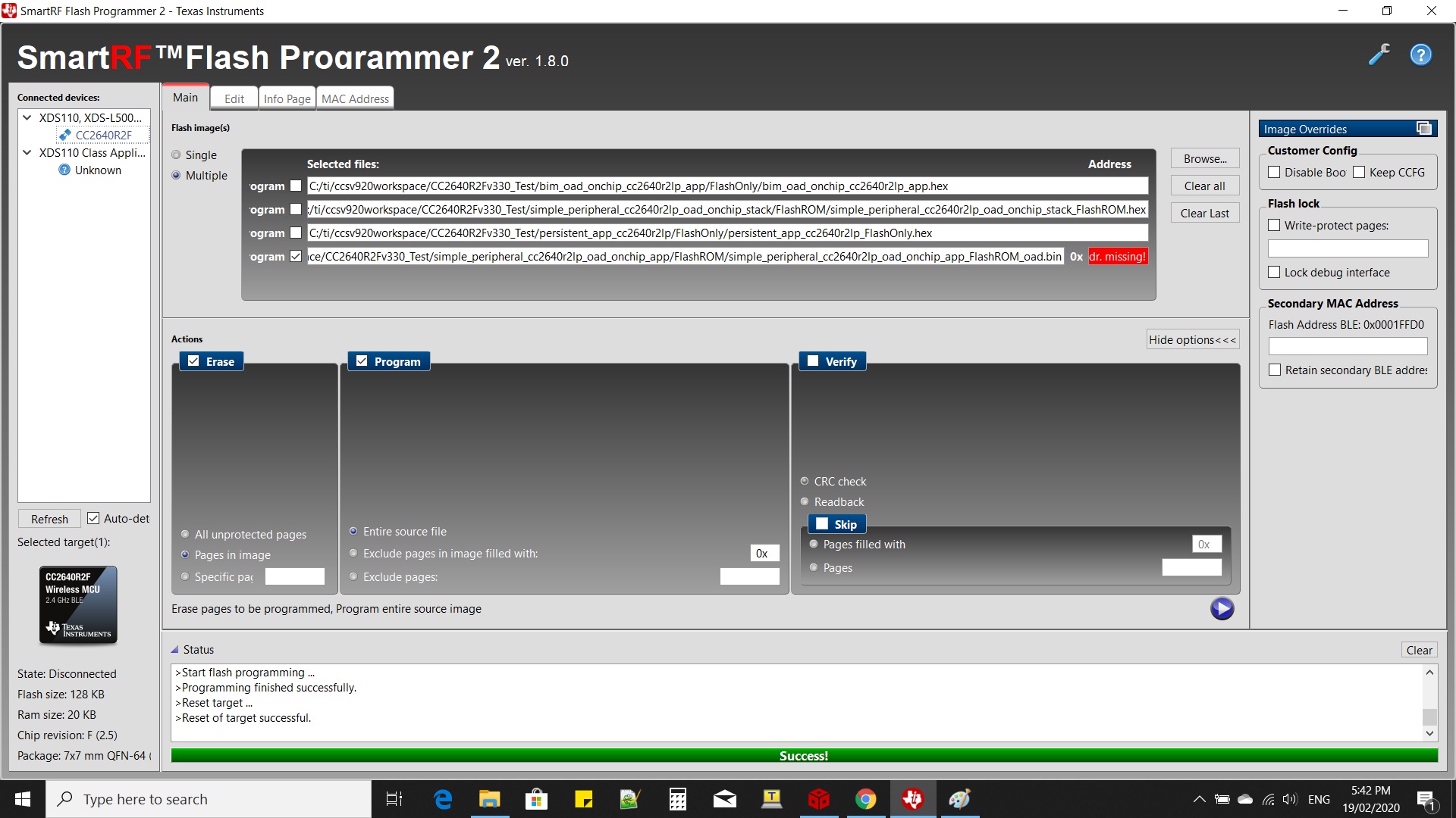

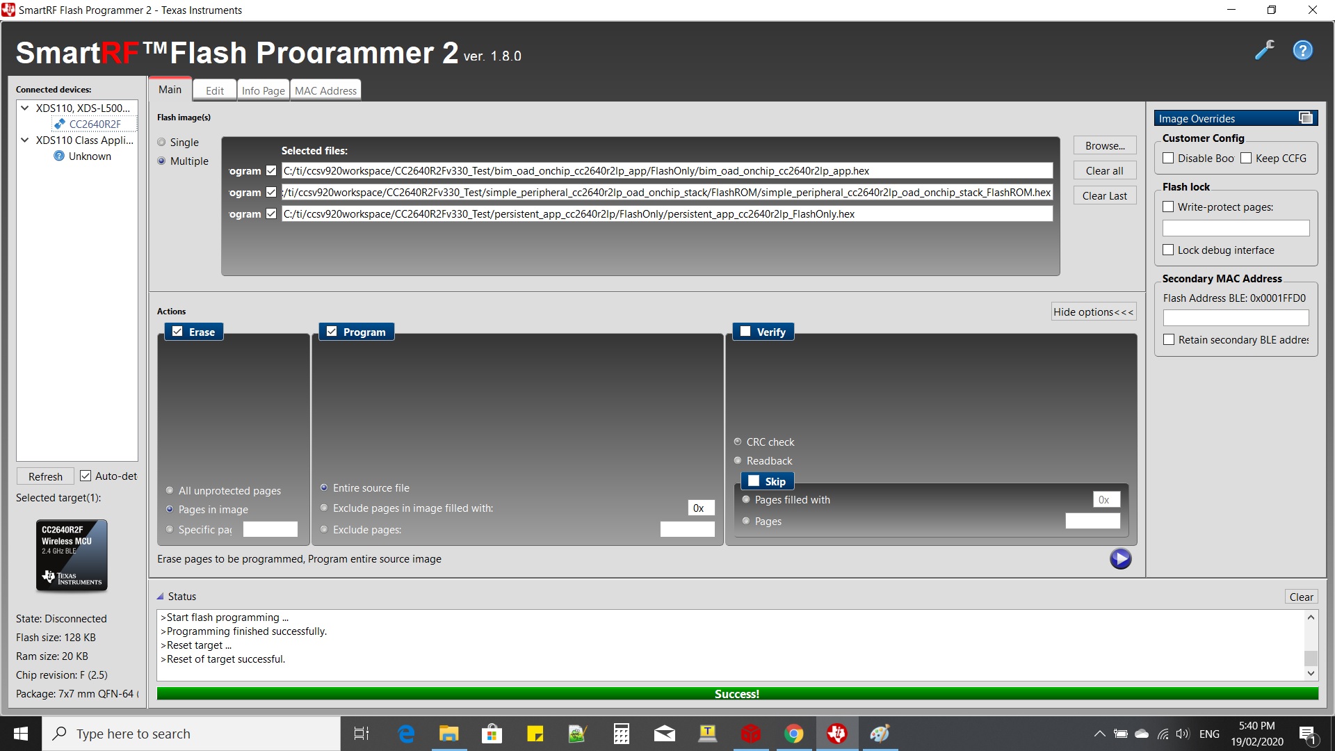

    1. Import the Simple Peripheral On-Chip OAD Example Program. There should BIM, STACK, PERSISTENT APP, AND MAIN APP.
    2. Enable hex generation to the 4 CCS Projects. Rebuild all to generate the hex files and bin file for MAIN APP.
    3. Using SmartRF Flash Programmer 2 1.8.0, select the hex files in the order of BIM, STACK, PERSITENT APP hex file as shown in the screenshot 1. After flashing the hex files you would see at your smart phone OAD Persitent App advertising.
    4. Deselect the BIM, STACK, and PERSISTENT APP at SmartRF Flash Programmer 2. Select the bin file of simple peripheral on chip oad app as shown in screenshot 2. After you flash the bin file you will see at your smartphone SBP OAD on-chip advertising.

    Make sure you set the correct options at SmartRF Flash Programmer 2. Erase -> Pages in Range, Program -> Entire Source File. I am using on chip oad example program from SDKv3.30

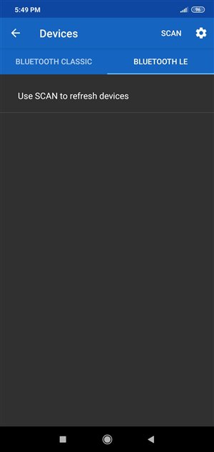

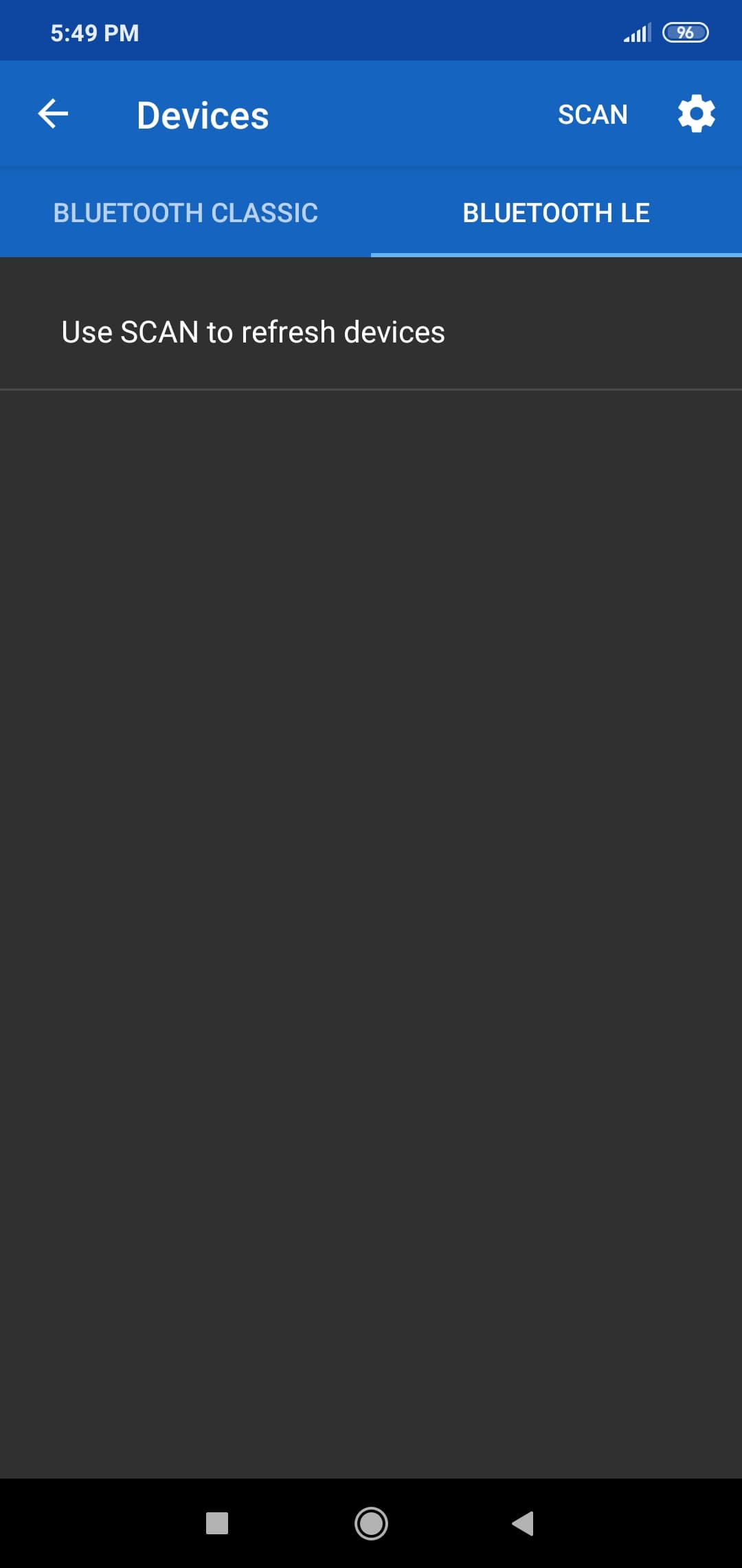

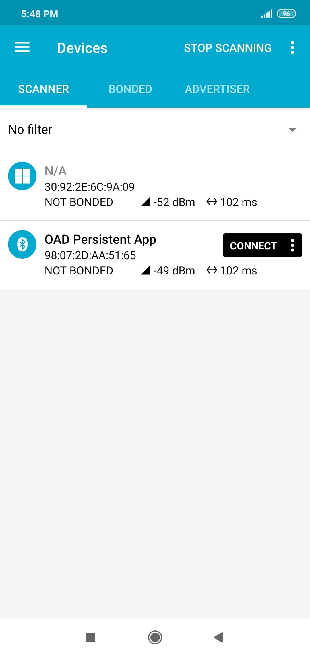

  • M S2
    I told you to use nrF Connect App and IOS Lightblue App. The Serial Bluetooth Terminal App does not work.
    Step 3:
    Step 4:
    Using Serial Bluetooth Terminal no device is shown:
  • I tried with nRF too. But it didn't show it.

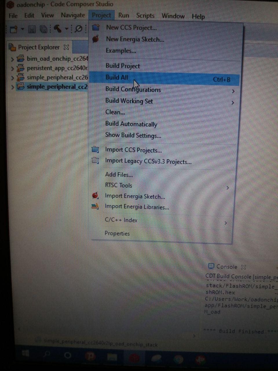

  • When you rebuild the CCS project do you go to properties and rebuild? Are you using SmartRF Flash Programmer 1.8.0? The version 1.8.1 has issues.
  • Yes my flash programmer 2 version is 1.8.0
    I rebuild all in this way:

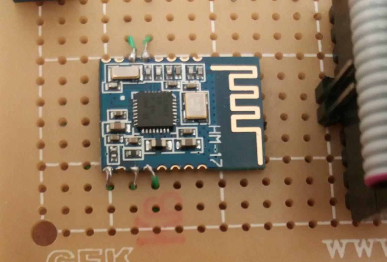

    1. What name does it have in BLE scan list?
    2. What address should I write in flash programmer? IT says "address missing"
    3. I am not using launchpad. I am using HM-17. Which is just the module. here is the picture:
     "SBP OAD APP v001" will be shown at nRF Connect. I suggest you make it work first with the Launchpad. Then make it work with HM-17.
    -kel

  • Hi M S2,
    The example programs are meant to work for the Launchpad. The simple peripheral will work with your board by commenting out the pin initialization at BoardGpioInitTable[]. That is assuming that your board is working.
    const PIN_Config BoardGpioInitTable[] = {
        //CC2640R2_LAUNCHXL_PIN_RLED | PIN_GPIO_OUTPUT_EN | PIN_GPIO_LOW | PIN_PUSHPULL | PIN_DRVSTR_MAX,       /* LED initially off */
        //CC2640R2_LAUNCHXL_PIN_GLED | PIN_GPIO_OUTPUT_EN | PIN_GPIO_LOW | PIN_PUSHPULL | PIN_DRVSTR_MAX,       /* LED initially off */
        //CC2640R2_LAUNCHXL_PIN_BTN1 | PIN_INPUT_EN | PIN_PULLUP | PIN_IRQ_BOTHEDGES | PIN_HYSTERESIS,          /* Button is active low */
        //CC2640R2_LAUNCHXL_PIN_BTN2 | PIN_INPUT_EN | PIN_PULLUP | PIN_IRQ_BOTHEDGES | PIN_HYSTERESIS,          /* Button is active low */
        //CC2640R2_LAUNCHXL_SPI_FLASH_CS | PIN_GPIO_OUTPUT_EN | PIN_GPIO_HIGH | PIN_PUSHPULL | PIN_DRVSTR_MIN,  /* External flash chip select */
        //CC2640R2_LAUNCHXL_UART_RX | PIN_INPUT_EN | PIN_PULLDOWN,                                              /* UART RX via debugger back channel */
        //CC2640R2_LAUNCHXL_UART_TX | PIN_GPIO_OUTPUT_EN | PIN_GPIO_LOW | PIN_PUSHPULL,                         /* UART TX via debugger back channel */
        //CC2640R2_LAUNCHXL_SPI0_MOSI | PIN_INPUT_EN | PIN_PULLDOWN,                                            /* SPI master out - slave in */
        //CC2640R2_LAUNCHXL_SPI0_MISO | PIN_INPUT_EN | PIN_PULLDOWN,                                            /* SPI master in - slave out */
        //CC2640R2_LAUNCHXL_SPI0_CLK | PIN_INPUT_EN | PIN_PULLDOWN,                                             /* SPI clock */
        PIN_TERMINATE
  • Hi
    Thank you for your reply
    I commented some other lines too and simple peripheral example worked. Then I tried to do it in OAD on-chip example and struggled with it but it didn't work. OAD code is a strange!
