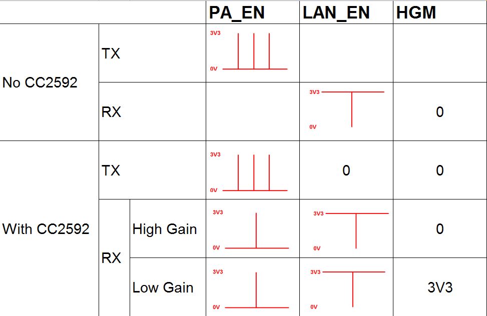

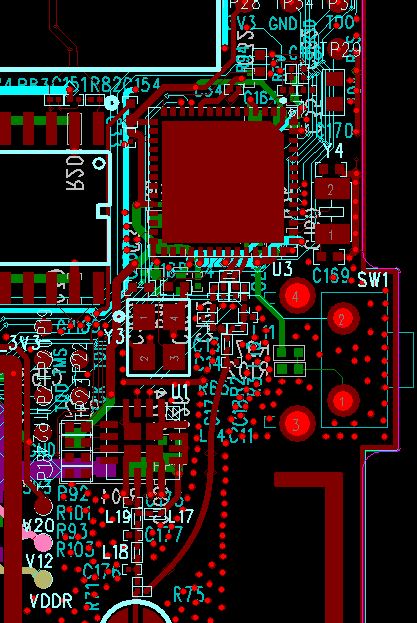

I have some appliance problem with CC2538 and CC2592.
1. Some boards can send packets, some boards can't. Measured by sniffer.
About the bad boards, after bypass CC2592, it becomes ok; or re-heat CC2592, it becomes ok at first, but tommorrow it can't send packets.

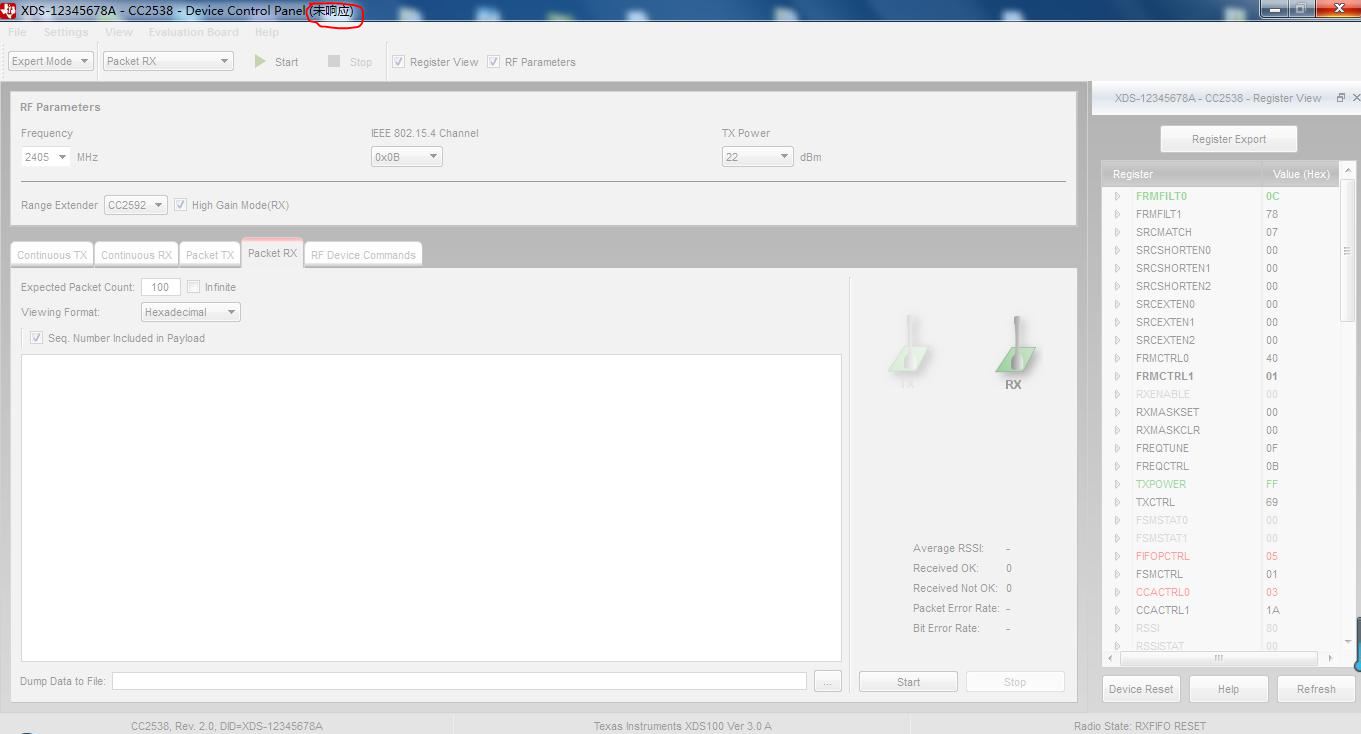

2. Control CC2538 with smartRF studio by J-TAG, once I used multimeter to measure the PA_EN, LNA_EN and HGM, the smartRF studio will get out control immediately.
And it will happens on all boards.
The attached file is schematic.
