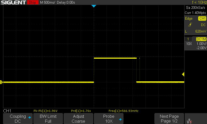

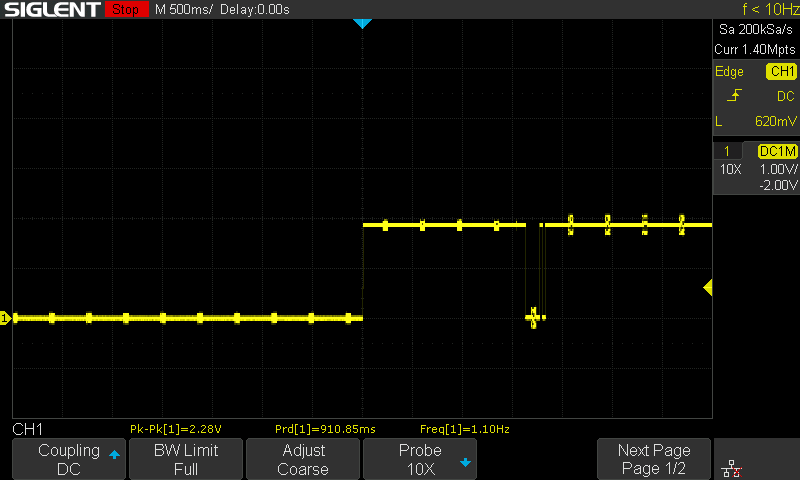

We’re seeing an issue where the TI CC2564C part won’t reset correctly by simply pulling nSHUTD low (tested with over 100ms held low). We’re following the guidelines in sec 5.8.1 in the datasheet. We’re running both VDD_IN and VDD_IO are running from the same 1.8V rail.
What we’re seeing is that the RTS signal is not behaving as expected. I’ve included shots showing the initial power on which shows RTS pulse low when BT nSHUTD goes high (approx. 1.5s after the trigger). The other shot shows what happens if nSHUTD is held low and then released while the 1.8V rail is still applied. We see RTS puls low, but then it does some toggle and stops high.
Any ideas what might be going on? Have you seen this behavior before?
