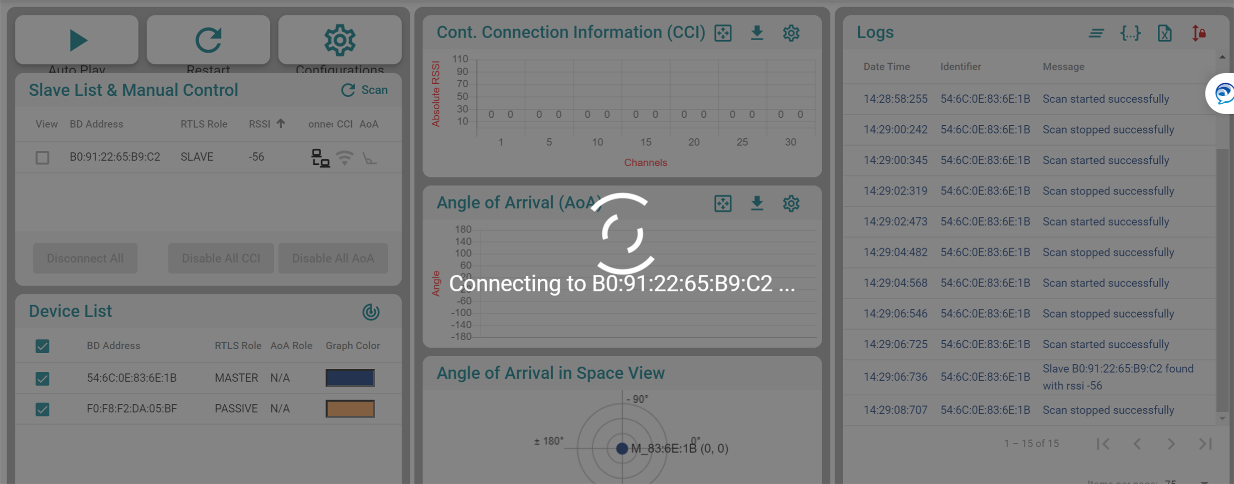

CC2640R2F: CC2640R2F AOA support
Part Number: CC2640R2F
I have been informed that CC2640R2F is not suitable for future AOA support, we should use CC26X2 instead. But is that mean the old SDK examples are not working already? Cause when i tested the AOA examples from CC2640R2F SDK 3.40, the rtls_ui showed: AOA support NO. And it would stuck at connecting to slave device after "Auto play".Please check the following figures:
The log from rtls_ui.exe is:
* Serving Flask app "rtls_ui" (lazy loading)

Scan process started
Scan process done
127.0.0.1 - - [09/Jul/2020 14:35:32] "POST /rtls-ui/api/scan HTTP/1.1" 200 -
127.0.0.1 - - [09/Jul/2020 14:35:32] "POST /rtls-ui/api/connection HTTP/1.1" 404 -
