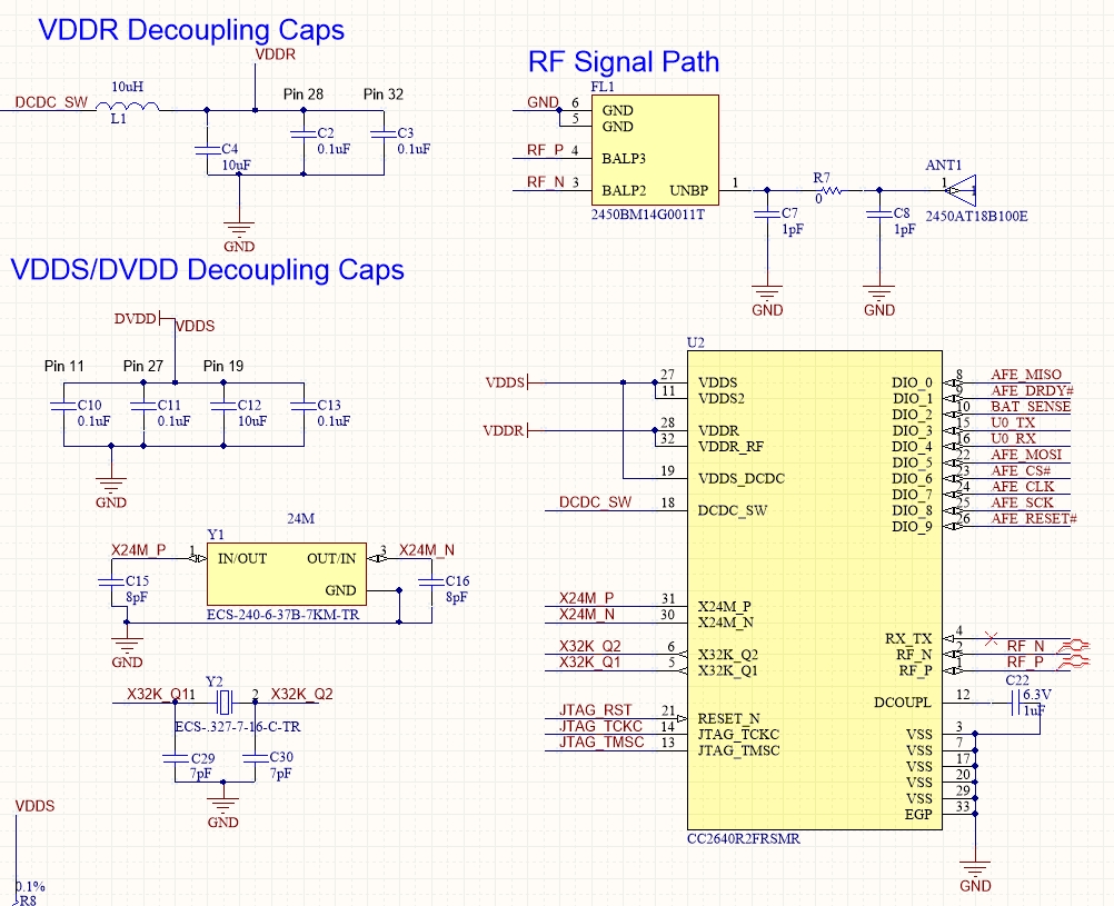

I use my own CC2640R2FRSM hardware. I refences https://dev.ti.com/tirex/content/simplelink_cc2640r2_sdk_2_30_00_28/docs/blestack/ble_user_guide/html/ble-stack-3.x/custom-hardware.html#configuring-device-parameters-for-custom-hardware to migrate process .
When I use the mobile phone to connect CC2640r2f , sometimes the connection is successful, and then it appears disconnection.
The mobile phone back code is 0x34 or 0x08.Can you help to check it?

Did you follow the CC13xx/CC26xx Hardware Configuration and PCB Design Considerations guidelines when designing your custom board?
Do you experience this issue when using a LaunchPad?
Can you provide sniffer logs for the failed and successful connection (if possible with the LaunchPad)?
