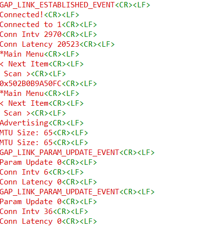

1.     Connection interval update call-back never received to application.
As per the suggestion, we have used "GAPROLE_LINK_PARAM_UPDATE_APP_DECIDES” to update the connection interval where application need to receive call back in the “GAP_UPDATE_LINK_PARAM_REQ_EVENT”.
But unfortunately I couldn’t receive this event at all. I was always getting just the “GAP_LINK_PARAM_UPDATE_EVENT”.
Could you please let me know when this event will triggered? (Like in LL_CONNECTION_UPDATE_IND etc).

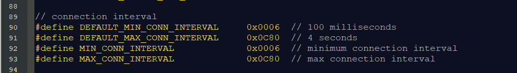

2.     Multiple defines related to connection interval and connection update intervals
There are multiple connection interval related parameters (like #defines and update structures).
As I can see there are multiple structures for connection parameter updates as in below files:
  1. multi_role.c - gapRole_updateConnParams_t updateParams
  2. multi.c - static gapRole_updateConnParams_t gapRole_updateConnParams
As I can understand “gapRole_updateConnParams” is only used in “gapRole_HandleParamUpdateNoSuccess” which will be called on the connection param update timeout.
Could you please let me know the uses of different structure and the use of timeout? In other cases (than the timeout) it will not use the param update enable to “GAPROLE_LINK_PARAM_UPDATE_APP_DECIDES”.?
Also there are some unused #defines in multi.c like “MIN_CONN_INTERVAL” and “MAX_CONN_INTERVAL”, even project compiles without them.
3.     Multirole project will automatically choose higher connection interval (above the defined).
As I observed, on connecting a two Mutirole devices will not do any transactions for “LL_CONNECTION_UPDATE_IND” (unless connection update option used).
In mult_role.c I have set the “DEFAULT_CONN_INT” to 55 (I guess unit is 55 ms). Other Multirole was flashed with DEFAULT_CONN_INT to 200 which is initiating the connection.
After the connection as observed, "connection interval" will be 250ms.
I was expecting it to be around 50 - 60.
4.     Multirole project connection interval param update value has no relevance with one set to GAP, while connecting with Android.
(Similar to above question 3).
I also observed the connection interval with the Android mobile phone.
But after the connection param update the value has been set to 36.
I was expecting it to be in the range of 55. (50 – 60)
Not sure why?
