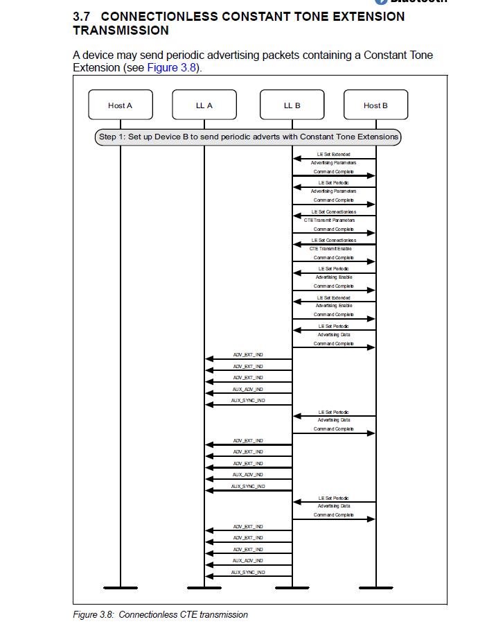

In the past weeks, I'd been testing with SimpleLink AoA examples (e.g. RTLS_passive, RTLS_master, RTLS_slave), noticed that these examples are connection-based, the passive nodes should do connection-monitoring, meanwhile, the connection could be lost in the monitoring period, we have to reset the passive node to re-monitor. My question is:
# I saw the connectionless CTE transmission procedure in the BT 5.1 spec, does TI plan to implement this and provide an example so that we don't have to handle the connection loss issue?
