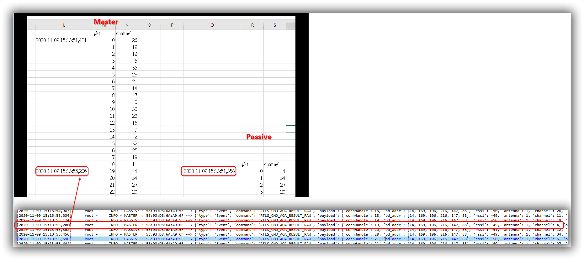

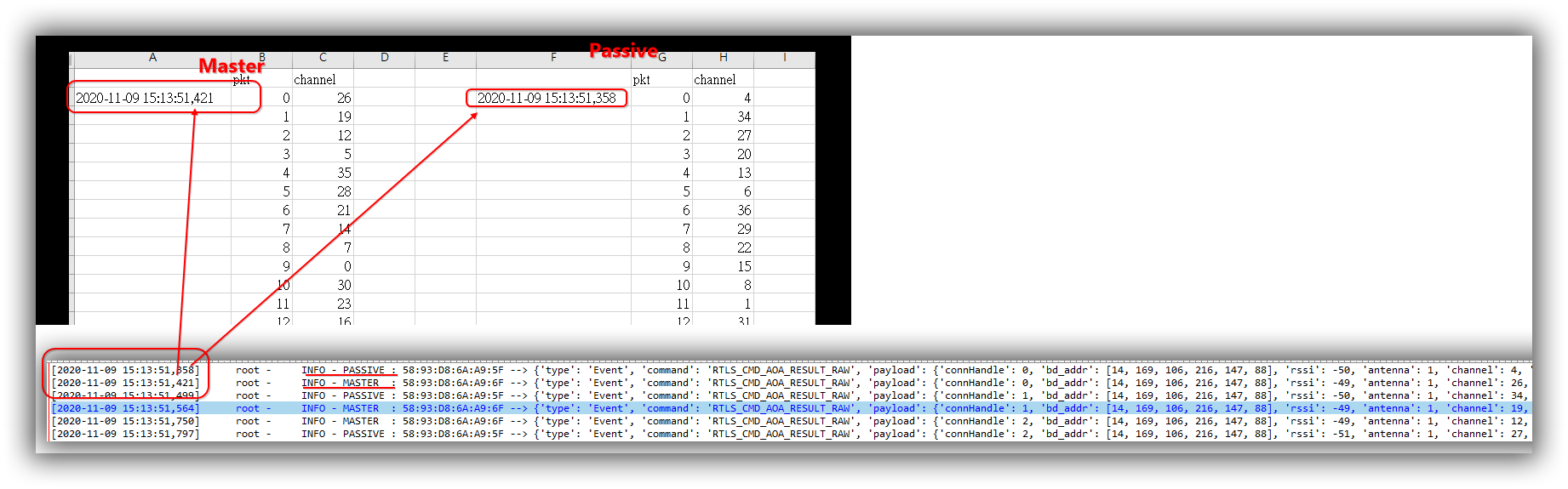

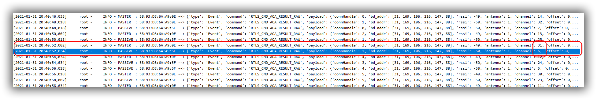

CCS/CC2652R: [RTLS]Master report time is not synchronized with Passive
Part Number: CC2652R

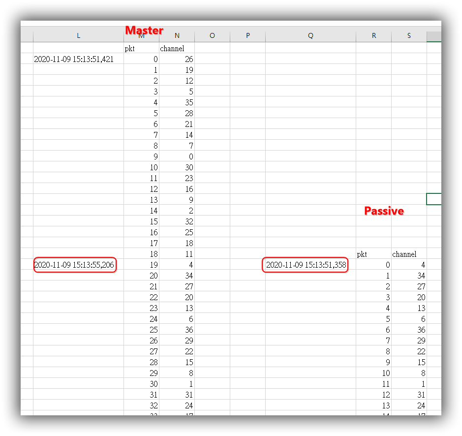

I'm confused whether to analyze the IQ result of M+P in terms of time synchronization or channel synchronization
python will generate IQ csv and log txt.  Log.txt contains the time stamp of each IQ data of Master and Passive.
If we take the time to align the package, the channel num of Master and Passive are not match
If we take the channel num to align the package, and assuming Passive catches up with Master on the 19th packet of Master (same channel)
Master's timestamp will be close to 4 seconds later than Passive's . But they should catch the same packet from Slave, The time stamp should be very close
Did I misunderstand something?

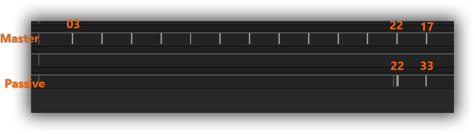

  • update picture
    Even change CTE interval to 2s, Master/Passive still report different channel in the same time

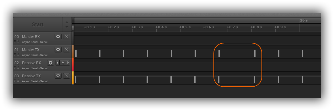

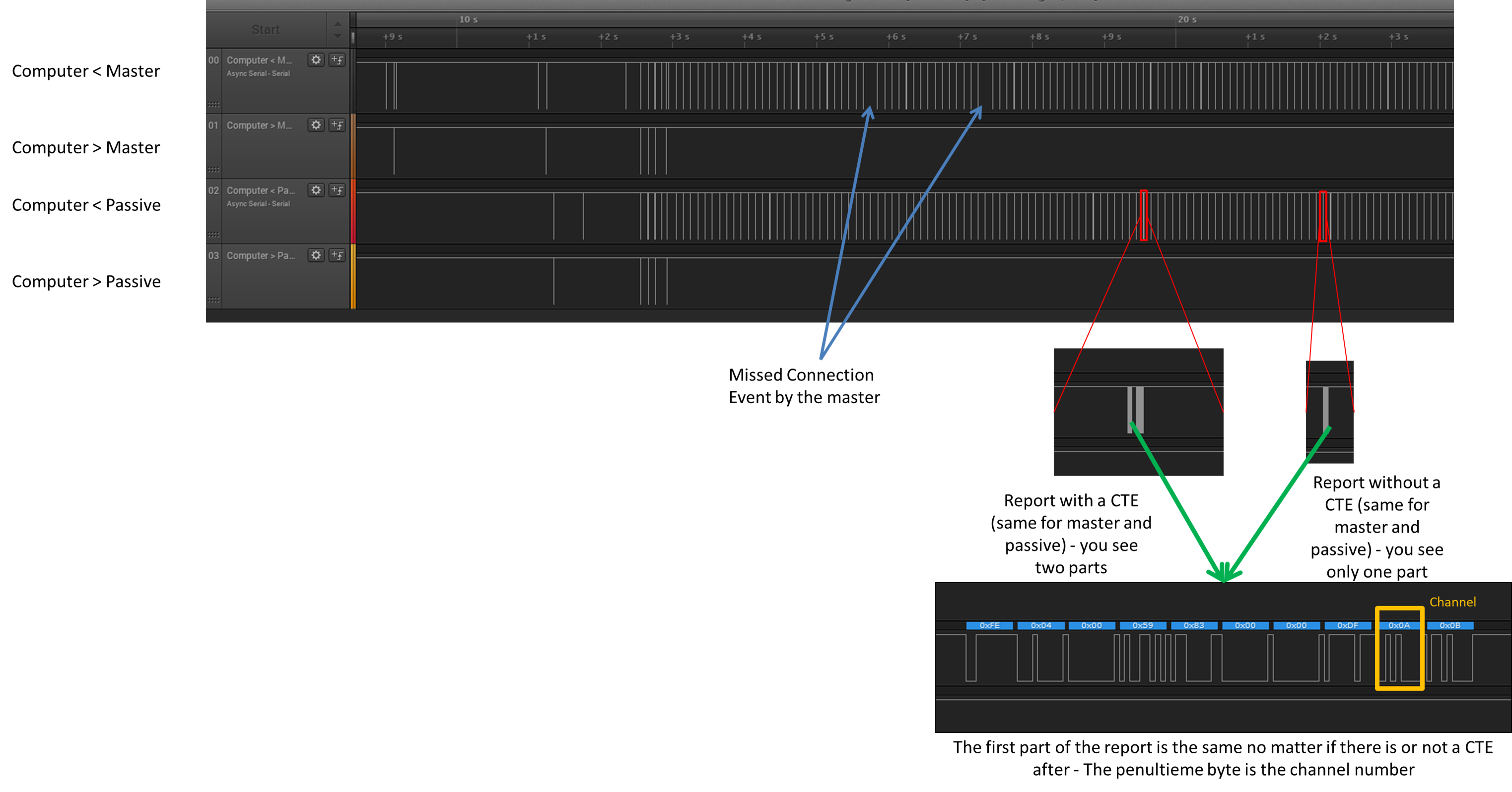

  • Hi Valery,
    I would suggest you to use a logic analyzer to directly see the sequence of the report.

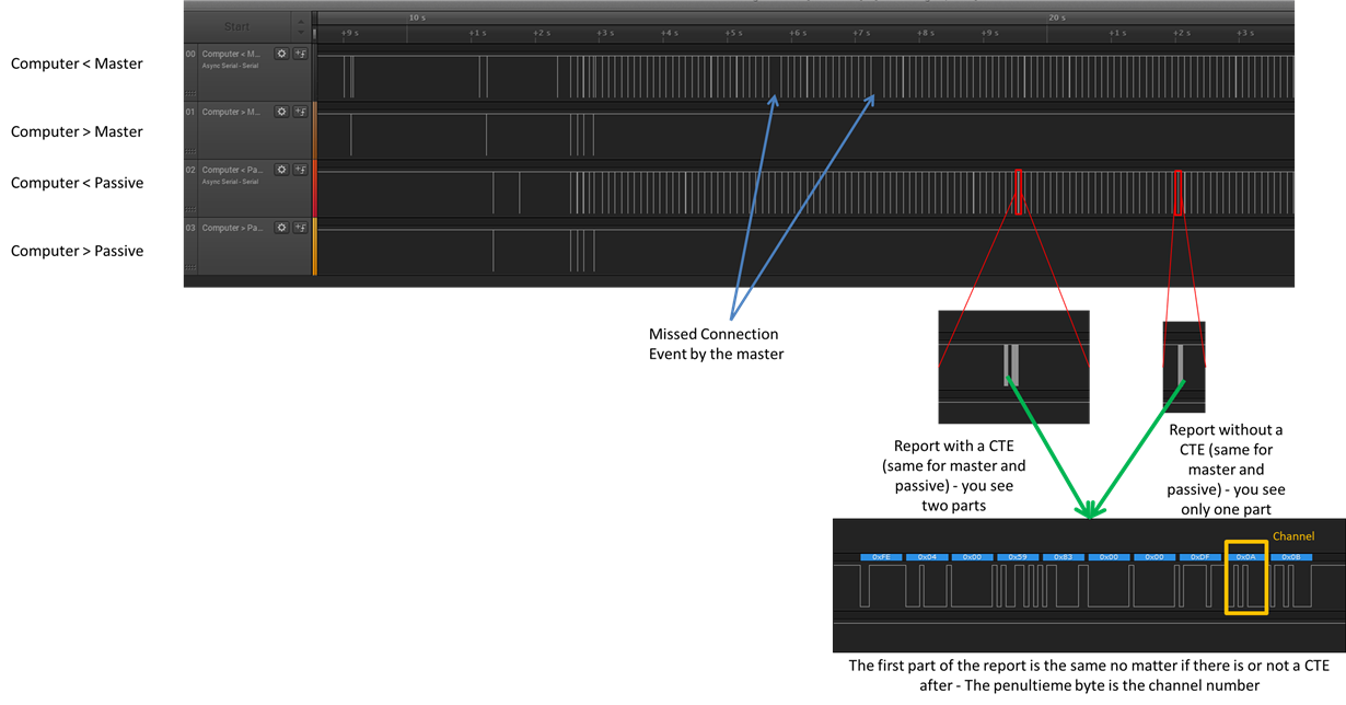

    Here is an image explaining how to read the channel number from the UART signals:

    Actually the two reports are made by the same API. The report without CTE are generated after a connection event where no CTE has been sampled.

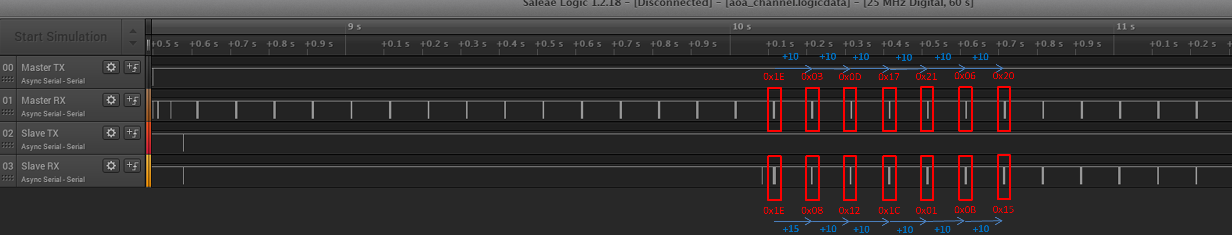

  • Do you have some logic analyzer traces of the UART communication you can share here?
      ==>No, i don't have logic analyzer, but Can you get the same channel from Master/Passive in your side? if yes, I will go to borrow one

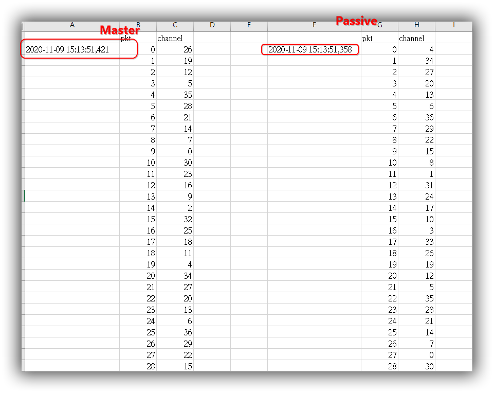

  • Hi Clément,
    below is our data type and channel num is byte 16
    21.52695 0xFE Start
    21.52696 0x8F Len
    21.52697 0x00 Len
    21.52698 0x59 NPI_ASYNC_RSP
    21.52699 0x24 RTLS_CMD_AOA_RESULT_RAW
    21.527 0x00 connHandle
    21.52701 0x00 connHandle
    21.52702 0x0E bd_addr
    21.52704 0xA9 bd_addr
    21.52705 0x6A bd_addr
    21.52706 0xD8 bd_addr
    21.52707 0x93 bd_addr
    21.52708 0x58 bd_addr
    21.52709 0xCE rssi
    21.5271 0x01 antenna
    21.52711 0x15 channel
    21.52712 0x00 offset
    21.52713 0x00 offset
    check the 2nd data of Passive
    aoa_channel.zip
  • Hi Valery,
    The traces you have provided seem different than the ones we can expect with the out-of-the-box software. The reports look longer and you seem to receive only connection events with a CTE.
    On the attached image, I have written the channels number stated in each report. It appears the very first one is identical (0x1E). Then the channel is incremented by 10 on the master side, while incremented by 15 on the passive side. After this, the increments seem to be correct i.e. the channel delta remains the same.
    I don't think the passive is listening on the wrong channel if not it would lose track of the connection after 30 events missed and would not report IQ data. I am rather considering an error in the channel reported. We could confirm this hypothesis by collecting at the same time the BLE traces and the UART traces (some Ellisys analyzers are able to do this).

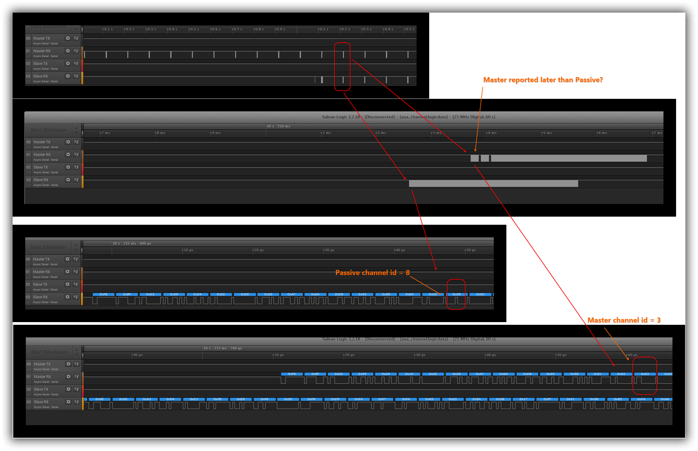

  • I think the mechanism of Passive finding Channel and reporting Channel is very strange
    Master frame #159 find invalid CRC and the time interval becomes 150ms
    Passive also hopping 150ms at the same time,
    Slave only sends one CTE packet at one channel, one time
    I think this means that Master/Passive is reporting the same CTE channel at the same time, but Passive's Channel ID is wrong
    The code of Passive seems to set the expected channel to BLE stack to catch the CTE and report IQ with this channel, so if the channel IQ report is wrong, it means the expected channel is wrong, but why BLE stack can catch CTE with wrong expected channel?
    How do BLE stack know the correct channel? if Yes, Why don't report correct channel to application layer like Master?
    P.S. I can reproduce this issue on TI EVB board and use original SDK4.3 without any change.  Did you can get the same channel at the same time for Master and Passive?

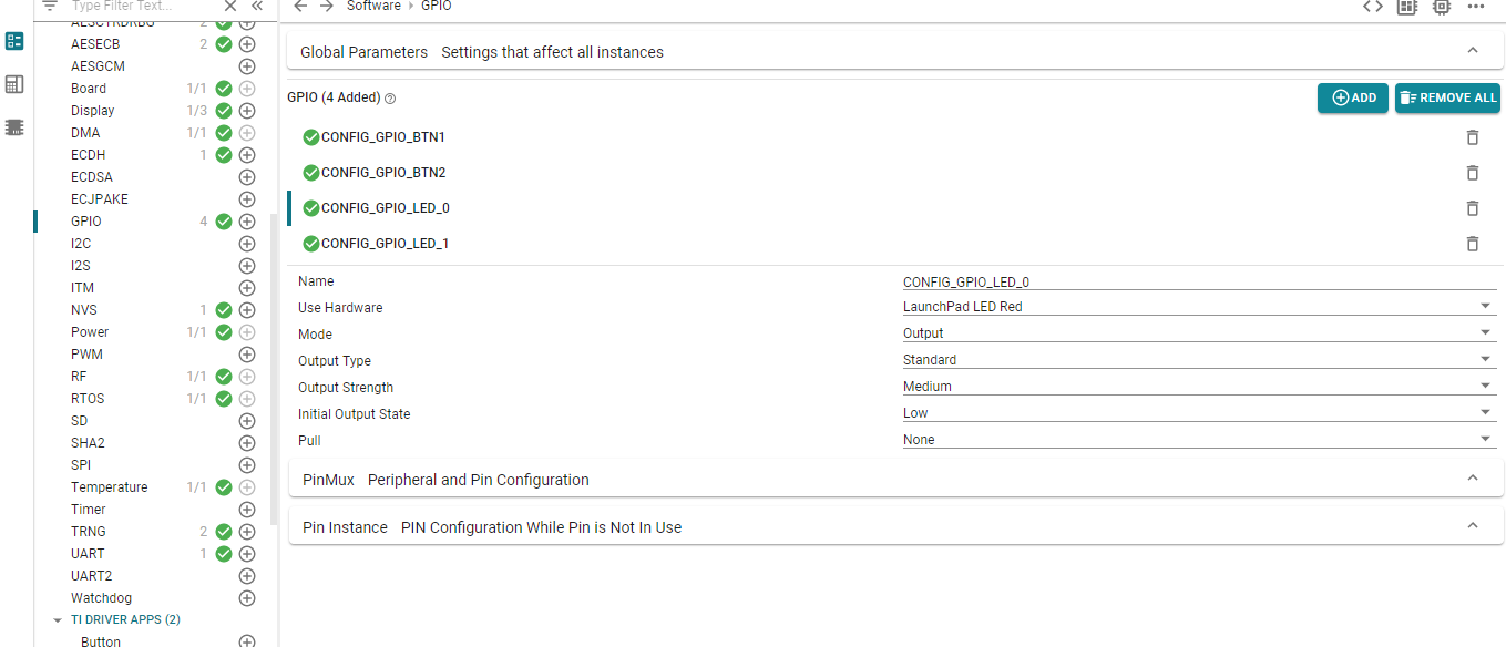

  • Hey Valery,
    You may be interesting to use some toggle some pins in the code to have a better picture of what is going on.
    I am currently doing this with the IOD6 and 7 (corresponding to the LEDs of the launchpad). Here how to proceed:
    - using SysConfig add support for one GPIO (and set it properly)
    - In main.c, in function main(), after PIN_init() call add the following:
      GPIO_setConfig(CONFIG_GPIO_LED_0, GPIO_CFG_OUT_STD | GPIO_CFG_OUT_LOW);
      GPIO_setConfig(CONFIG_GPIO_LED_1, GPIO_CFG_OUT_STD | GPIO_CFG_OUT_LOW);
    - You will require the following includes in main.c:
    #include <ti/drivers/GPIO.h>
    #include "ti_drivers_config.h"
    - in the file you want, add the proper includes (see previous step) and use the GPIO functions you want:
      GPIO_write(CONFIG_GPIO_LED_0, CONFIG_GPIO_LED_ON);
      GPIO_write(CONFIG_GPIO_LED_1, CONFIG_GPIO_LED_ON);
      GPIO_write(CONFIG_GPIO_LED_0, CONFIG_GPIO_LED_OFF);
      GPIO_write(CONFIG_GPIO_LED_1, CONFIG_GPIO_LED_OFF);
      GPIO_toggle(CONFIG_GPIO_LED_0);
      GPIO_toggle(CONFIG_GPIO_LED_1);
    I am currently using this technique in order to understand the issues we are working on.
