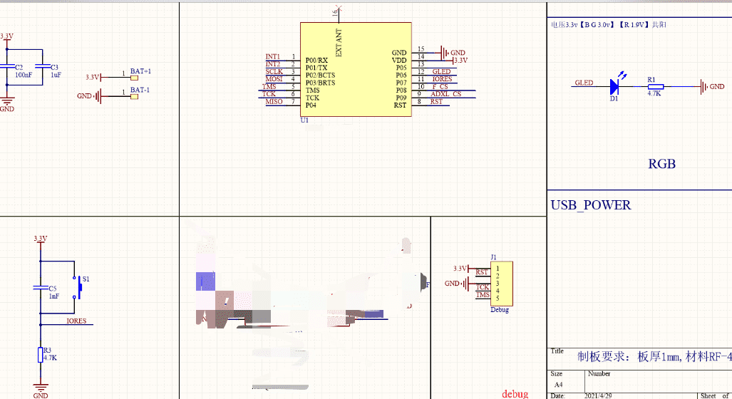

when I test on CC2640R2 board, works well, can adv,  app can scan/connect.

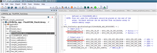

then I add CC2640R2DK_4XS macro definition, define one LED IO for my  CC2640R2FRSMR board.
I can scan and find it only in a few seconds after power on, can not connect. looks like adv stop and nothing more.

1,
static void SimplePeripheral_taskFxn(UArg a0, UArg a1) {
// Initialize application SimplePeripheral_init();
setIO(IOID_6, 1); here we can see LED on, so it can run to here
2,
// Create one-shot clock for internal periodic events.
Util_constructClock(&clkPeriodic, SimplePeripheral_clockHandler, SP_PERIODIC_EVT_PERIOD, 0, false, (UArg)&argPeriodic);
Util_startClock(&clkPeriodic);//I add this line to make it start immediately sure.
but
//in SimplePeripheral_processAppMsg
case SP_PERIODIC_EVT:
setIO(IOID_6,1); //this line not work as LED not on
and
static void SimplePeripheral_clockHandler(UArg arg) {
spClockEventData_t *pData = (spClockEventData_t *)arg;
if (pData->event == SP_PERIODIC_EVT) {
setIO(IOID_6, 1); //this line not work as LED not on
why? how to fix?
I want to make a periodic event and can run something periodicly, like make the LED blink.
