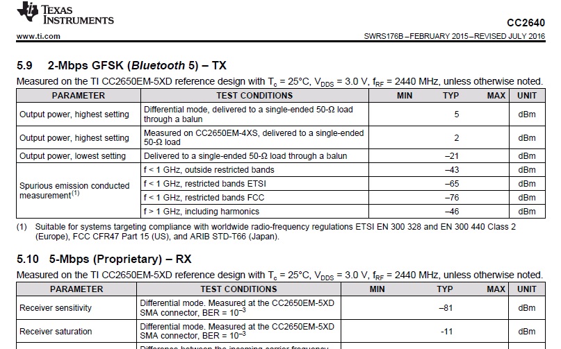

    I read the cc2640r2f datasheet and it does not have the rf relevant specification for the 5mbps. Instead, I found them from the cc2640 datasheet as below. Does the cc2640r2f share the same rf 5mbps specification as cc2640? and can I use the same 5mbps software settings of cc2640r2f that you provided me on the cc2640? Thanks.
  • The 5 Mbps performance would be the same on CC2640R2F as on C2640.
    The SW settings I provided can only be used on the CC2640R2F, not the CC2640.
