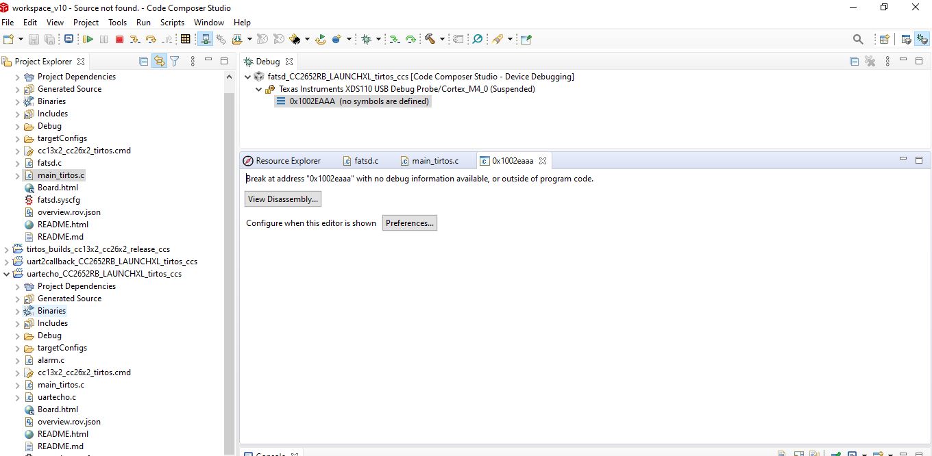

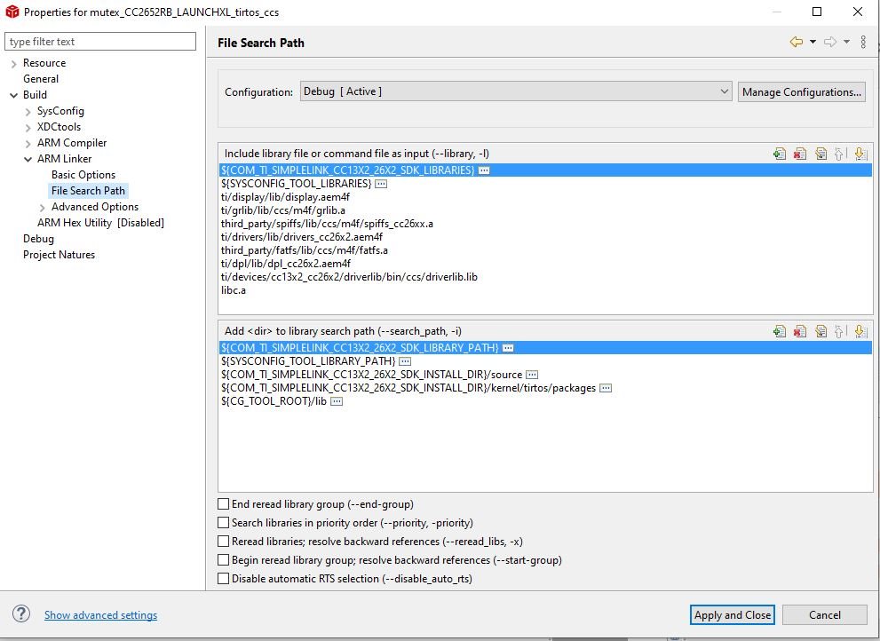

  • Thanks jenny, please refer the code and the errors i am getting below. I am using CCS  Version: 10.1.1.00004
    The errors and their lines in program are as below:
    "../mutex.c", line 233: warning #112-D: statement is unreachable         //  if (Semaphore_getCount(semHandle) == 0)
    "../mutex.c", line 310: error #20: identifier "CONFIG_SDFatFS_0" is undefined  // sdfatfsHandle = SDFatFS_open(CONFIG_SDFatFS_0, DRIVE_NUM);
    "../mutex.c", line 431: warning #121-D: return value type does not match the function type // return (NULL);
    "../mutex.c", line 432: warning #112 -D: statement is unreachable   //  if (Semaphore_getCount(semHandle) == 0)

  • Hey Shivam,
    Please use the Syntaxhighlighter tool when sharing code, it makes it much more easily readable for everyone viewing this forum. You can also consider uploading the code as a separate attachment. This again, will help the readability of the forums.
    This define is generated by the SysConfig tool in the provided example project. Since you are merging projects, I would right click on the .syscfg file in the fatsd project and open it as a text file. Then, copy over the relevant SD section and paste it into the target project's .syscfg file. This will ensure SysConfig generates the necessary files/defines with the SD module.
  • Thanks Ammar for your suggestions, when i am using the code in file you attached above i am still getting error - statement not reachable for " if (Semaphore_getCount(semHandle) == 0) " statement.
    How can i remove this error, am i right with my approach of merging the two codes of fatsd and uartecho for receiving data from atmega328 via uart and store the incoming data into an SD card.
    Let me know how to switch between two tasks that is recieve the incoming data and simulatneously store it and loop back.
    Thanks in advance.
  • As suggested by you when i am adding the code from fatsd sysconfig for SD section in the sysconfig of mutex example code i am still getting errors below:
    SyntaxError: Identifier 'SD' has already been declared
    at createScript (vm.js:80:10)
    at Object.runInThisContext (vm.js:139:10)
    at C:\ti\ccs1011\ccs\utils\sysconfig_1.6.0\dist\cli.js:23:95910
    at Object.o [as contextify] (C:\ti\ccs1011\ccs\utils\sysconfig_1.6.0\dist\cli.js:23:95960)
    at n.each.e (C:\ti\ccs1011\ccs\utils\sysconfig_1.6.0\dist\cli.js:33:336644)
    at Wt (C:\ti\ccs1011\ccs\utils\sysconfig_1.6.0\dist\cli.js:9:5239)
    at Function.zs (C:\ti\ccs1011\ccs\utils\sysconfig_1.6.0\dist\cli.js:9:40286)
    at Object.t.runScript (C:\ti\ccs1011\ccs\utils\sysconfig_1.6.0\dist\cli.js:33:336616)
    at <anonymous>
    Also the sysconfig of fatsd has declarations with "var" keyword whereas sysconfig of mutex example code has declarations with "const" keyword.
    at <anonymous>
  • Hey Shivam,
    We can change this using the SysConfig GUI editor instead too. Revert back to your original .syscfg on the UART example and open using the SysConfig editor.
    On the left, under TI Drivers, select the + button next to SD. This will add the SD driver as it's used in the fatsd example (although you will have to ensure your pin numbers are mapped accordingly, and modify to your setup). Once changed, you can compare the generated ti_drivers_config.c file to inspect the changes. You'll notice what was once CONFIG_SDFatFS_0 in the fatsd project, is now CONFIG_SD_0. You can either rename any calls in your code to this new name, or rename it in SysConfig so that it generates the name that matches the fatsd project (see the "Name" field in the sysconfig GUI).

  • Please go to Project Settings> Build> Arm Linker > File Search Path on the fatsd project and verify that fatfs.a file is included in the project. Usually, unresolved symbols are due to a missing linker include path for the modules listed.
  • Okay i will check but this error is coming in mutex code where i have put uart echo code and fatsd code in two tasks.
    Are you saying that i have to verify the fatfs.a file from fatsd code and put it in corresponding mutex code?
    shivam
  • I have verified both the fatsd and mutex code , i am also attaching the snapshot for them. As you can see that in both the images there is only one extra file in fatsd i.e. generated libraries that is 3rd last. shall i include this one or it auto generates?
    Now i have manually added the generated file into the file search path but still error is coming up for unresolved symbols.
    Please check.
  • Hey Shivam,
    I'm sorry you're having trouble here. There may be some issue with your project as the linker is not pulling in the library as necessary. You can try to Rebuild the project or start from a clean workspace.
    Here's a helpful guide on TI RTOS that will help you moving forward: https://dev.ti.com/tirex/explore/node?node=AJ5GKtlWu9o0mNaNx6ItPQ__pTTHBmu__LATEST

    I see you're using System_printf() to print to the Console. Take a look at this related post for use of System_printf(): https://e2e.ti.com/support/legacy_forums/embedded/starterware/f/790/p/625906/2307484#2307484
     Additionally, you'll have to make use of the debugger to investigate any potential issues with the code you run. Here's a general training on TI RTOS: https://training.ti.com/getting-started-ti-rtos-training-series . This is in addition to the previous link provided to our Simplelink Academy modules.

    However, when i am trying to debug my present code i am getting following messages on the screen. Please refer the attached images step by step with label Bios_start1, Bios_start2, Bios_start3 . The IDE is asking to change scalability settings when the debugger enters release_pem4f.c. Shall i change the settings, if yes to what.
    My final goal is to view line by line execution in mainthread function of the merged code attached above. I am not able to view line by line execution in my merged code.
    Shivam
