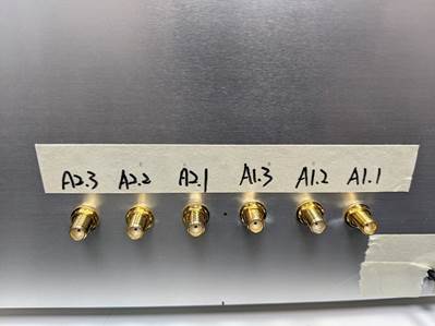

The BOOSTXL-AOA Evaluation board have Two antenna arrays with three 2.4 GHz dipole antennas on each, This mean that have 6 antenna connectors with SMA after re-work to conductive.
About above reason, I have some question as below:
1. According to the Bluetooth TEST SPEC, When need to perform the AoA Receiver test, All of the Antenna define on the Antenna need to connect to the RF Tester via combiner/splitter.
When we need to perform the AoA Receiver test, the correct connector method is?
(A) All of the antenna array(A1.1~ A1.3, A 2.1 ~ A2.3) total 6 connector, Connect to the RF Tester via combiner/splitter?
(B) Just choice one of antenna array in each side antenna(eg. A1.1 and A2.1) total 2 connector, Connect to the RF Tester via combiner/splitter?
(C) Another suggestion?
2. According to the Bluetooth TEST SPEC, The AoA Transmitter test is only using the single port that connects from EUT to the RF Tester.
But, There have a six SMA connector on the BOOSTXL-AOA EVB after re-work to conductive, which connector should connect to the RF-Tester?
    As a reminder, you don't need the BOOSTXL-AOA to transmit a CTE (that being said having the BOOSTXL-AOA does not prevent you to send the CTE). So you could remove the BOOSTXL-AOA and connect directly the tester to the JSC connector of the CC2642 launchpad. Another solution (especially if you don't want to touch the set up between the tests) is to identify which antenna is used to send out the CTE ([EDIT]: it should be the reference antenna). This is fairly easy to know, it directly depends on the state of the RF switches (which depends on the state of the DIOs 27, 28, 29 and 30 - see the truth table here). Last solution, keep the splitter. As a result the "addition" of the signals sent by all the antennas was arriving to the tester. (as only one antenna is sending out data, this is like having only one antenna connected).

    2. Now i have 3 solution for the AoA Transmitter test as below:
    (A). Remove the BOOSTXL-AOA and connect directly the tester to the JSC connector of the CC2642 launchpad.
    (B). Identify which antenna is used to send out the CTE (It should be the reference antenna). It depends on the state of the RF switches (Which depends on the state of the DIOs 27, 28, 29 and 30 - use truth table).
    (C). Keep the splitter. The "addition" of the signals sent by all the antennas was arriving to the tester. (as only one antenna is sending out data, this is like having only one antenna connected)
    I may select the (B) or (C) solution due to I cannot touch the setup between the tests.

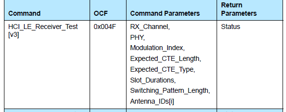

    4. Following the above question, When i perform the AoA Receiver Test use this config (BOOSTXL-AOA and LAUNCHXL-CC26X2R1) ,
    What command should I enter?
    Eg: 0x014F200B0001001400020400010000
    (Above command may have some issue, just a sample)
    (A) What value is suitable should fill in the field of "Expected CTE Length"?
    (B) According to the Bluetooth Core SPEC, If the DUT have 2 antennae,
    The test switching pattern should be "A0,A1,A0,A0",
    And Mandatory supported lengths of antenna switch pattern are "1 to 4"
    What value is suitable should fill in the both fields(Switching_Pattern_Length, Antenna_IDs[i])?

    yeh William said:
    4. Following the above question, When i perform the AoA Receiver Test use this config (BOOSTXL-AOA and LAUNCHXL-CC26X2R1) ,What command should I enter?
    It's a bit unclear to me why you are asking this question (the RF tester should send the HCI commands itself).
    Anyway, if you are using HCI commands, you don't need to specify the whole switching sequence. The sequence will be directly chosen by the device according to the number of antennae enabled.
    So if you want to use 4 antennas, you can use "00:01:02:03" as switching sequence parameter.

    yeh William said:
    I tried to connect every RF output form A1.1~A1.3 and A2.1~A2.3 after entering the HCI Command
    "LE Transmitter Test command [v1] and LE Transmitter Test command [V3]" to watch the output
    signal, I can watch about -13 dbm at every output port (A1.1~A1.3 and A2.1~A2.3).
    This is kind of unexpected. Could you please verify if the antennas are switching while you send the CTE? To do so, you need to attach a logic analyzer to the pins DIO27, DIO28, DIO29 an DIO30. I expect to not see any activity on these pins. (Note: this is for debug only, latter you won't need this logic analyzer)

    yeh William said:
    Due to having got different result (HCI Command) when my recent try 2 brand of Bluetooth RF tester (R&S and Anritsu), So I want to confirm the correctly HCI command and the suitable HCI command for the BOOSTXL-AOA and LAUNCHXL-CC26X2R1 use for the CTE TX/RX test and AoA Test.
    I confirm my previous answer, the antenna ids have to be specified only once. The device will then chose the proper switching sequence. That being said, the device should still use the proper sequence if you specify the full sequence.

    If it helps, here is a the small script I wrote while I answered your questions:
    Send_HCI_Reset
    Wait_HCI_Command_Complete_Reset_Event 5000, any, HCI_Reset, 0x00
    Send_HCI_LE_Set_Event_Mask 0xffffffffffffffff
    Wait_HCI_Command_Complete_LE_Set_Event_Mask_Event 5000, any, HCI_LE_Set_Event_Mask, 0x00
    #Read Antenna information
    Send_HCI_LE_ReadAntennaInformationCmd
    Wait_HCI_Command_Complete_LE_ReadAntennaInformationCmd_Event 5000, any, HCI_LE_ReadAntennaInformationCmd, 0x00, 0x04, Any, Any, Any
    # RX test - Need to receive a CTE to have switching occuring
    Send_HCI_LE_Enhanced_Cte_Receiver_Test 0x13, 0x01, 0x01, 20, 0x00, 0x02, "00:01:02:03"
    Wait_HCI_Command_Complete_LE_Enhanced_Cte_Receiver_Test_Event , any, HCI_LE_Enhanced_Cte_Receiver_Test, 0x00
    Please let me know if you encounter some difficulties with HCI tester.
