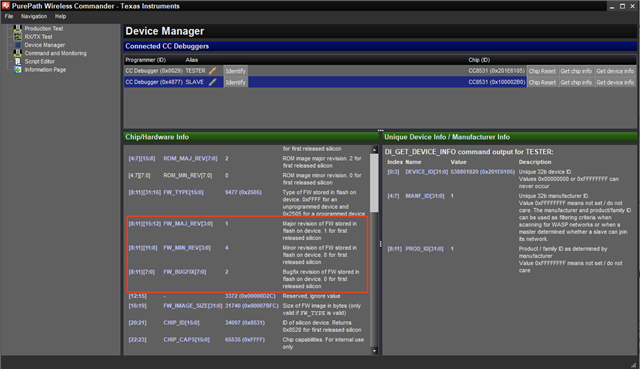

    Can you verify you have the FW version of your device using PPW Commander? (Device Manager > "Get Chip Info")

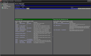

  • Daniel,
    thanks for your response. Attached are the FW version information, the receiver configuration and the .ppwadd model.
    I have excluded sample rate switching as much as I could, i.e. the transmitter sample rate is default 48kHz and never changed, also I reduced in a test both receiver and transmitter .ppwadd models to just this one sample rate so there is no other choice, but it made no difference. However, I can of course not be sure what the firmware does in ALONE state.
