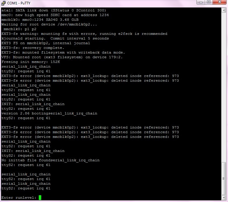

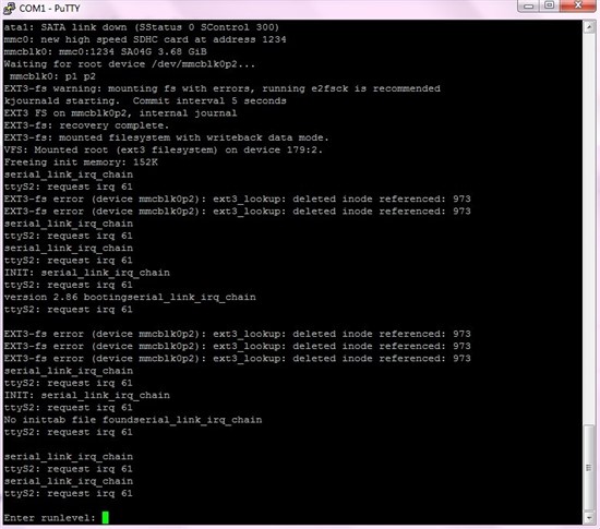

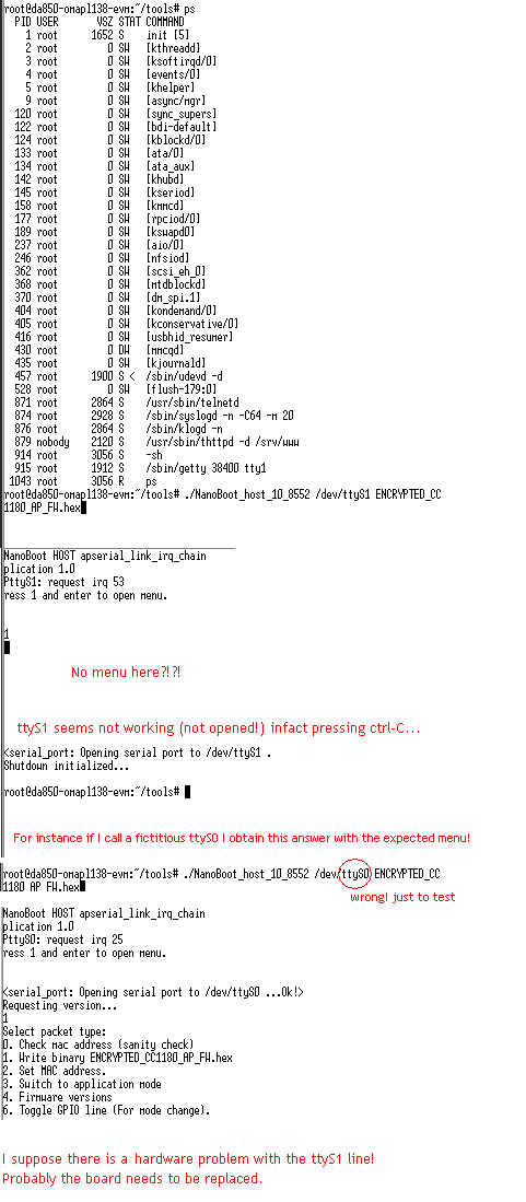

My customer bought recently the evaluation board of 6 lowpan
CC-6LOWPAN-DK-868
They have the problem with this evaluation board , the nodes do not connect with the router
In attached the documentation that the customer sended me.
