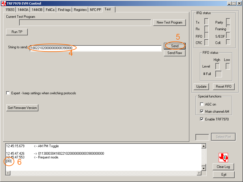

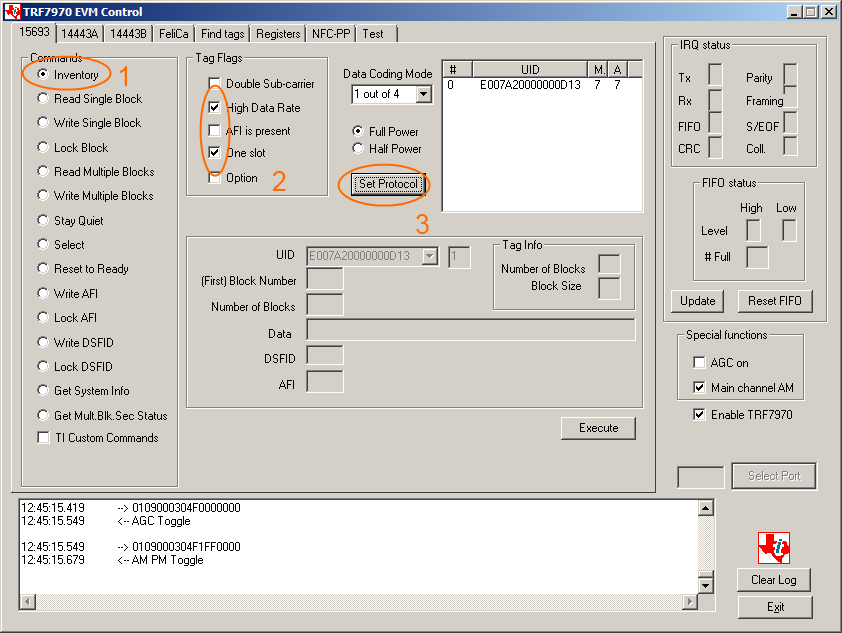

  • Couple of other things:
    1. Please double check the rest of your connections to the MSP-FET.
    2. What sensor patch are you using, is it your own developed one or did you get it from TI?
    3. I am supplying on how to cause the internal ROM code to enable JTAG functionality.  Generally this is not needed, but it may help.
    3a. Click on Inventory.
    3b. Click on High Data Rate
    3c. Clicking on One Slot is optional.
    3d. Click on Set Protocol.
    3e.  Do NOT click on Execute.
    3f. Enter this text in the text box: 180221020000000000390000
    3g. Click on Send.
    3h.  This should result in a [00] on the bottom text box.
    What this command did is it wrote block 2 with all zeros except on the 5th bit 0x39.  This is the JTAG Enable Password register.
    On reset this register is checked and if it is 0x39 JTAG functionality is configured for the JTAG pins.

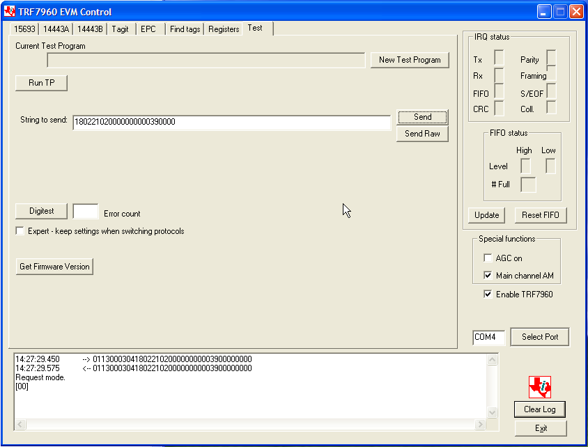

  • Hi Alexander, thanks for your help.
    Please find responses to your questions:
    1. Check Passed, all signals are well connected.
    2. I tried 2 patches from TI
    3. This section has been excecuted :
       RESULT: I get [00] as you expect:
    Here is the screen obtained with one of the patch. It seems to be OK?
    Regards.
