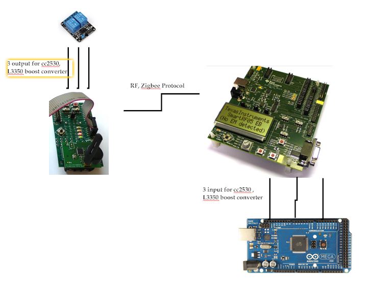

I have got cc2530 devolepment kits and battery boards .. I want to control a light .
I will send a command ardunio to cc2530 (evulation Module) with digital signal (3.3 V). then evulation Module send this command to battery board with RF and battery board will send digital signal relays, Finally relays control a light.
Summary; how can I manage digital input and output signal ? can you help me for codes
thank a lot.
If you want a quick and easy solution to this, without making a huge effort to study the internals of Z-stack, I would suggest you to download the CC2530-Software Examples (Rev. B) (which is simple and straight forward approach) or to try and get familiar with simpliciTI
IMHO Z-stack is an overkill for such a simple task
Ok. A pretty common setup. Zstack lihgt, as YK suggested before, should suit your need.
All I'm saying you don't have to use ZigBee for doing that, it's a bit overkill.
